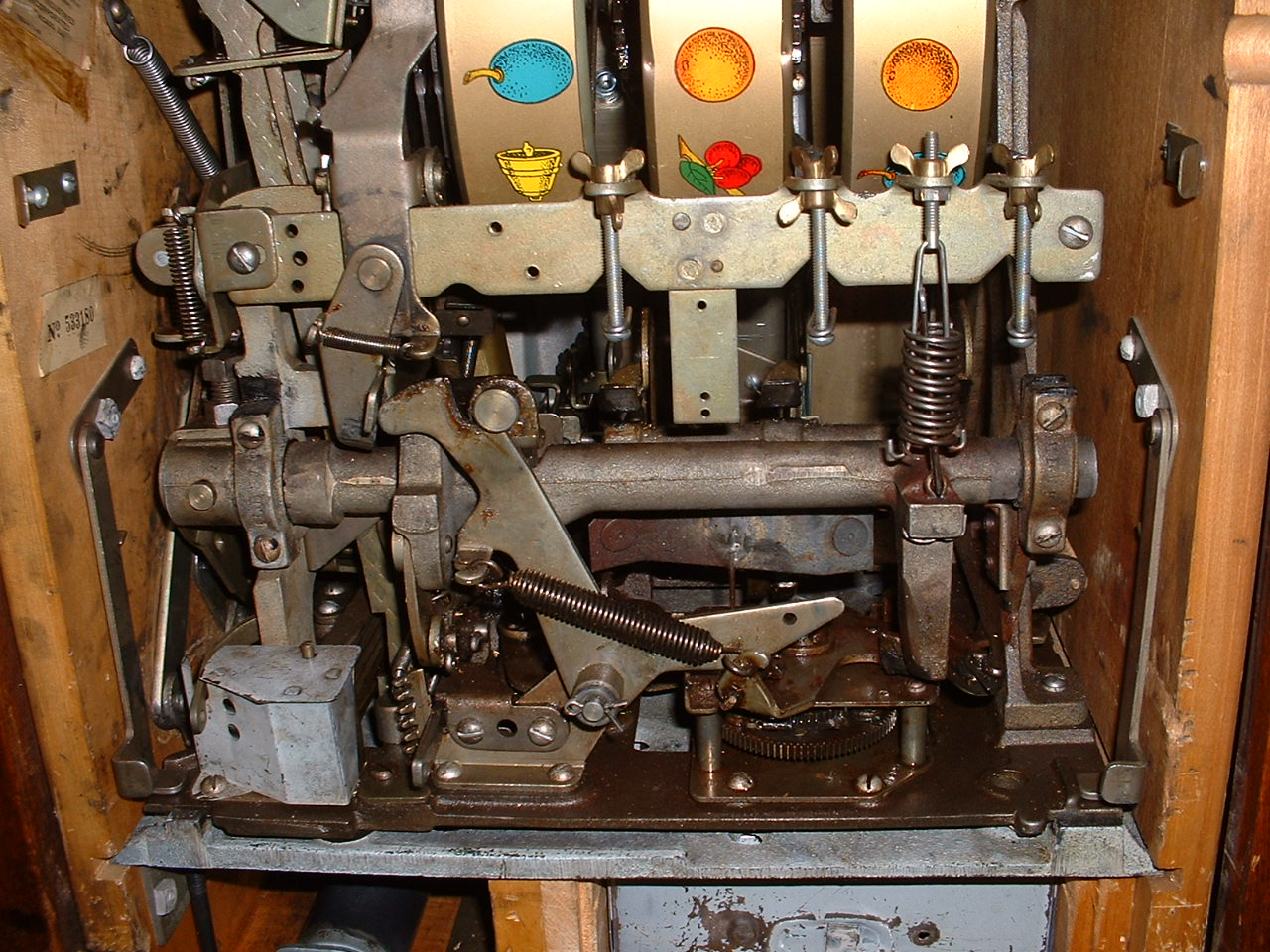

Got things up and running on a Mills Pageboy Console (you know, like an Extraordinary, but different) for a friend, and everything works nice... except the reel kick is annoyingly weak. Can somebody give me quick pointers on how to put more oomph into the kicker? I don't care to fiddle around with this one and try to figure it out for myself, especially since I can't even figure out why the mech won't kick the reels when I try to cycle it outside the cabinet (Put the mech back into the console and it launches, but the reels just don't spin very fast on the weak kick. The reels themselves can free-wheel around just fine and the brake wires are about as un-tensioned as they can be without falling off).

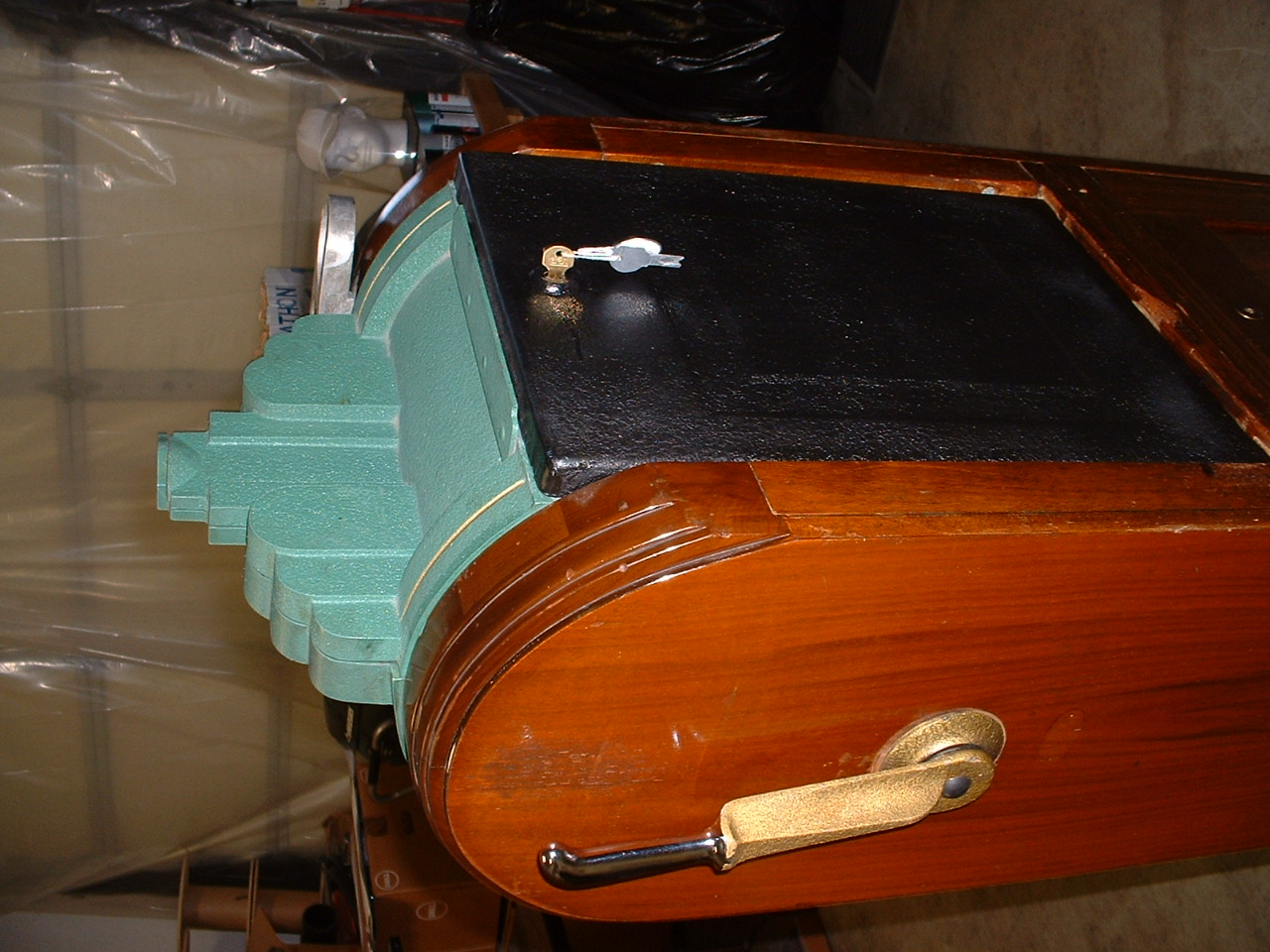

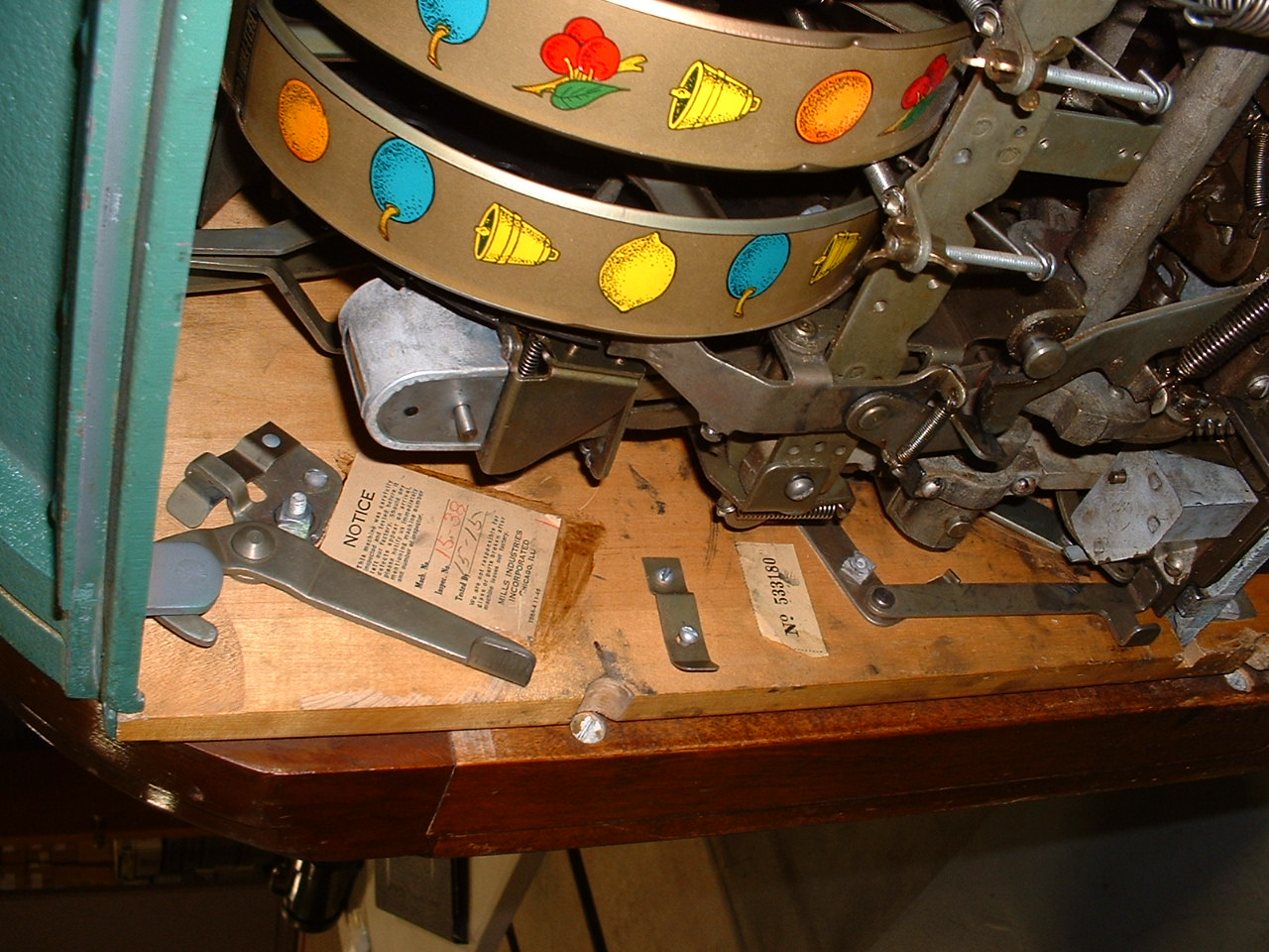

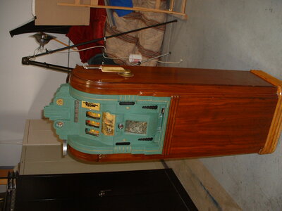

Thanks, Monti! A few images below for you. I figured if anybody could help, it'd be you... I half-expected you'd have an illustrated tutorial on adjusting reel kickers just for Mills consoles! :D
You imagine I already checked all of those common-sense items, but you imagine wrong! I couldn't even get a reel kick to occur outside the cabinet, and spent less than five minutes trying to figure out why. Then I thought, OK, better to get some advice from people who know what they're doing... I gather that there's no specific spring-tensioner adjustment to the reel kicker or anything like that. I got a PM from Watlingboy saying he might have some items I can check out, so I'll give him a call soon. I sure appreciate you telling me what the production date for this CRPB is, too; my friend asked me several times when it was made, and I just kept shrugging "how should I know?" Now I can tell him! Many thanks--

Marsonion, I couldn't tell if you have the large tension spring attached (that goes from the bracket the reel brakes are on to the Operating Fork). Looking from the back of the mechanism, it's between the first and second reel brake, if you count the reel brakes from right to left. If you're missing that big spring, the reels often don't kick off. If you need me to send a photo from one of my machines, please let me know.
Sal

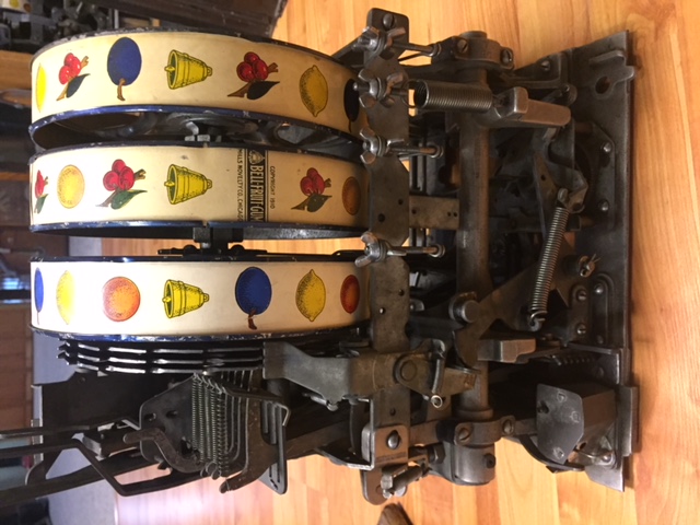

Postby mazzeosa17 » Sun Nov 21, 2021 3:53 pm
Here's a photo of the large tension spring I'm referring to from one of my Mills slot machines. It's between the first and second reel brake, if you count the reel brakes from right to left. It's got a bolt and two wing nuts attached on one end, with the other end attached to the Operating Fork Assembly.
Sal

Is that the strange, loosey-goosey-looking spring between the back bar and the brake-wire strip? I'll look into that-- thanks!

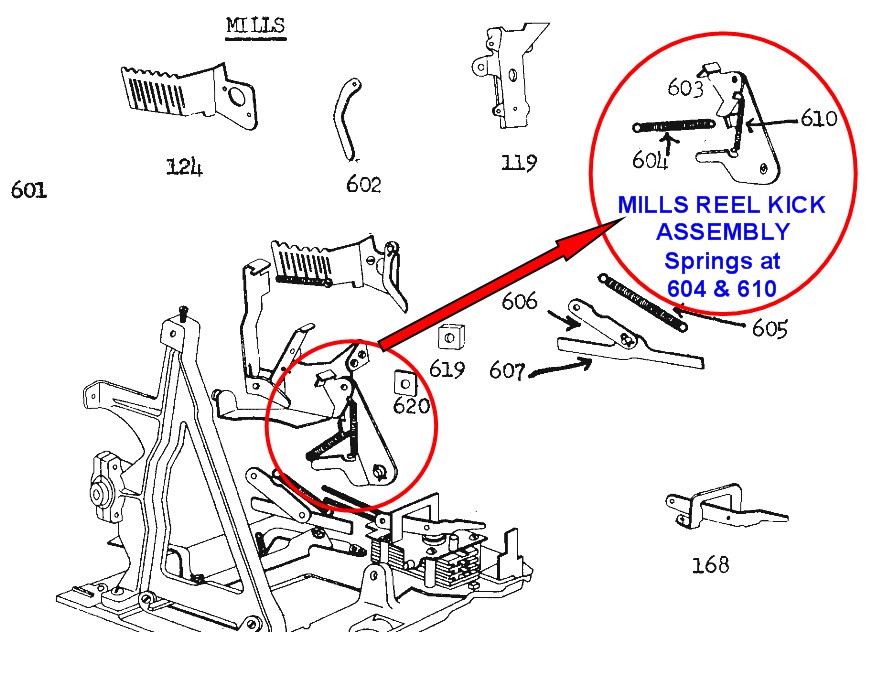

Nice machine, here is a blow up of the Mills reel kick assembly and springs thereon!
Blow up of Mills mech from our dear departed friend Tom Krahl's parts catalog!
Still miss speaking with him or Ralph!
Hope this helps!

mazzeosa17 wrote:Here's a photo of the large tension spring I'm referring to from one of my Mills slot machines. It's between the first and second reel brake, if you count the reel brakes from right to left. It's got a bolt and two wing nuts attached on one end, with the other end attached to the Operating Fork Assembly.
Sal
WOW did that make a difference! Thanks, Sal!
It looks like somebody, some time ago, for whatever reason, replaced that extension spring with a couple of compression springs, and used some funny bent wire hooks to make them act like extension springs. I found an adequate-looking extension spring and installed it in place of that mess, and... immediate rejuvenation ensued!
