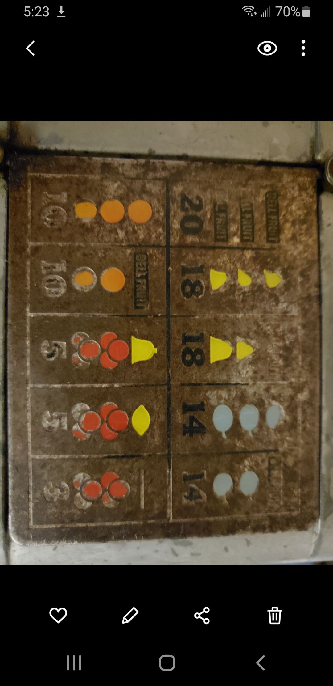

Finally, the award card's 'kinda' rusty. Do I sand with 200 grit and work out to 3 - 4 finer grits, polish and repaint or what're the options here?

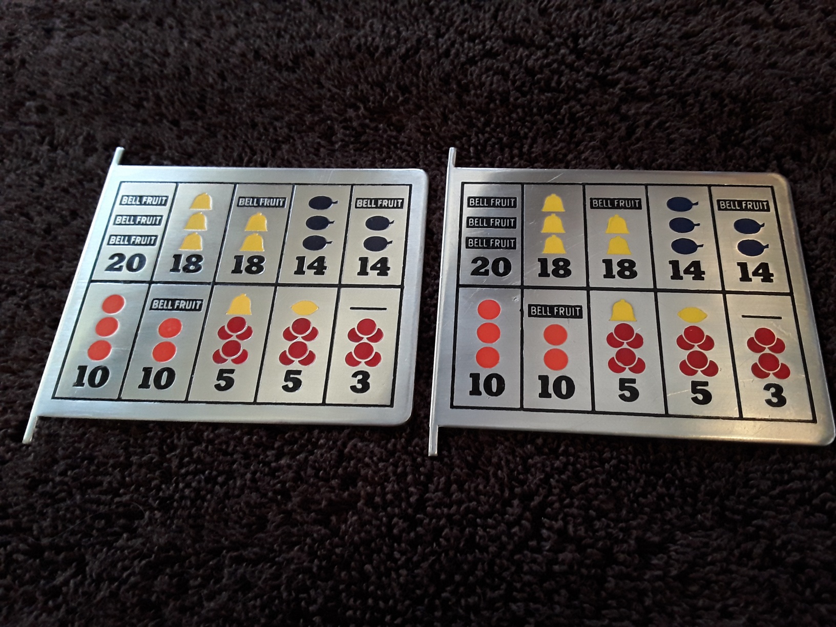

Welcome to the forum. In regard to your VP award card. If you can post a photo of it, I may be able to direct you. I have redone 6 or 7 of them. All of the ones I have done were nickel plated brass. So, you need to be careful if you plan to do any sanding. It can cause damage to the brass below and possibly loose definition on the stampings.

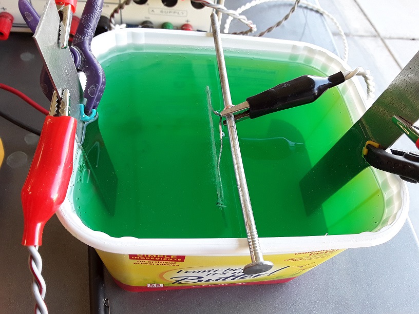

Some of the award cards just needed a good polishing and a couple I had to strip and do a DIY nickel plating to them. I have only seen one that was too corroded/pitted to redo. Below are two I did for a friend. Some of the scratched had to stay as they were too deep to repair. The last photo shows one in the DIY nickel solution.

My card is steel which shows the rust pretty well. Think I can sand enough and leave the incising intact?
