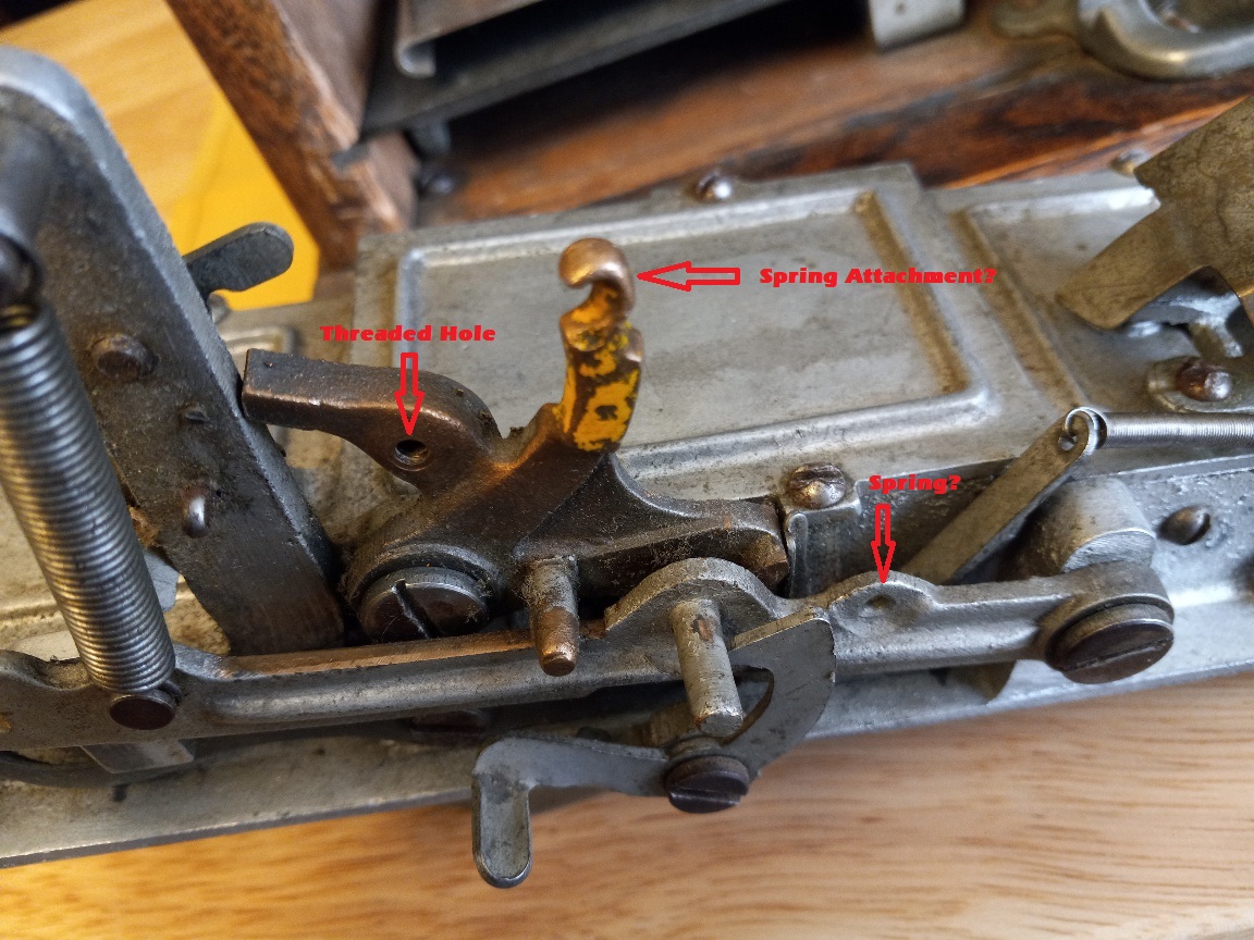

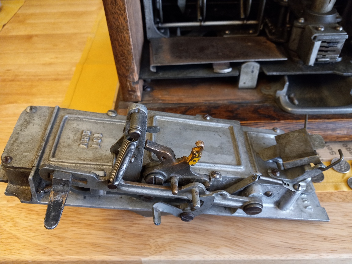

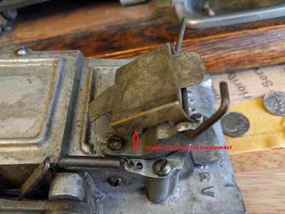

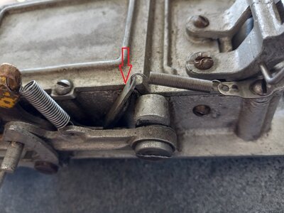

I have a Pace Bantam that someone wanted me to see if I could get the jackpot working properly. I believe it's missing a couple of parts as seen in the second photo. Also, I think the coin chute on the top is crushed and installed backward.
If someone could post a comparison photo showing the jackpot area in question it would be greatly appreciated.

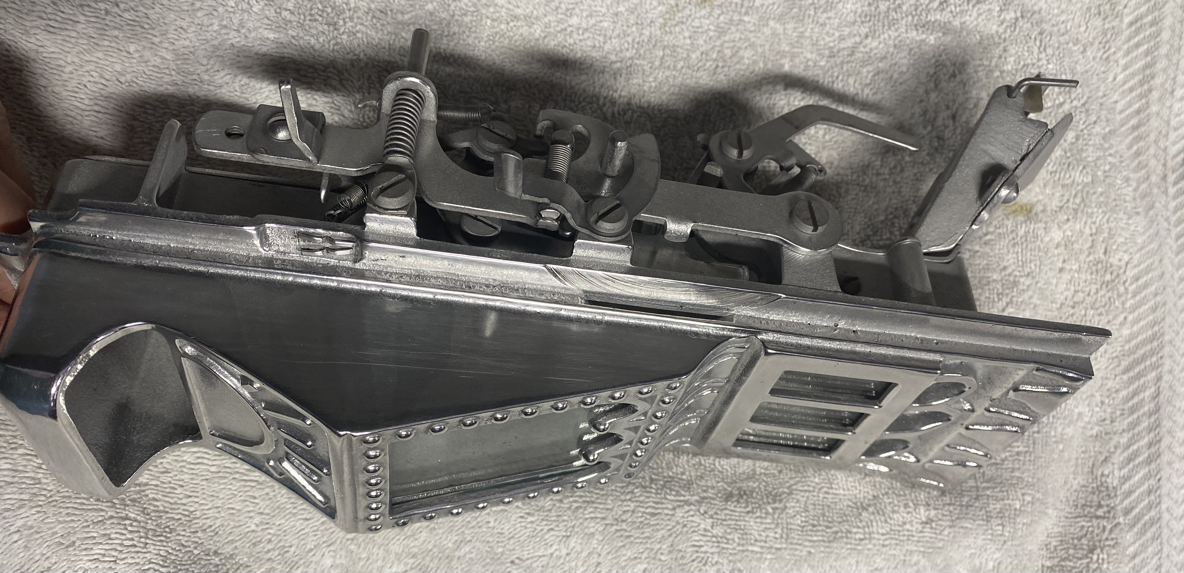

Postby 419Jim » Sun Feb 13, 2022 11:21 am
Pace bantam

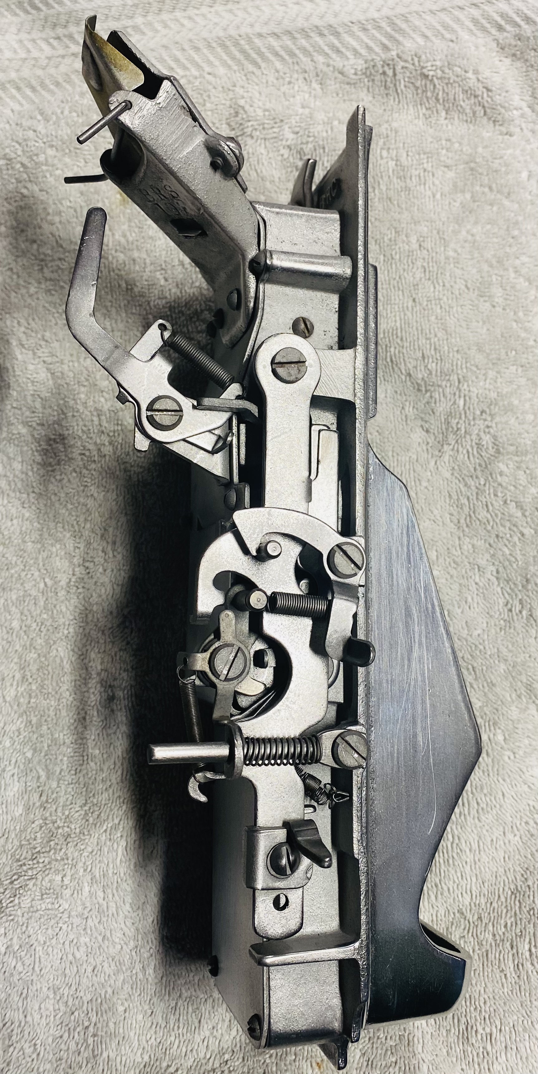

Postby 419Jim » Sun Feb 13, 2022 11:22 am
Pace bantam

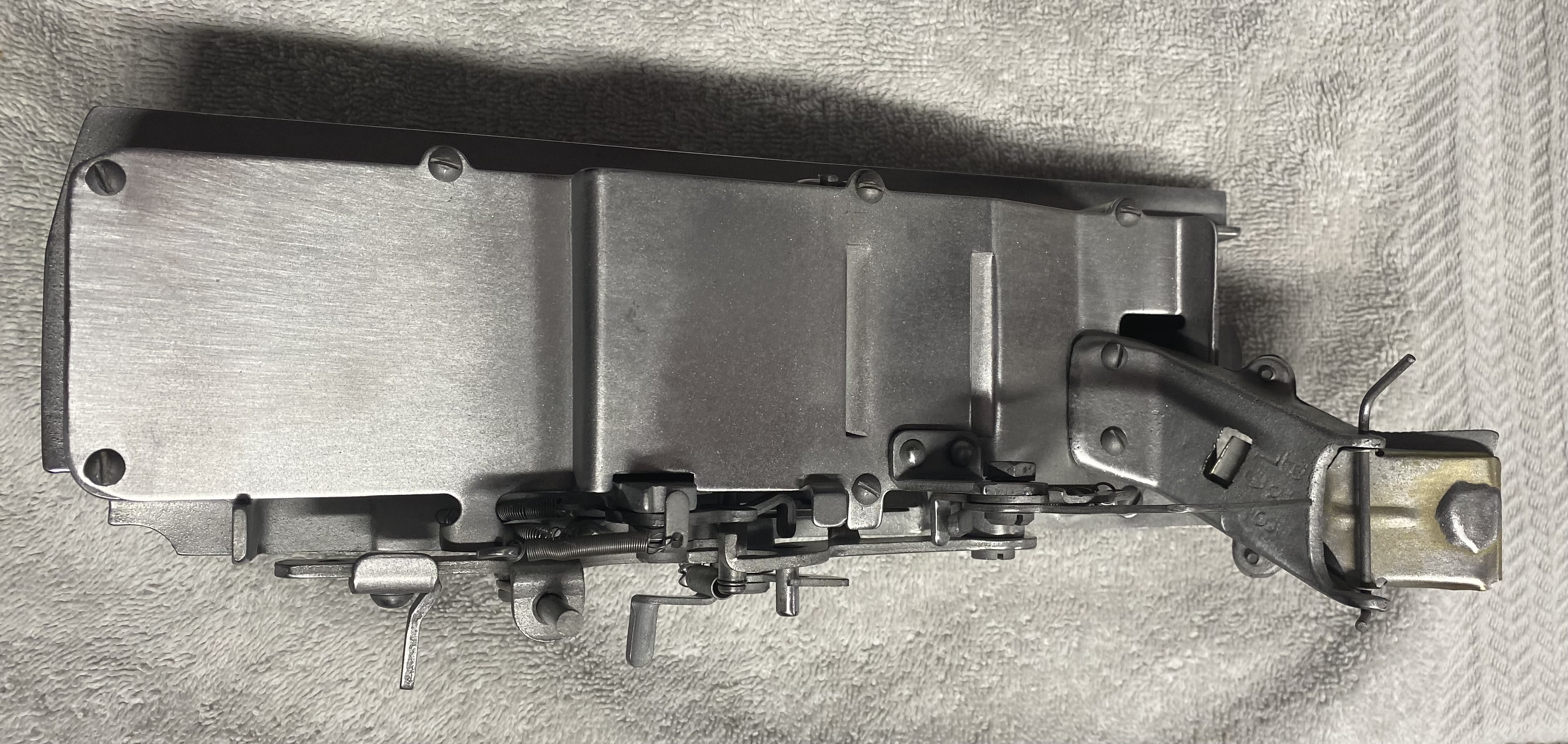

Re: Pace Bantam Jackpot Photos Needed
Postby 419Jim » Sun Feb 13, 2022 11:23 am
Pace bantam

Postby jmisatu » Sun Feb 13, 2022 12:43 pm
Very nice of you to post these excellent photos to help out the original poster. Thanks from all of us who may need something similar down the road.

Thanks for posting your photos. It appears that yours is a later model. It doesn't have the same upper coin chute and does not have the brass/bronze arm as shown in the original post. There is a threaded hole on this arm that appears to be missing a part or two. I am trying to identify those possible missing parts and a couple of spring mounting locations.

I have this mostly sorted out. The main jackpot opens fine and during it's reset it will then open the reserve properly and dump into the main. But, what resets the reserve to close? Below is a photo of it in the open position.
