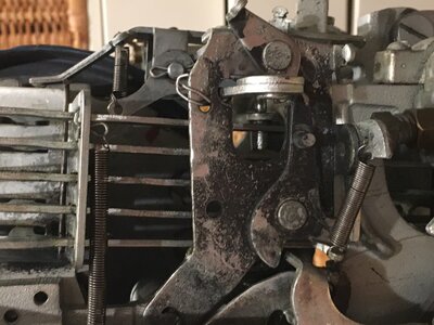

#1) The Main Operating Arm will often get stuck in the "down" position. There are no coins stuck in the mech. It just looks like there is something not 100% tight that is causing the operating arm dog to lock up. I can release it by working my screwdriver behind the Main Operating Arm spring to release it, like Dave Burritt shows in his video #2 on Youtube for unjamming a Mills mech https://www.youtube.com/watch?v=ZirU6dA25hQ, but it's not obvious what I'm moving when I have my screwdriver in there, since it looks like there is a slightly different Main Operating Arm than what Dave shows in his video. See the main operating arm spring and what little is visible behind it:
See where it sometimes gets stuck

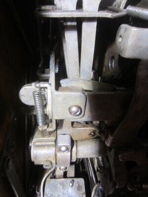

#3) The escalator looks to be operating correctly. The coins are moving across the escalator and are not binding. There is one thing I can't figure out.
This lever that is in the rectangular slot at the top part of the escalator is "sometimes" preventing coins from traveling down to the bottom of the escalator to allow the coin to be detected. It's called the Coin Holding Lever Assembly (MLB-3171-CSP) Is the issue related to the "gunk" on the escalator detection levers (check and coin) noted in #2 above? I see on a lot of machines in Youtube videos that this part is not there. The Geddes book says most "home use" machines have this part removed because it can cause playing issues. I guess I just have a more complete machine. I'd prefer to keep my machine "stock" if possible, but do want to have it operate reliably. Hopefully a good cleaning will resolve the issue. When I was able to play the machine a few times before it locked up, a coin did fall into the jackpot, so that was cool.

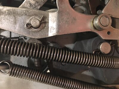

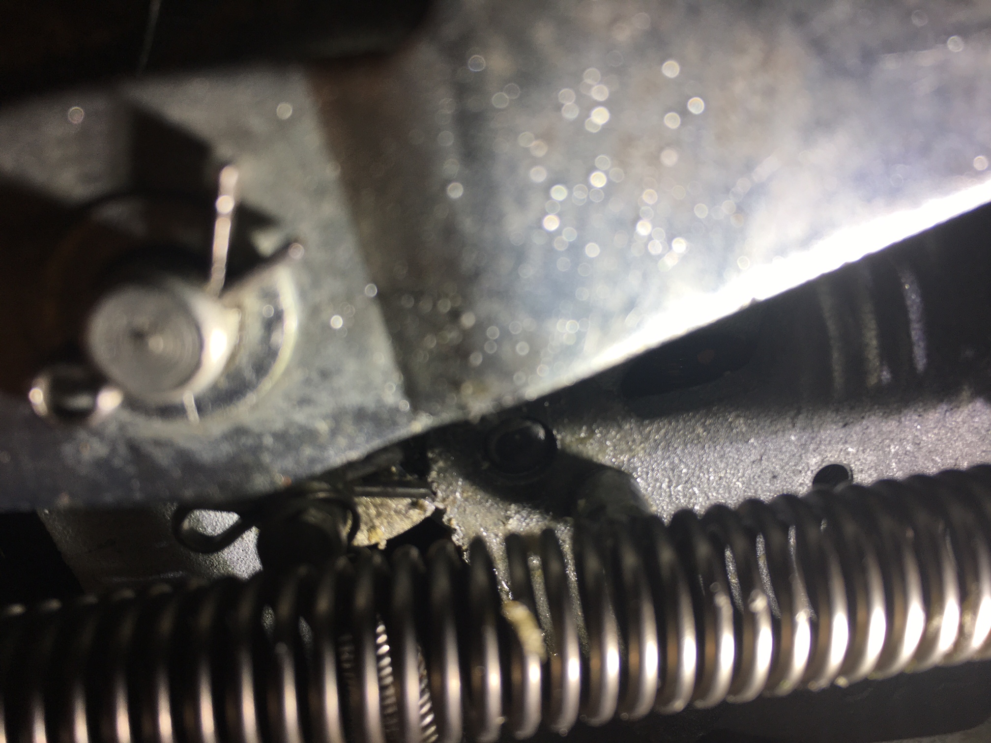

#4) This brings me to my next "what is going on here" question. See the image to understand what I'm talking about.
What is that "wire" doing in that hole? I also see quite a few spring connection points that don't seem to have a spring attached to them. Am I missing something here that might be the cause of my cycling problems? Close-up:

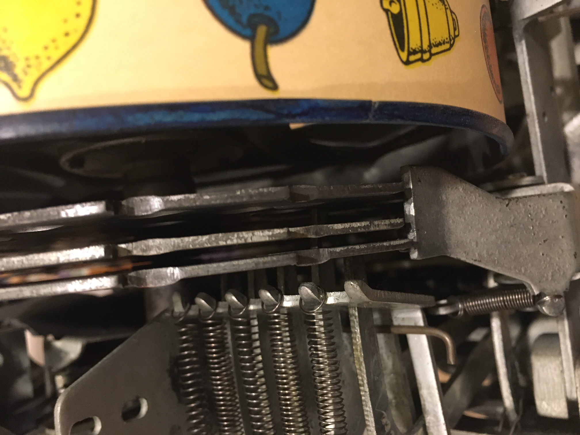

#5) The payout disc closest to the reels seems to be loose. It also looks like the gap between the discs is not consistent, which makes me wonder whether there are more loose things that I can't see.
Will this affect the operation of the mech? If/when the mech is disassembled, I would imagine that this problem can be addressed.

Hi and Welcome to the forum! Good Call on the Fey book which helped me greatly, Iam not any expert on these slots but maybe I can help with my experience so far on my Mills 5 cent castle
Question# 1 Look on Pg#45 lower bottom and check to see if OP fork pin is not loose and is adjusted correctly (2nd tooth)

#4 might be broken old spring but I will send you all my pictures after work to see if its missing springs to compare
#5 no issue looks normal and the same as my reel gaps

Bally Bill wrote:Hi and Welcome to the forum! Good Call on the Fey book which helped me greatly, I am not any expert on these slots but maybe I can help with my experience so far on my Mills 5 cent castle
I did not see anything on mine that was loose from Pg#45. In looking at your picture, there is quite a bit of a difference behind the main spring on mine. Again, I question whether the difference is from a slightly different vintage (Mills was always modifying/updating the mechanism) or whether it's related to my machine being a 50c. Your image looks a lot like the video I referenced in my post.

#3 No clue its missing on mine but check the spring if it has one
I await the extra photos
Yeah, More photos of machines will help a lot.
This is good to know.

Hi so when you play the machine it locks up in the down positions and then you have to remove the mechanism? regarding pictures let me know which angle/area you need, and I will remove the mechanism and take those photos. John only works out of his home, and he usually picks up the phone but he has health issues so try to schedule him in advance.

Bill, I haven't actually figured out what part I'm releasing when I unjam my machine. Because I can't see behind the main spring, I just kind of hold down the main operating arm (like Dave recommends in his video), then using my screwdriver, I kind of hunt and peck around behind the spring until the mech releases. CORRECTION: I just had a jam (or two) and I can now see the dog that is getting stuck. It looks like it's caught on the 2nd groove of the sprocket, whereas the photo from the Fey book shows it might/should be on the 1st groove. Also, if your question was about having to remove the mech from the cabinet when it locks up in order to free it, that is correct, but it will also lock up when sitting on my turntable and cycling it with my "big" screwdriver.
I guess the thing to try is to remove the main spring once the MOA is stuck and see if I can see what is really wrong. I just don't know if when I detach the spring whether holding the MOA down will still allow me to find the dog that is stuck and then allow it to release.
As far as other things you can help with... if you can take a picture of the area on your castle front below the payout fingers where I posted a photo of that "wire". A side view and a front view would be great. That would show me any attached springs and their attachment points.
You also asked about the lever on the escalator (which is not on your machine). There is a small spring that you can see in the attached photo.

That small lever on the escalator prevents more that one coin from being inserted by holding back any additional coin about halfway into the coin opening. It is rather fragile and can be damaged and problematic so many are removed. It works well if nobody tries to force a coin past it. The lever retracts as the arm is pulled and the fully accepted coin enters the escalator to allow the waiting coin to enter.

I had the same jamming issue on my 10 cent castle after about a month of ownership and the Operating fork pin was loose and not set in the correct position. I would measure or take picture of the pins location and loosen the jam nut and adjust it back or forward in small increments and cycle the mechanism until it cycles jam free.
