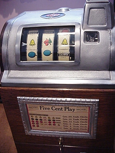

I bead blast the metal and then buff wheel the high spots and then repaint the metal cabinet. Here is one that I did.
Posts: 576
Re: Another newbie question
Postby Obsolete Candy » Wed Sep 27, 2023 6:06 pm
radiorich123 wrote:I bead blast the metal and then buff wheel the high spots and then repaint the metal cabinet. Here is one that I did.
That looks awesome! Since I do not have the equipment for blasting do you know of any other alternatives? I have bead blasted before and the project turned out great but it was at a friends place a couple of states away.
