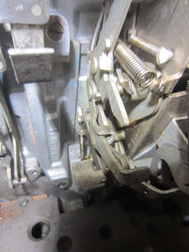

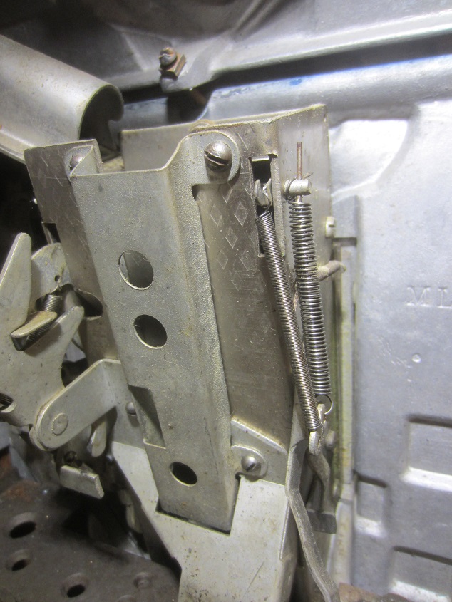

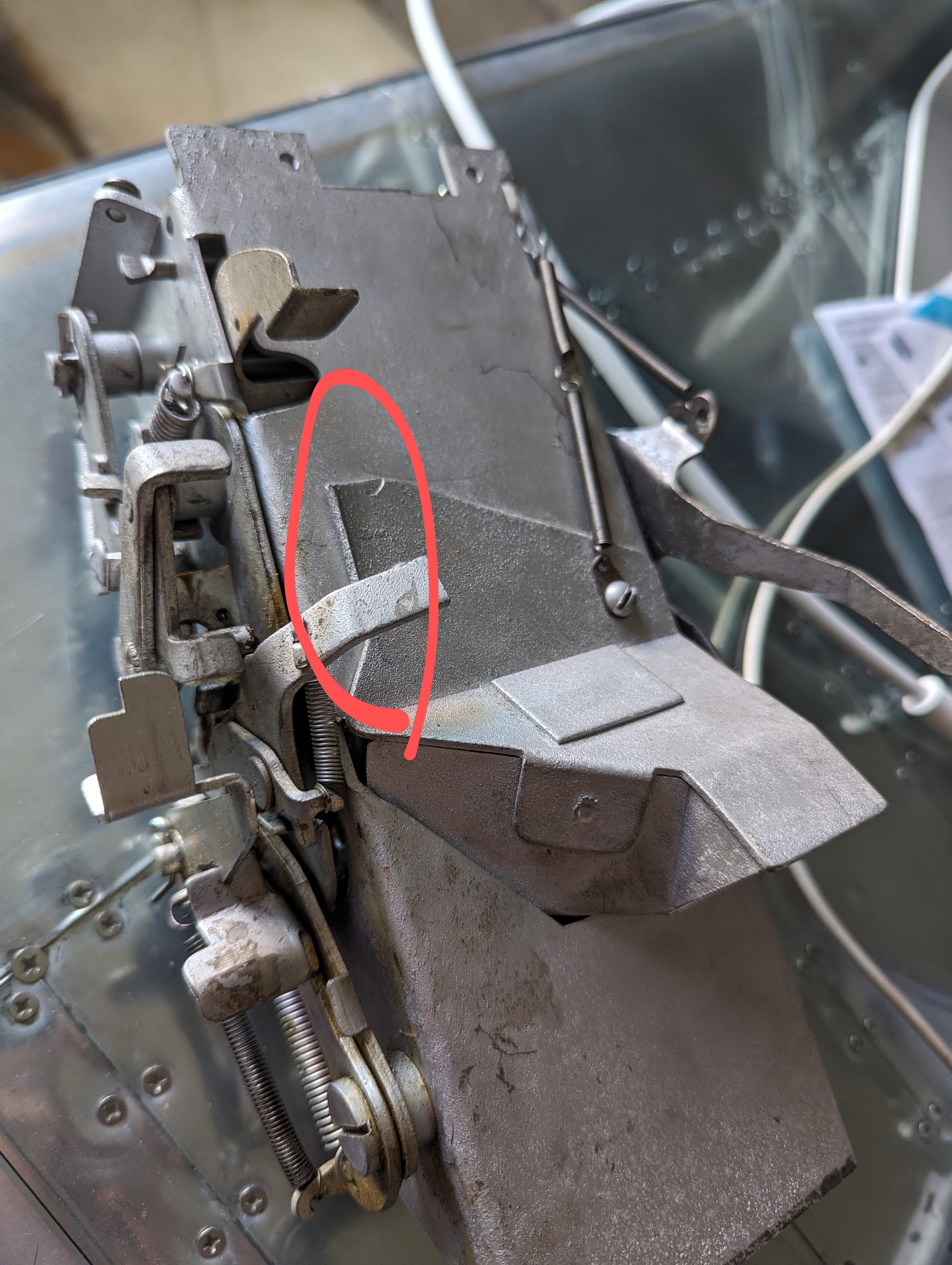

Postby TJF » Sat Feb 10, 2024 2:24 pm
oldslotman wrote:Take the front casting off. When you replace the jackpot there is one lever that has to be in the correct position for the jackpot reserve to work.
I managed to get it out, and I'm guessing the lever you refer to is what's referenced here in this video https://www.youtube.com/watch?v=dA8QUP2T57E
However, mine appears to have a piece broken off. (to be clear, I'm referring to the vertical part in the background of the circle where it appears something cracked off) What is this part, how necessary is it, and can I get just this piece? :-(. Also, that spring on the right appears to be two springs connected together. I'm guessing that's not right either.
Thanks

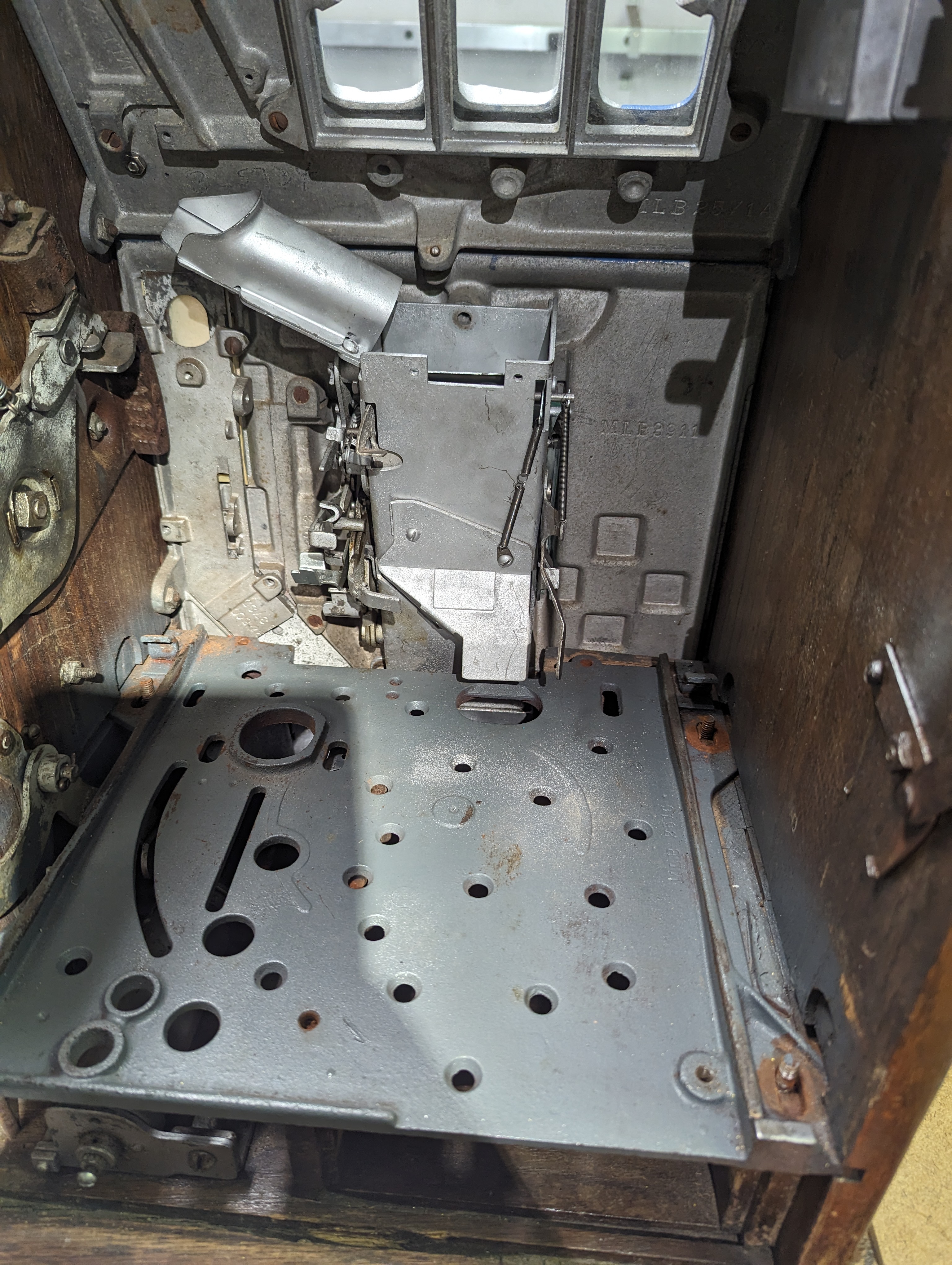

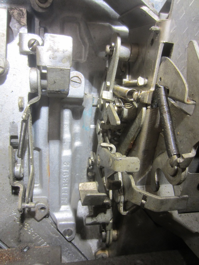

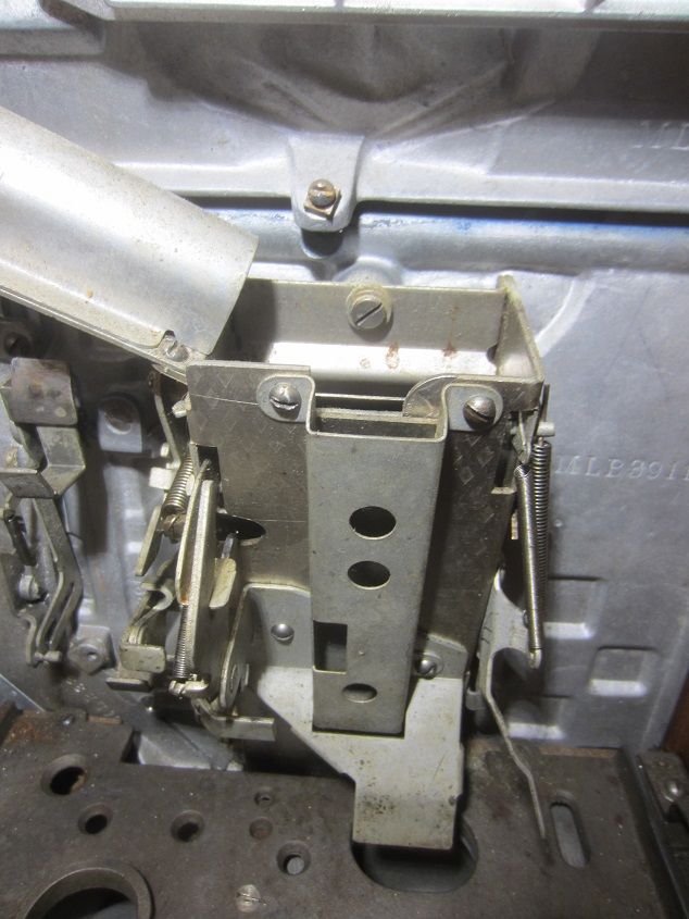

Postby Bally Bill » Mon Feb 12, 2024 4:55 pm
Hello and Welcome to the forum, Here some pictures of my castle front jackpot and a reference page to help you along.
