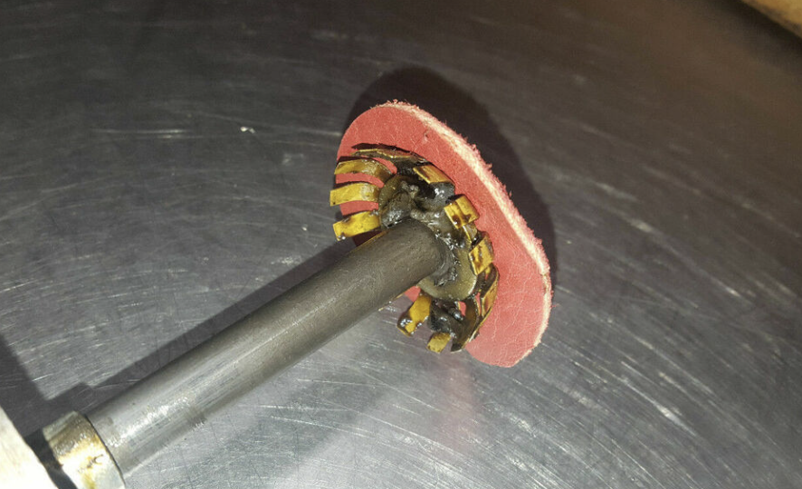

Could this be the issue? I found a picture (below) of a pump assembly and it appears to have a spring-like washer (yellow thing) on the inside. Mine just has a regular flat washer -- as in, the leather washer is sandwiched between two 'regular' fender-style washers.

That springy like washer is a guide to maintain somewhat the edge bent over shape of the leather as it is moved in and out as the handle is pulled and released. The outer edge of the leather wraps over the profile of those strips if metal. Some of the leather pieces available have the cupping shape formed when you get it and that makes it easier to control. I would say that fluted part is definitely necessary to function properly.

Yes that is your problem. Look for a car wheel cylinder piston rubber cup. Must fit loose not too tight.
