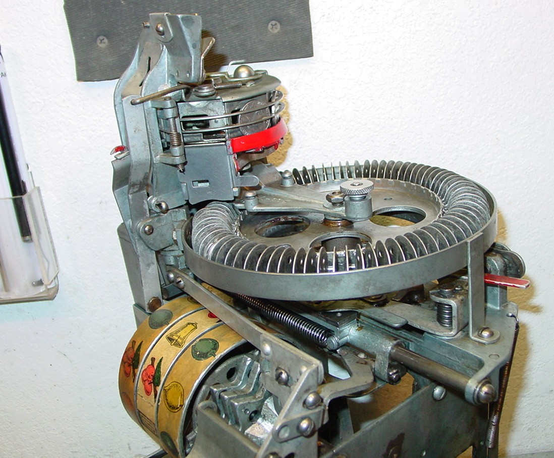

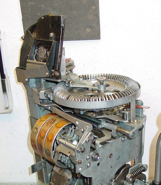

Granted the coinhead was either a "straight drop" design as shown below or a "circular head" design also shown below but I believe the internal main portion of the mech was very similar in all the models with the exception of the Columbia Chrome Bell which was a larger version of a similar mechanism!
Straight Drop Coin Head
Circular Coin Head
