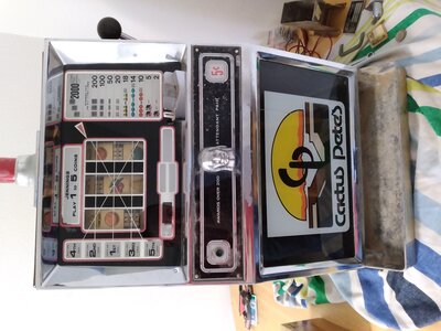

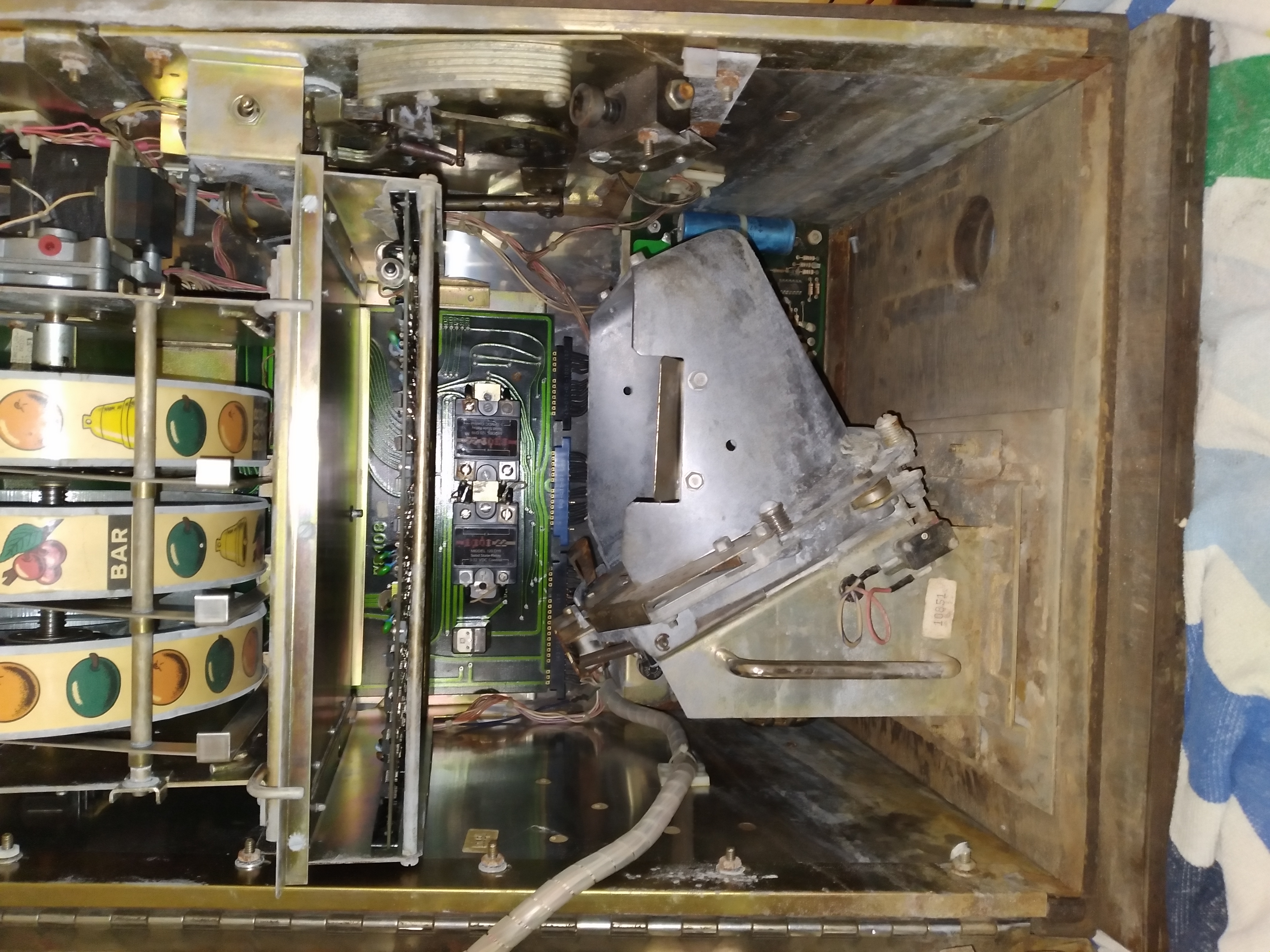

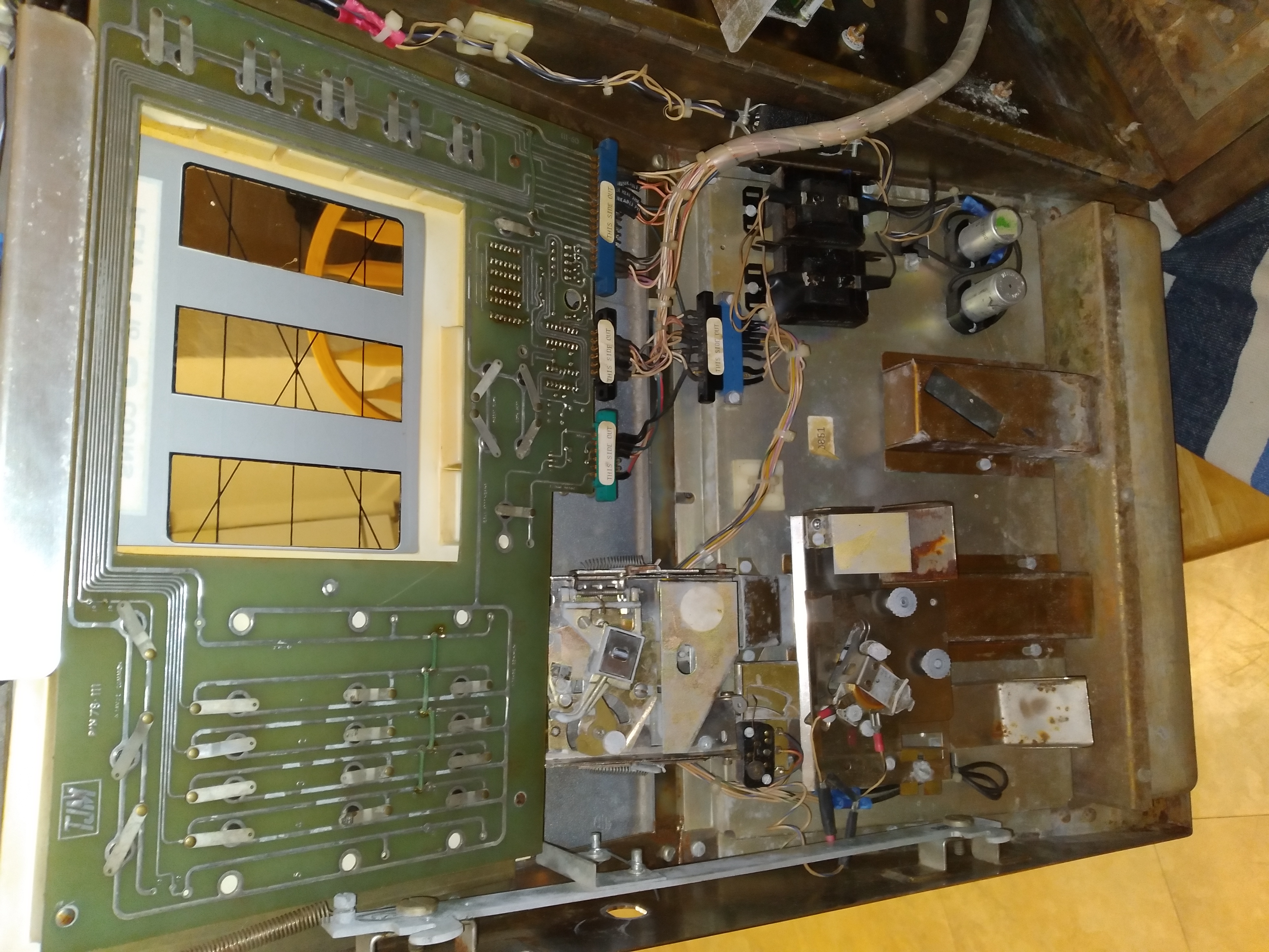

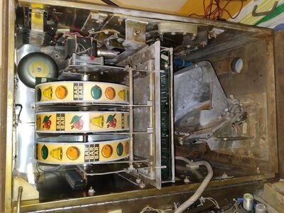

I recently acquired this 1977 Jennings machine for a restoration project, I've done arcade and pinball in the past. It is a little crusty from being out in the Nevada desert. I'm fortunate to work for an electronics manufacturer, I plan on using our PCB safe vapor degreaser for the boards and some of the assemblies.

Jennings 400s are problematic. The original NICAD battery on the logic board will leak, and acid damage will leach into the circuitry, under the ICs and in the solder joints near the battery. Corrosion is a real problem with this design.
The logic board was pre-microprocessor, so there is a blend of early CMOS and TTL on the board. The factory jumpers and modified traces are there for different games as they used basically one logic board for several games. The edge connector at the back of the board rack should be looked at - alignment of the board to the edge connectors can fail and give you fits.
The power supply is a monster analog supply that will frequently give you low voltage problems. Check those voltages. I have dozens of them rebuilt on the shelf if you need one.
I had 30 of those machines that I sold to a movie production company who used them for props, and have rebuilt several of the 400s and 700s over the years. Lots of work to get them going, but once they work, they are consistent.
They didn't use polished aluminum on the interior of those machines, just cad plating, so no doubt the plating is gone on the base. Sand blast it and rattle-can the parts to restore.

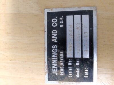

Thanks, I'll see if mine is still alive. In your research have you ever seen a model decoder from Jennings? Mine is a 1100 even though it looks exactly like a 400. What years are yours?
