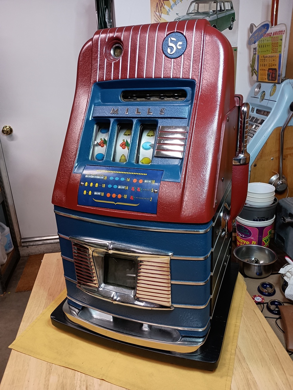

Also, as a side note. Your machine has the incorrect handle. The one that is on it is the "sword" type which was used on earlier machines.
Attached is one I re-did for a friend.

Thanks for the info. That machine looks amazing. You think what I have has to potential to look like you refurb? I would mainly like to get it working first. Is there a way to pull the mechanics out of the machine to work on it?

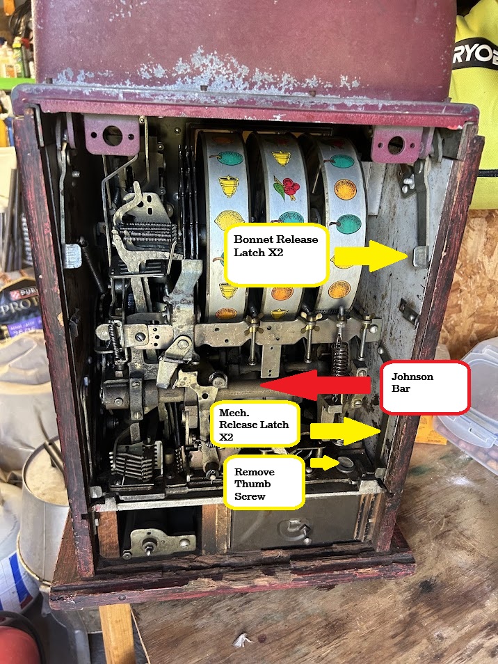

Postby 63mini » Mon Oct 27, 2025 6:15 am
offline_mail wrote:63mini,
Yes, your machine has the potential. It just takes time and determination.
To remove the mech., I have attached a photo.
1. Remove the bonnet using the two bonnet latches on the L/R sides. They lift up to unhook the bonnet. Then you can remove the bonnet with a slight lift on the rear and slide it out.
2. Remove the single thumb screw holding the mech to the base plate.
3. Swing the Mech retaining latched up. They should latch into the small tabs on the cabinet above the latches.
4. On the mech you can grab the Johnson bar and gently lift and slide the mech rearward. As mentioned before, be careful as the mech. is fairly heavy.
To replace the mech just reverse the above procedure and be careful not to force or slam the mech into position as you could damage the jackpot.
