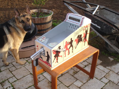

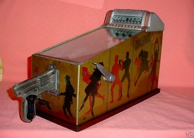

Here is a pic of a totally original, early model "Challenger", with the low head-casting.
Hope this helps.

Here is a pic of another original, with the higher head-casting. I don't particularly care
for the all-red paint theme, but I have seen them in other colors as well.

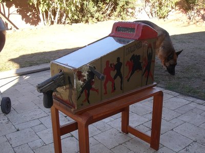

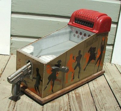

I just recently redid one I bought at a flea market. The graphics and shell on the original were damaged beyond repair. I hired a graphic artist to reproduce the graphics, then had vinyl reproductions made. I still have the graphics files is someone is interested. Just PM me. While my "Reproduction" is not as nice as the original, I saved all the original parts, and was able to put together a halfway decent reproduction. Crow River is a great place for parts.
Challenger when I bought it....
My Reproduction job....

pb4sc wrote:Hi,
I don't know why you are Poo-Pooing your job on the reproduction graphics. I think they turned out great,
and would graciously pay for a set, if I ever need them. You should list them here on the Forum, as I am
sure there are several of our members that need them.
