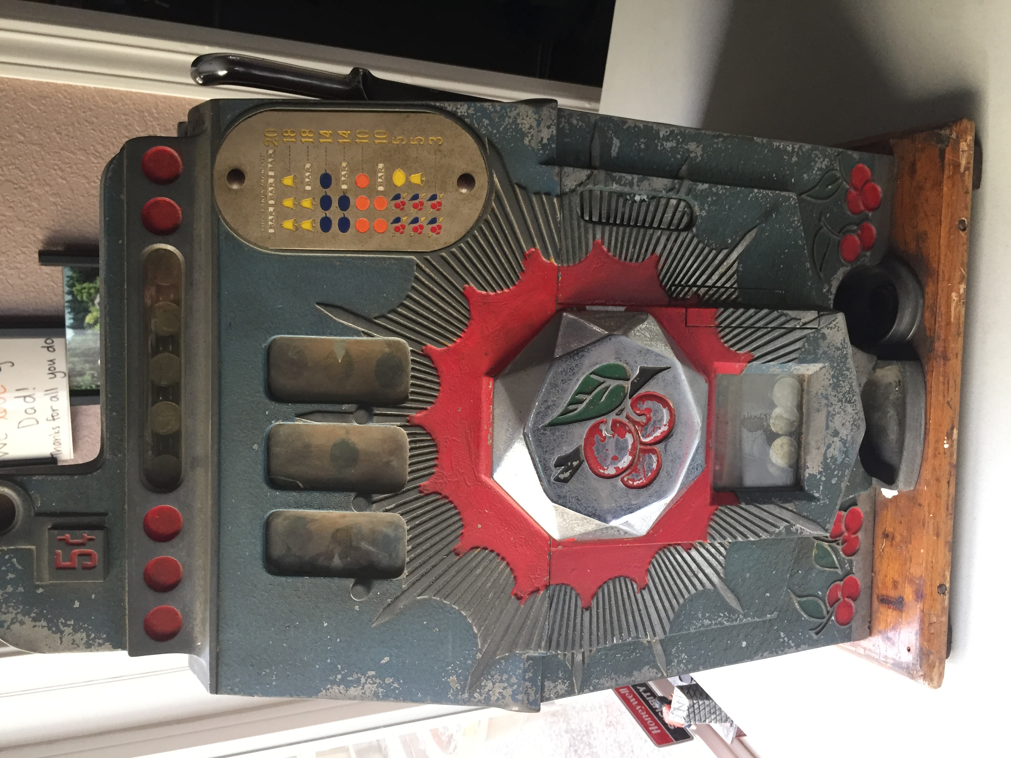

Preparing to paint my Bursting Cherry machine. You see these online in every color under the rainbow. What colors did these come from the factory? I think the base on mine was original though it is so old and dirty it is hard to identify it’s true color and sheen. Would love to see some pics of original color combos.

However, from the single photo of your machine, it appears to me that you have dark blue original paint and may not have a Cherry Bell, you may have a Brown Front that was revamped by Mills during the war and painted blue; Mills called it, of all things, the Brown Front Blue!
Recommend you search this site and others on how to tell the difference between a Cherry Bell and a Brown Front (and a Melon Bell) and go from there.

nvmos2 - Good info - much of it I did not know.
Besides the color, what is the difference between a Cherry Bell and a Brown Front?
What makes you think my is a Brown Front Bell and not a Cherry Bell? One thing I have noticed is my machine has a pop-out for Gold Awards (although I don't have the internal hardware to support it).
The red trim on mine was hand painted and not original. Do you know what trim color traditionally went with the dark blue base?

If you have an early serial number from before the Brown Front came out, say about 404xxx or earlier, it most likely came from Mills as a Cherry Bell. However, since most of the production overlapped, maybe the best way to tell a Cherry Bell from a Brown Front is to find traces of the original paint. Unfortunately, some of the less careful “restorations” around stripped the castings and turned Brown Fronts into Cherry Bells because they are so striking in appearance. In fact, the Brown Front outsold the Cherry Bell and was produced longer, so there should be more of them around today.
A bright blue Cherry Bell is not a Brown Front Blue. Brown Front Blue is not a nickname; that is a little known/used name that Mills called their wartime revamps of Brown Fronts. Bueschel (RIP) wrote about this and implies they were also subdued like the Brown Front and probably painted a different shade of blue than the Cherry Bell. During the war, Mills probably revamped many machines including Cherry Bells, I don’t know if anyone can say for sure what they looked like.
