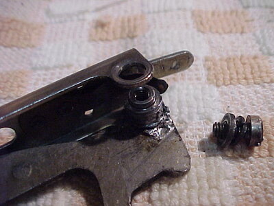

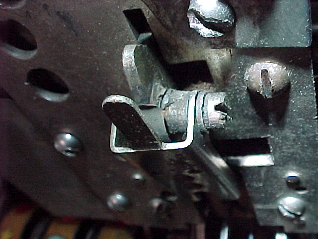

Postby gvt1911 » Tue Jan 24, 2023 9:42 am
Getting into machine and right away I need the coin shute? also this screw below shute going thru is only half. ? Any help??

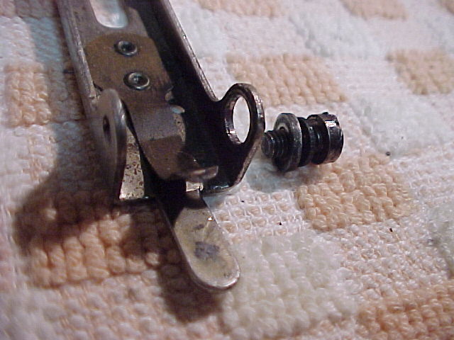

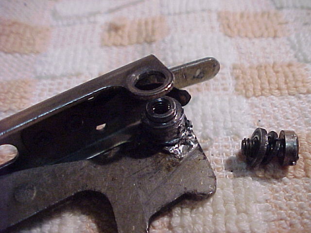

Postby gvt1911 » Tue Jan 24, 2023 12:17 pm
OK,
I need what I believe is called a "throw-out Chute" ...Also I am curious as to this screw? Seems that I need to braze the bushing in properly and then make a screw that goes thru to the other side of this "flipper"..??? Can anyone advise how long this screw should be or have an original???

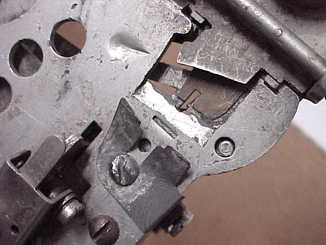

Postby gvt1911 » Tue Jan 24, 2023 1:43 pm
Help,
I need this screw and throwout chute with the small retainer bracket...Any leads?

Postby rtmccurdy » Tue Jan 24, 2023 4:57 pm
That is a check pusher screw and it is difficult to locate (as well as the check diverter). Many operators removed this part and the check diverter (located in front of the coin tube) since the machine was usually used only with coins. I am having some screws custom made currently and will let you know when they are finished. The other part is the reject coin chute and I will have to look through some boxes in storage and see if I have an extra. I also do QT repairs if you don't want to tackle a specific part of the slot. Robert McCurdy

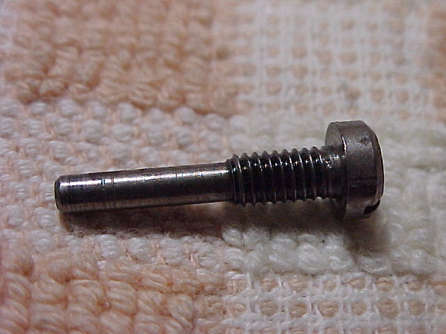

Postby gvt1911 » Tue Jan 31, 2023 6:34 am
Moving right along on this rebuild. I made the pusher screw and the throw out chute. Now I could REALLY use those photos from the book. I purchased the book on a thumb drive, but the illustrations are terrible. I am hoping that someone that has the book could possibly make good photo copies of all the important detailed illustrations for a small fee. This would help me out a lot. :!:
