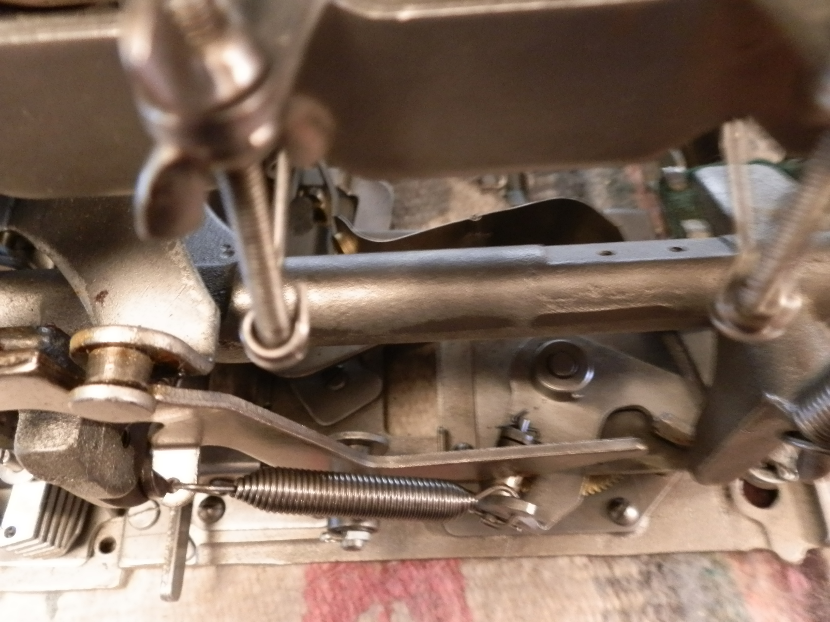

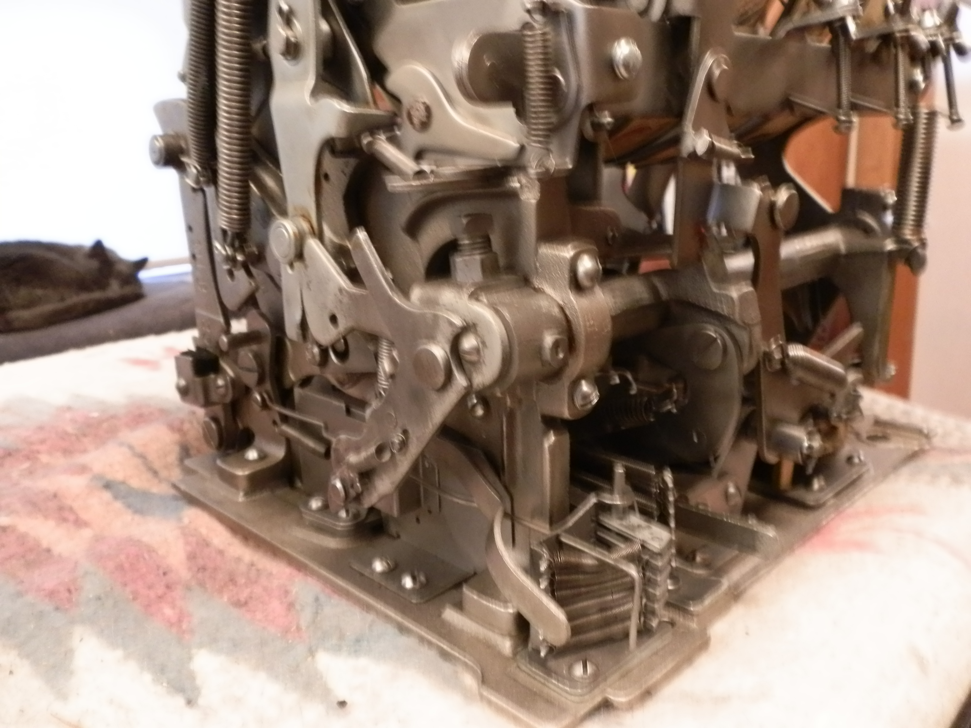

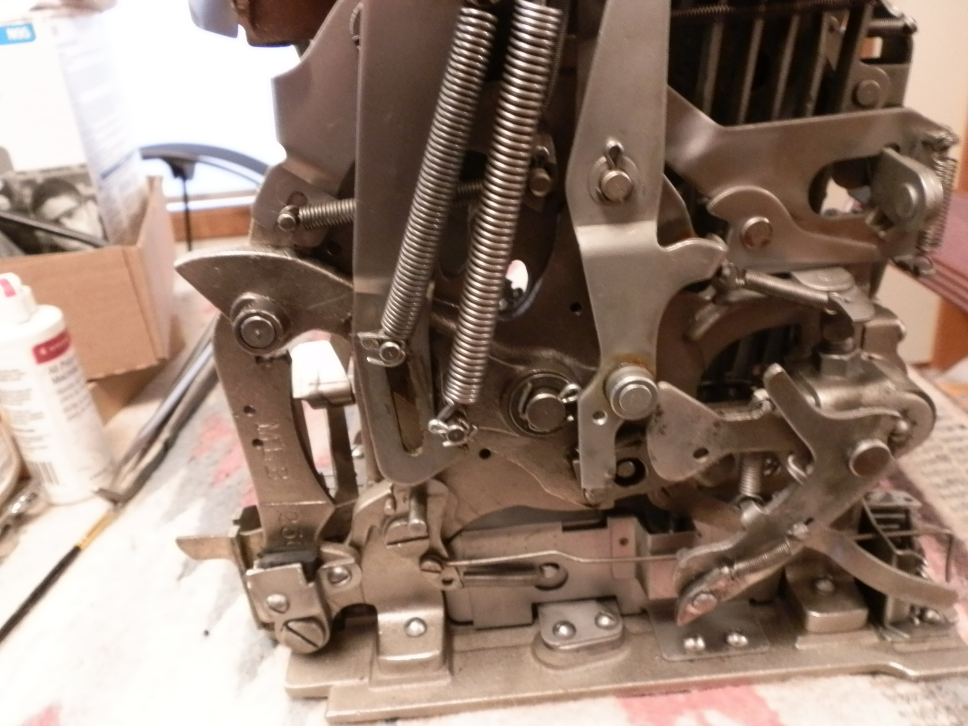

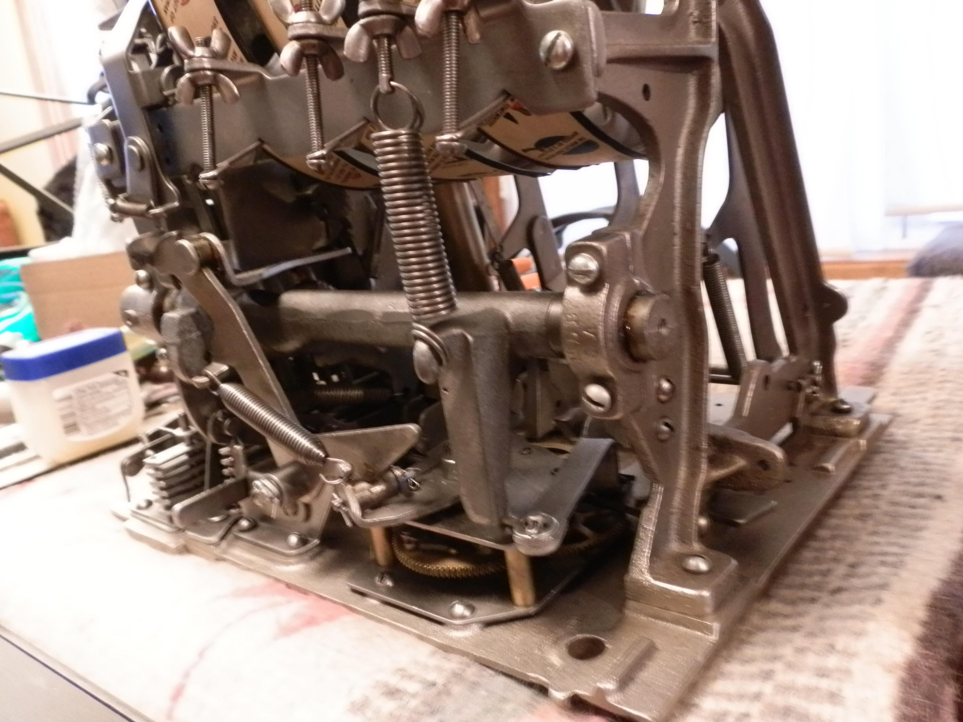

@jmisatu - Thanks for your feedback. Here are the requested photos. Can't wait to hear what you have to say.
@sam2002 - Yeah, I am starting to think I am chasing the unobtainable. I watch youtube videos and their "silent" machines seem to wind up so smooth but maybe it is just a matter of what comes through in the video.
Main operating lever
Right side
Back
Left side

Postby jmisatu » Tue Feb 14, 2023 9:30 am
I was hoping to see the angle looking down onto the operating main arm which is the thick horizontal round cast iron shaft in the rear of the mech. If yours does not have the three outcroppings extending towards the interior of the mech to lift the brake arms during windup the flat surface of the timing bar behind the clock will be used to lift the reel stopping arms using the lower "shoes" of the reel stopping arms. The upper "shoes" of the reel stopping arms, when lifted by the outcroppings on the operating main fork/arm make the windup more smooth. A pic looking down into the mech would show those 3 extensions on that operating arm. See if that makes sense at all. Hope this helps.

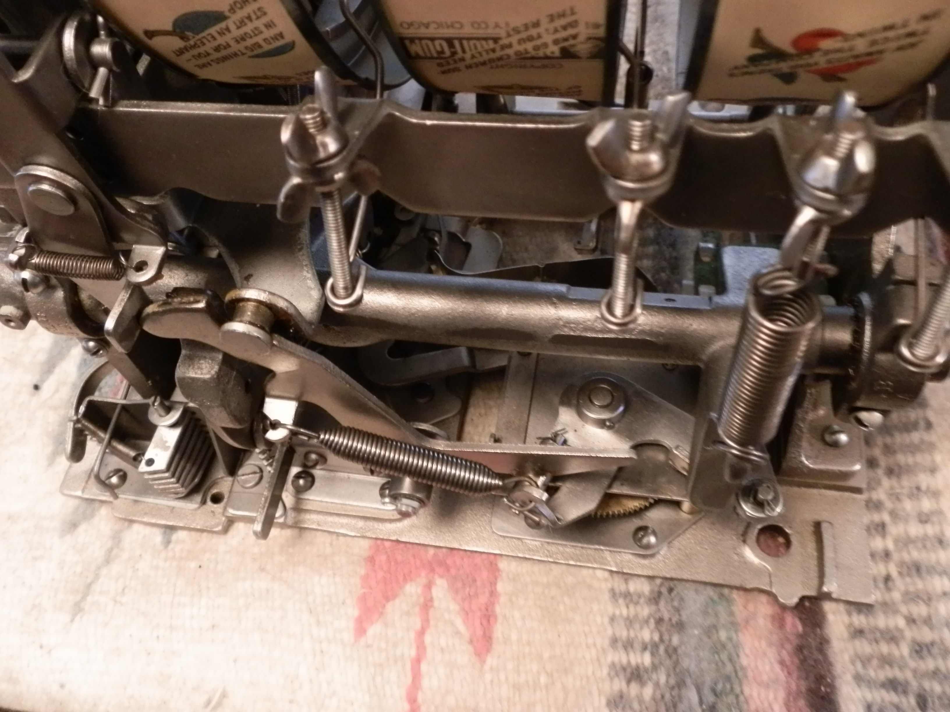

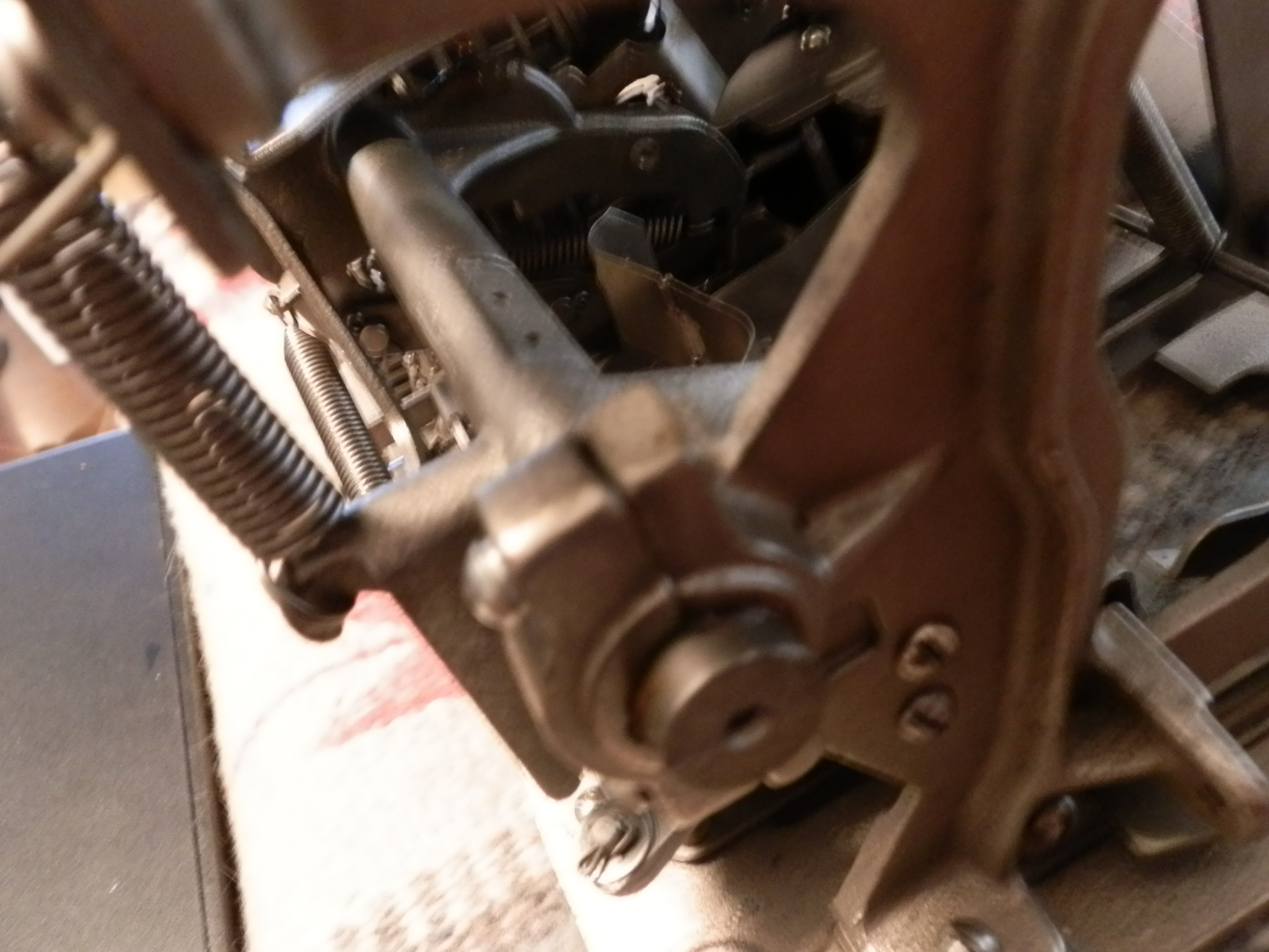

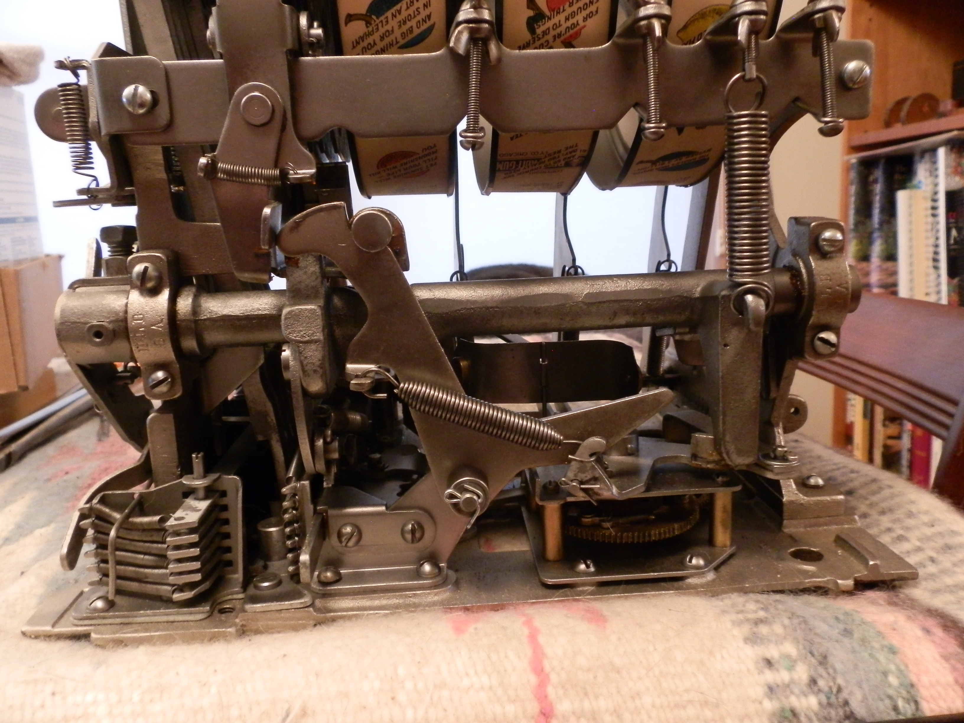

Postby insertcoinhere » Tue Feb 14, 2023 10:18 am
@jmisatu - are these what you are looking for? I did a little googling and think I know what you are referring to and it does not look like my fork has the three outcroppings.....
Top
Left side
Top wide view

Postby jmisatu » Tue Feb 14, 2023 11:33 am
It does not have the lifting arms. There is a two hole threaded flattened area where something might be attached that would be a substitute for those lift assisting protrusions but I am not too knowledgeable regarding that. Most of the time those lifting bars are cast into the operating bar itself. What might help is to check the area on the timing bar behind and just below the back edge of the clock to see how smoothly the reel stop levers are lifted and grease those areas or check also to see if the metal on those three lower "shoes" is not dragging with maybe a bur or rough edge from metal on metal dragging. Removing the reel bundle will permit good access to check that out.
