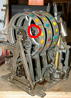

Hi Guy's,
When you talk about bug's, in the old days we called them roll overs, My late father travelled the carnivals with his slot machines, he would take two small washers and a small nut and bolt and fix them to one of the star reels that would display a Bell-Fruit Gum symbal causing the machine to roll over to a lemon or other fruit symbal, ense the name roll over, and as my father would only be at one location for a few days, he did not want any machine to drop a jackpot,later in years Mills even produced roll overs for their 20 stop models.
