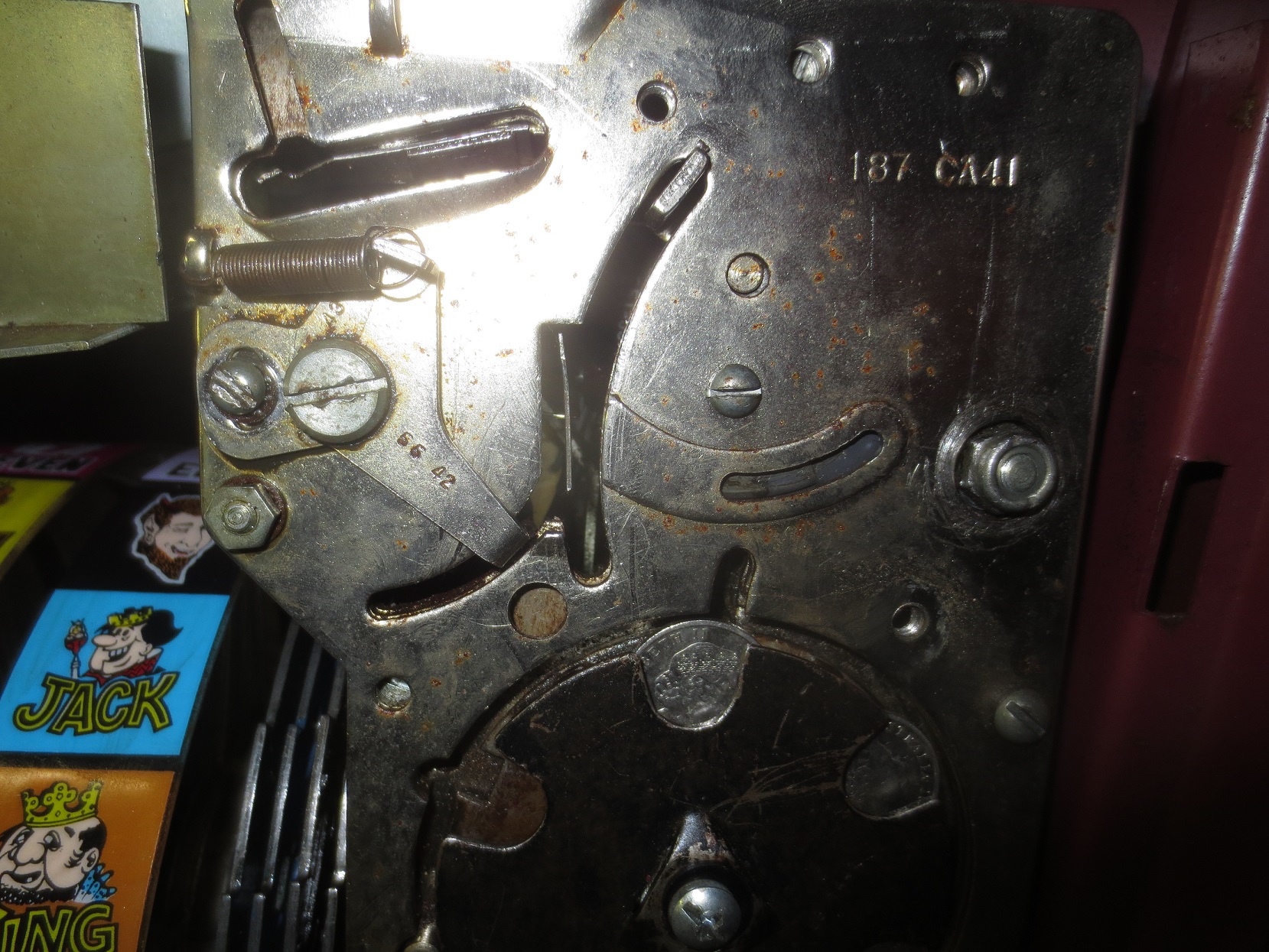

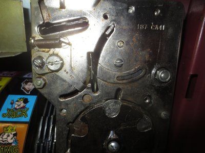

There are 2 problems starting with the insert coin and play now lights, the were working but i may have done something when i put the mechanics back into the machine, i did notice that the little metal piece that when a coin is put in lights up the insert coin and when you insert a coin, it changes to play now well that was a very touchy little piece, in fact when it was working the coin would activate play now, sometimes it did sometimes it didnt, so i am wondering if the problem is there somewhere, if it helps i can take pictures of that piece of metal as it could be touching something that its not meant to, anyhow that was working now its not, blows the fuse up top, fuse 5 to be exact. Actually i went through a lot of fuses so far, lol

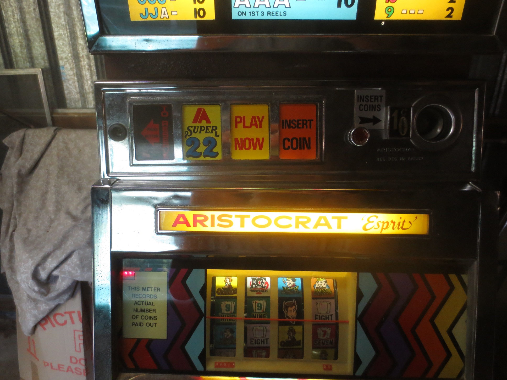

this one shows power but those 2 lights are out

I should tell you to the front of the machine where that little metal piece is around there somewhere and i am not exactly sure, but i did get a tiny shock from the front there somewhere not a big shock just a tiny one, thought i had better mention that.

and this one is the back of that little metal piece that alternates between the play now/insert coin

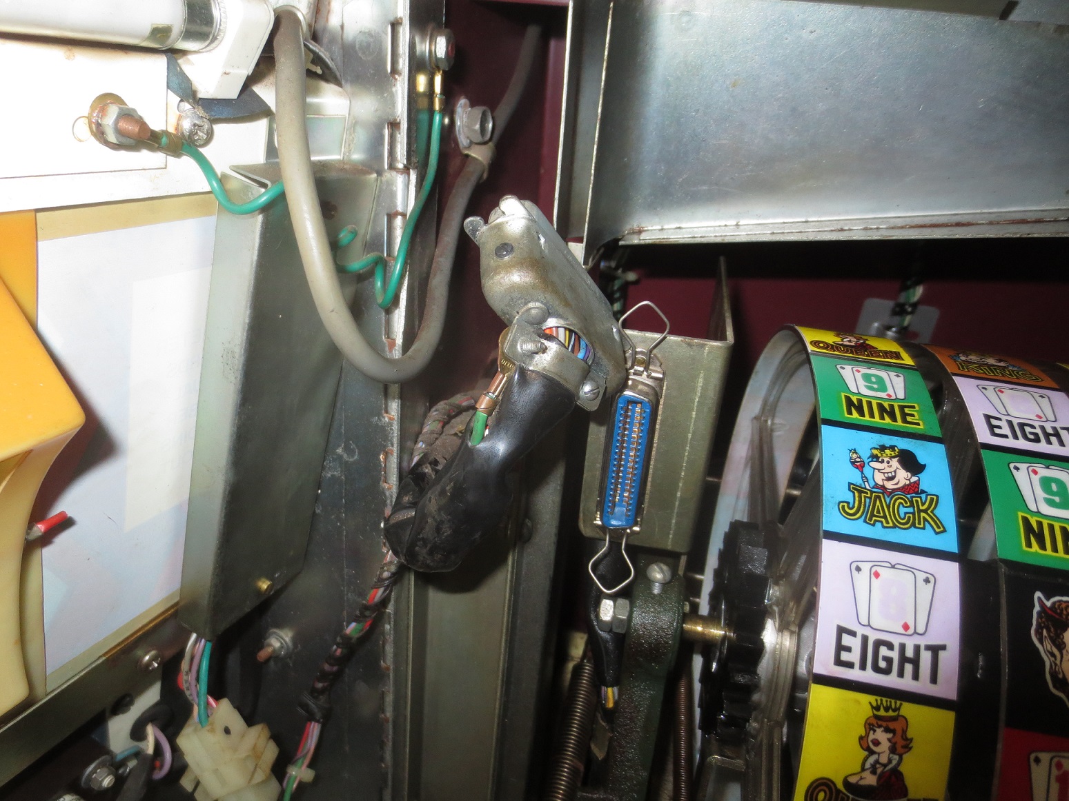

This the cable that must have something to do with those lights as if you unplugged this all lights would work except the play now/insert coin so i guess this cable could be the culprit also

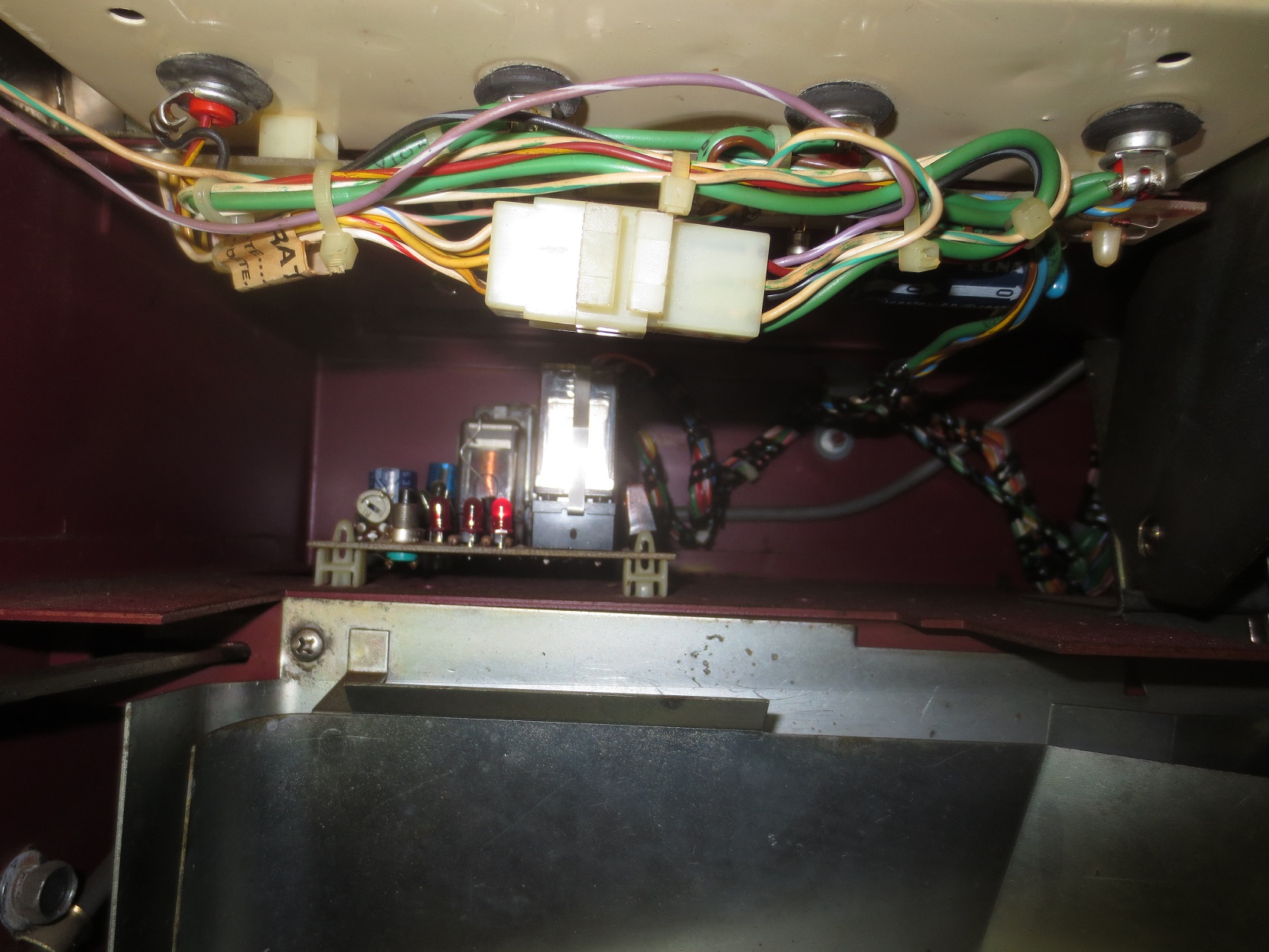

again the top panel above the lights the flip out panel
this is the little metal piece that moves the lights between insert coin and play now, this might be a problem as it was very touchy
this is the top of the lights the flip up panel
