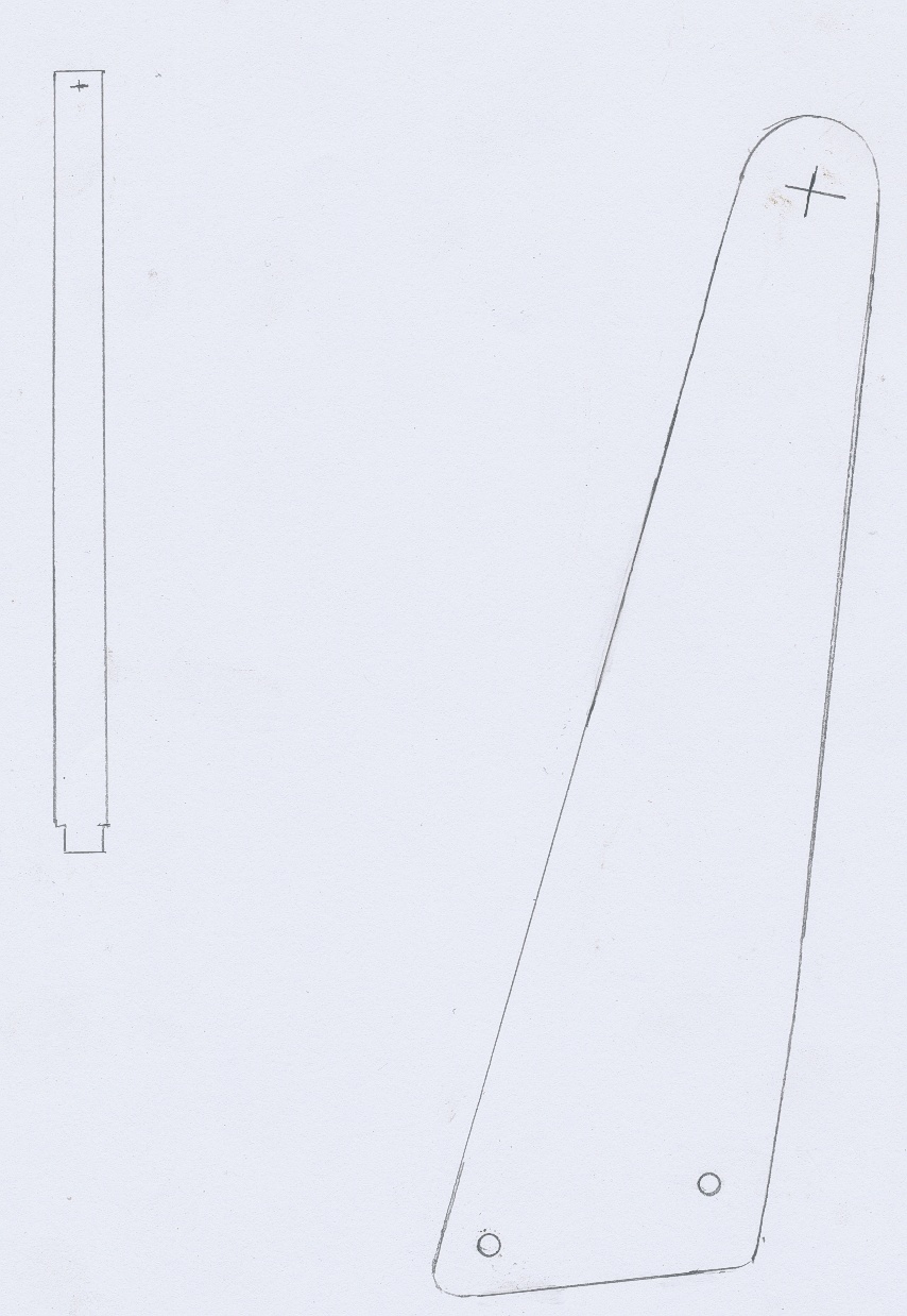

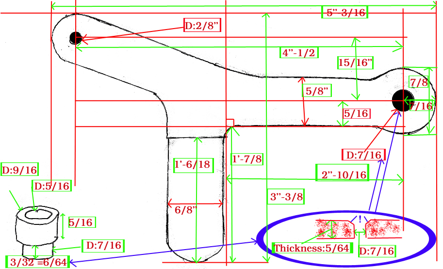

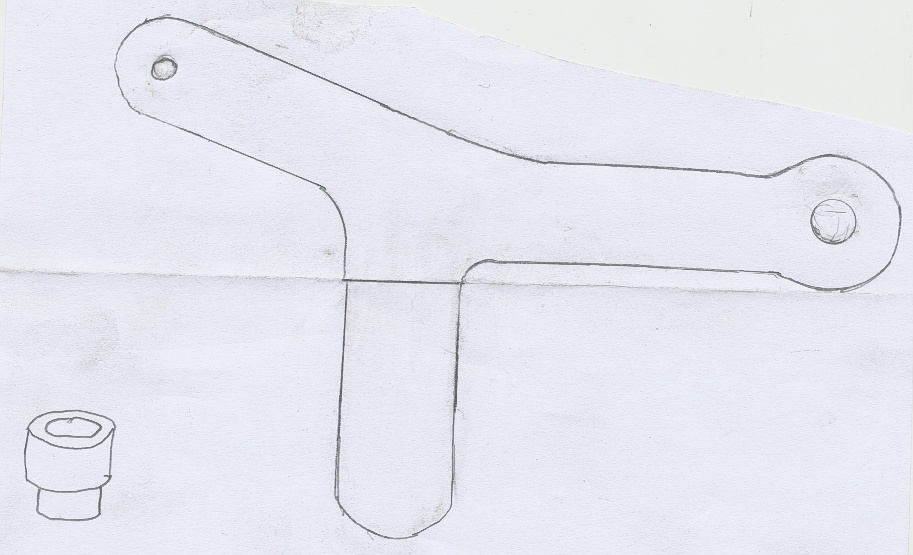

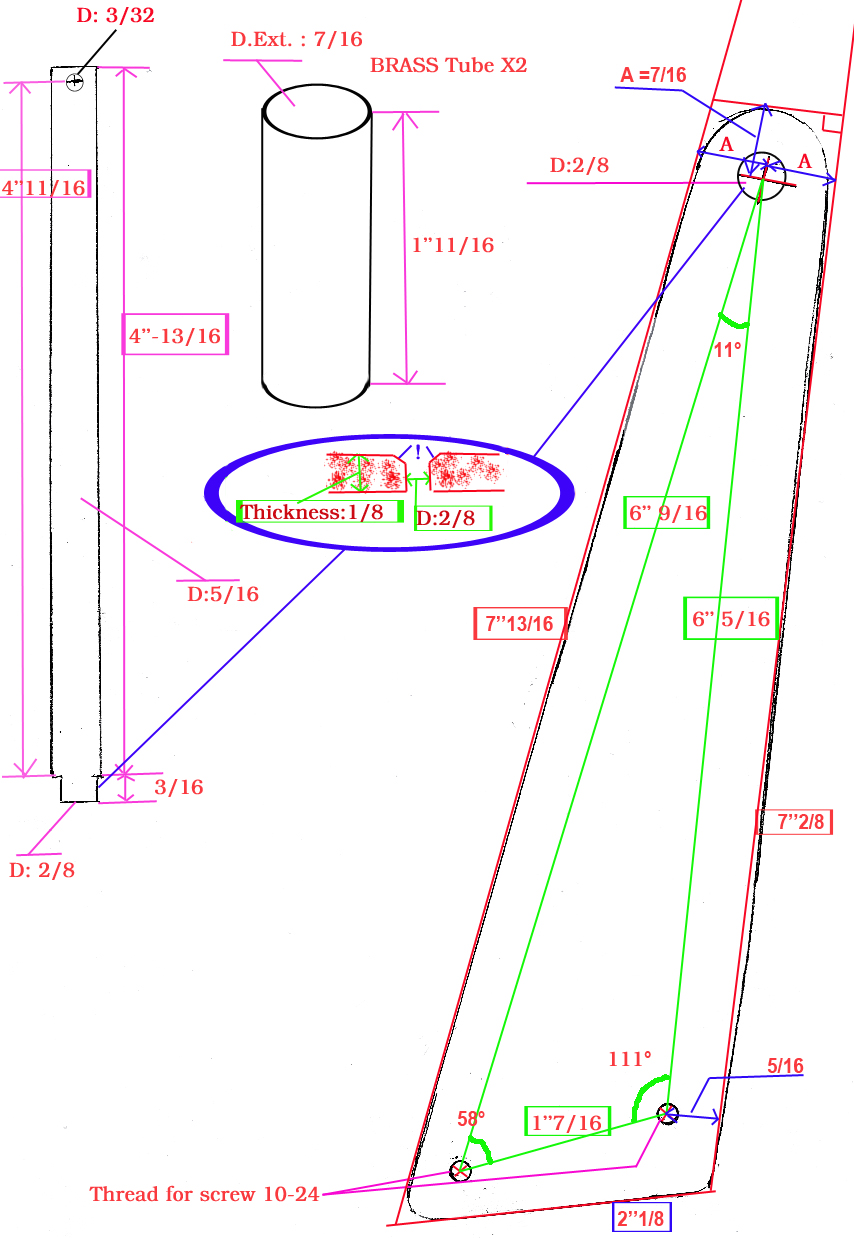

Well , I m back
If this can help you !!??
I have try to make my best and hope that is clear and understandable !
If you print it without zoom on the printer , you will have the original part size ,after ,you just need to cut the paper for help you on the metal sheet !
Courage ,take care of your fingers and good luck !!
Send photos when it s finish !
Stephane

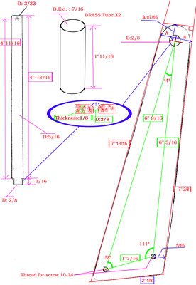

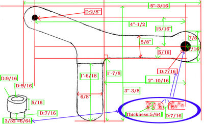

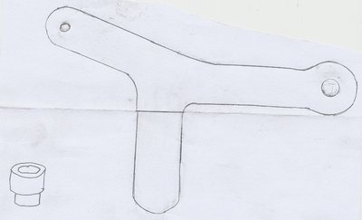

Hi Again
Well , last part !!And go to bed :sleepy2:
Warning ;You need to adjust the value with what you made and what you have !!
If you found an Error , please , let me know ,I will change it !!
And If some one make one , please send us the working progress !!!
And I agree with Monti !! THANK YOU DAVE , and All Other in the Forum !Thank you !! =D> =D>
Stephane

I have most of the parts made, via at work (don't tell the bosses). deciding on which size shaft ,since I couldn't find the right size. 1 is little thinner , other a little thicker. we'll see what I can do this weekend.
Any one else making a set of parts ??
Re: mills skill stop system
Postby JHSS-1944 » Sat Aug 06, 2016 11:26 pm
hello to all;
I have part of the mechanics out / apart , had 1 original "shoe" on the third arm & couldn't get the screws out. reel bundle out for now, ect. right now would be 2 new shoes, screws , ect. needed to slap together BUT, figured it's apart to clean it all up too.
BUT, I also tried to match up the push lever bracket to the frame....... Well the screw holes don't match up.
Stephane has (centered) between the 2 holes = 1" 7/16. My only 2 holes comes to only 15/16 of an inch. I did not drill any holes yet. Since the holes aren't even close, worried I'll drill holes which will change the angle , be to low or to high.
could this whole set up be slightly different with a bit of time passing ; like a revision to make it work better ??
mine is a Goose neck Roman head, Stephane's I believe is a "base ball ".
Shouldn't be any difference but....... We all know , that for what ever reason ,Mills moved the skill stop buttons to the front position , away from the top. I assumed, customers felt better playing it with their eyes focused only on 1 spot of the machine.
Now I'm worried that I will have to modify all the parts I made. just this bracket being to long or short can change everything else.
Just an up date.
might make another piece out of plexi glass or similar, as a test monkey. really don't need to screw it up & have to cut more metal pieces.
Man, why do I have to use my brain ??....... it hurts......

Postby gsx11r » Sun Aug 07, 2016 2:07 am
Hi Jeff
I have check on all mills that I have , always 1"7/16 !!
On gooseneck model(FOK, poinsettia, and other ) ,gooseneck Silent ( Lion head, skyscraper) and Silent(Roman head, horse, Extraordinary, ...) ,Always the same size !!
Since that your Roman Head is an English Kit , And that they was champion of the world for add skill stop on all Slot machine possible , I pretty sure that the two holes are not original !
Do you can post any photo of your Mech and casting ??? It s possible that you have a gooseneck first version Mech without the two hole and have been drilled after for add the skill stop !
Like this :
http://www.retro-jackpot.fr/mills/f-o-k/f-o-k-des-années-20
If you need , I can make a paper with the place where to drill the two holes .
Stephane

you might be right, that they added the skill stops in England. the parts that are marked are Mills for a U.S. 50 cent machine (slides , cover , base plate , ect.), I matched up the part numbers.(yes modified to use British coins) the skill stop parts that are here, look identical to mills & your photos.
why add this on later after coming into the U.K. , if you could already buy it this way ??
Plus if your buying the parts to add later , why drill holes into the frame wrong , when holes are already drilled & threaded into the bracket ? Unless they never bought these parts from Mills , just made their own parts totally ? (sounds like to much time & money to do).
o.k. ,I will go with your theory , it does sound logical.
later today , I will take a few photos of the mechanics, 1 of the current holes in the frame, & the parts I have made (minus 2 shoes).
