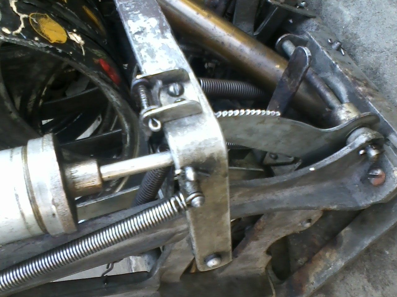

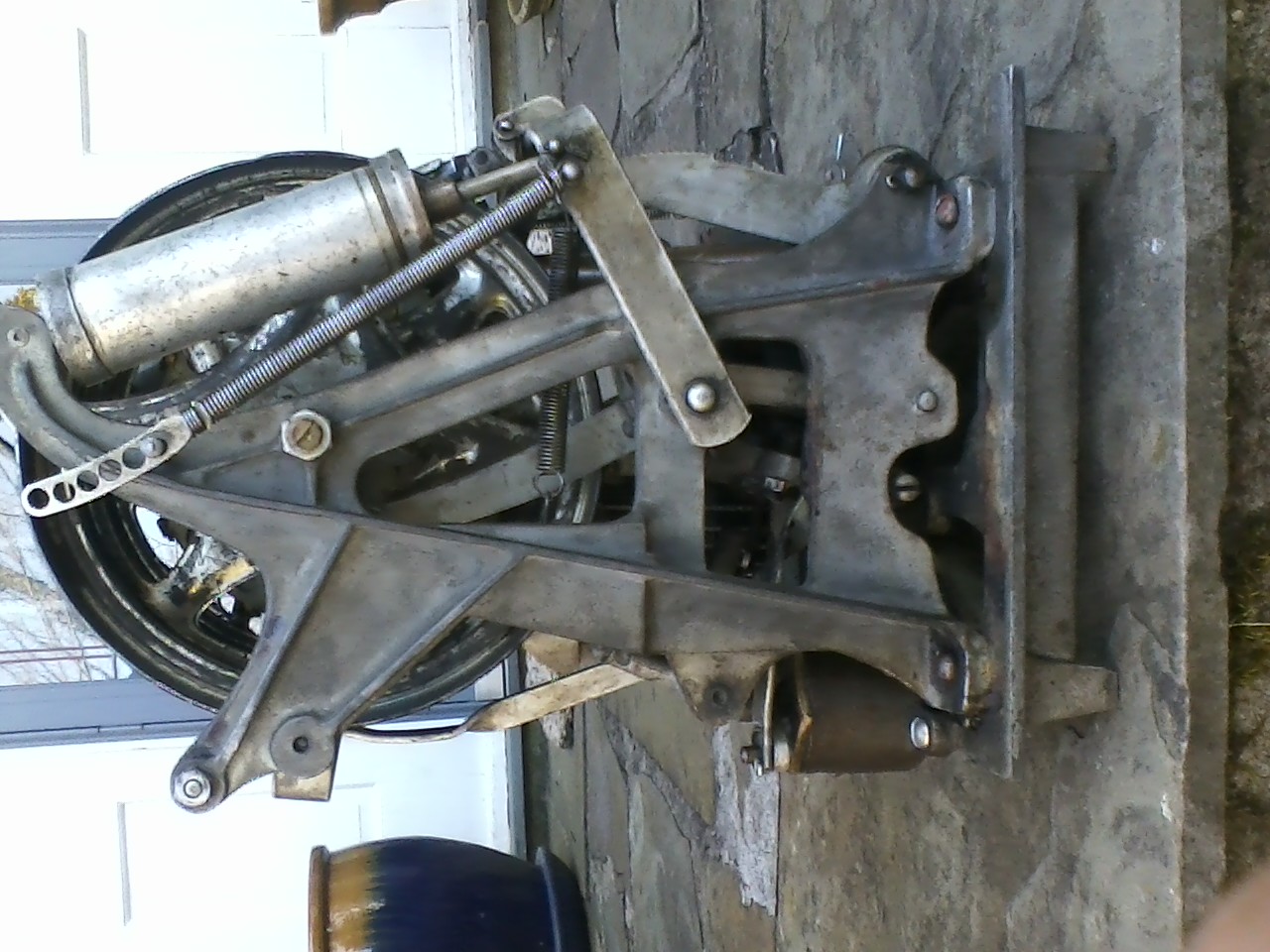

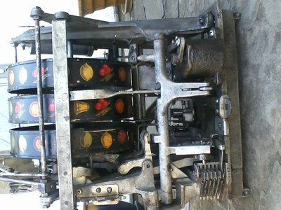

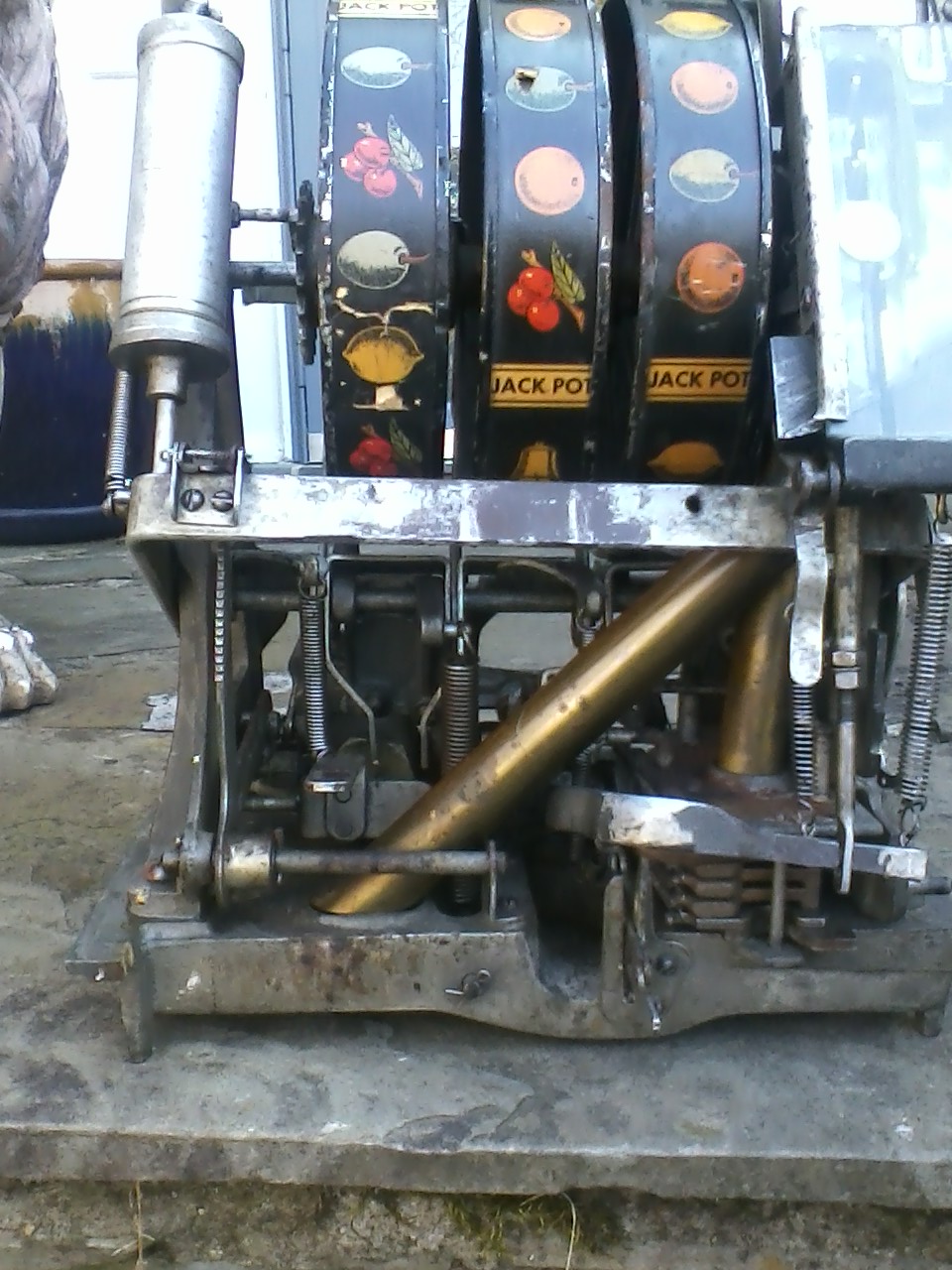

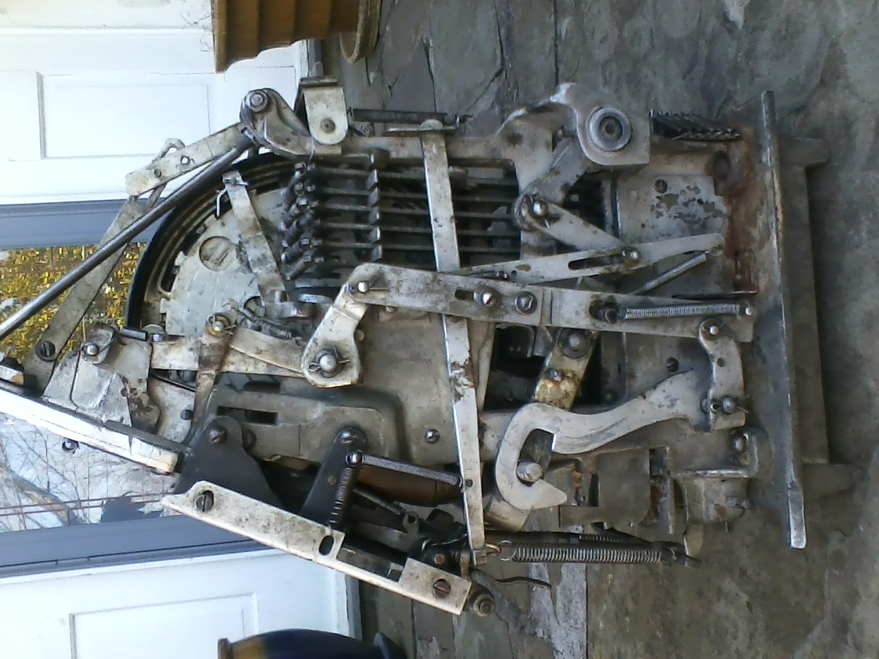

I see the dog tail and the ratchet paw. When I push down on the horizonal bar the ratchet paw catches onto the teeth of the dog tail. I can push the horizontal bar all the way down to the end. When there are no more teeth on the dog tail, I hear a slamming sound and nothing happens. Here are some photos that I just learned how to upload.

Dog Tail and pump
Side of machine
Side of machine
Back of machine
Front of machine

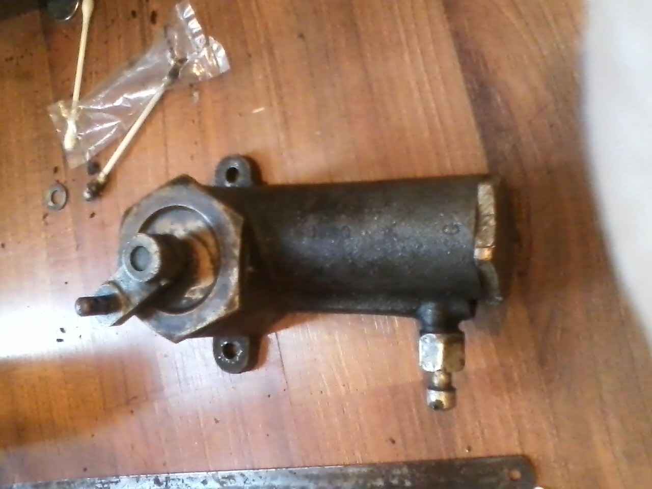

I think briank is correct, you're confusing the pneumatic damper (which has an "air hole" at the top) with the device usually called the "pump," which is a hydraulic dashpot regulator located at the bottom right rear of the mech when viewed from behind. A dry pump will act like a clock that's lost its fan; that is, it will provide no resistance to the recoil of the mech, and would also explain your "slam-bang" malfunction. Remove this device-- it is held by three screws to the frame-- and push the crank arm back and forth; if it offers no resistance in both directions, then it is probably dry. If this is the case, try following the instructions I offered to another forum member on this thread:

I am attaching two photographs. The first one is a picture of the front of the machine. The second one is of the pump. The pump lever resistance is inconsistent. When I pull it rearward (as if I was pulling it towards the rear of the machine), there is some resistance at times and then no resistance. There is no resistance when I push it forward (toward the front of the machine). The rather large endcap has been buggered a little bit. It is as if someone tried to put a set of visegrips on it. I believe that I have a socket that large enough to take it off. But is the endcap to be removed to refill the pump? Second, what does the adjustment screw do? Should I first try and adjust the pump by turning the adjustment screw one way or the other?
Hydraulic pump
