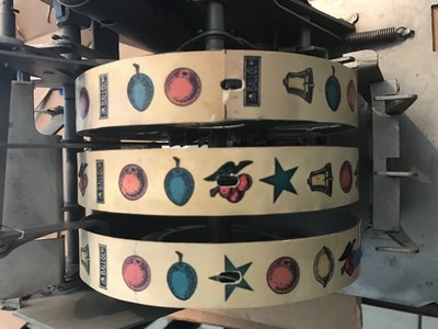

Jack ; as Bill stated these are reproduction strips , Which Bill made. He's also correct that many versions exist for this machine, depending on the reel tin "disc " combination..... less of 1 symbol ,more of another, Or as seen here , A star symbol replacing another symbol.
from what little I can see in these photos the last reel strip wasn't put on correctly (I believe) to start with.
dealing with Bill, he can help you figure out which symbols can be "covered over" ,OR which set actually will work for your machine.

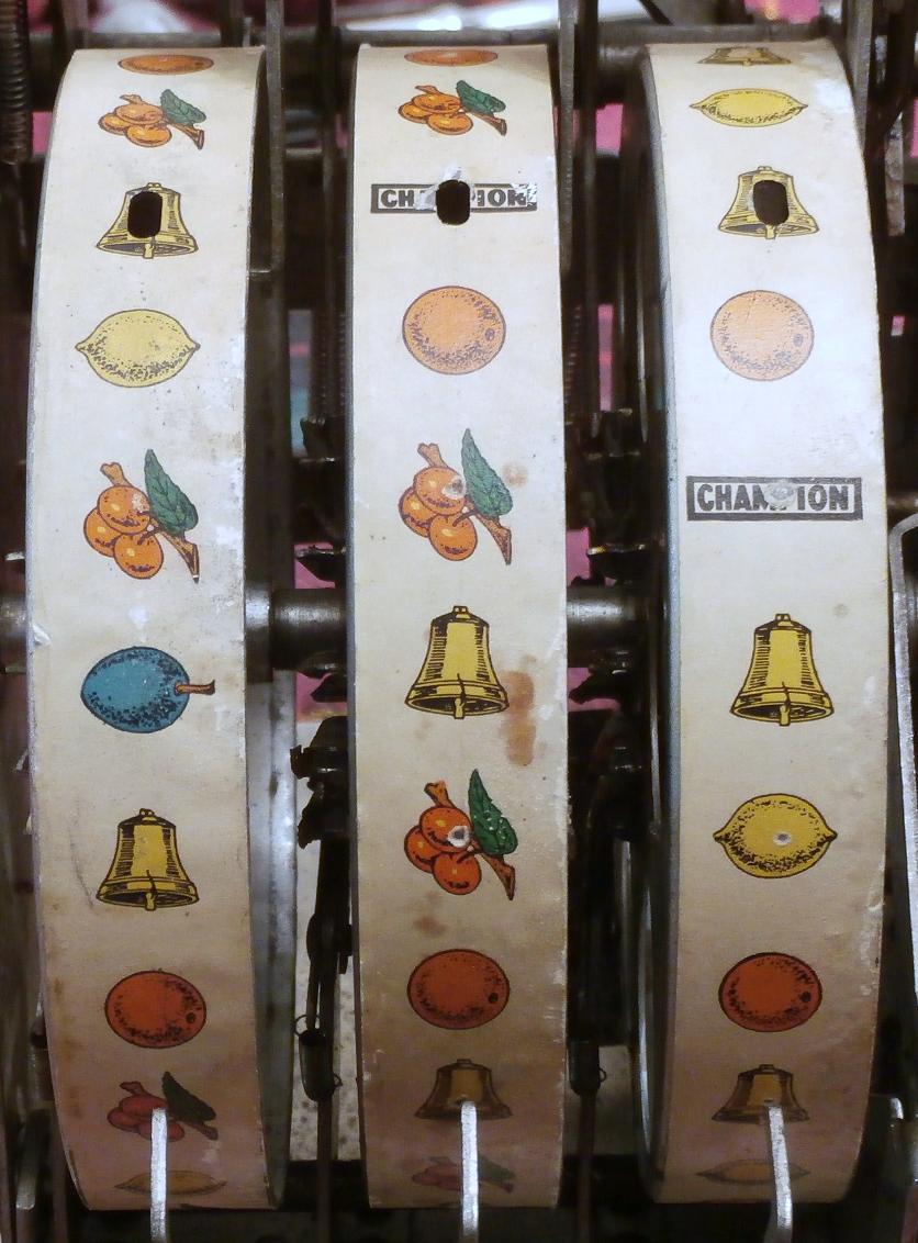

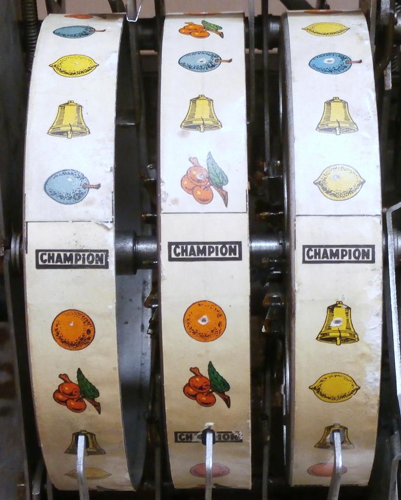

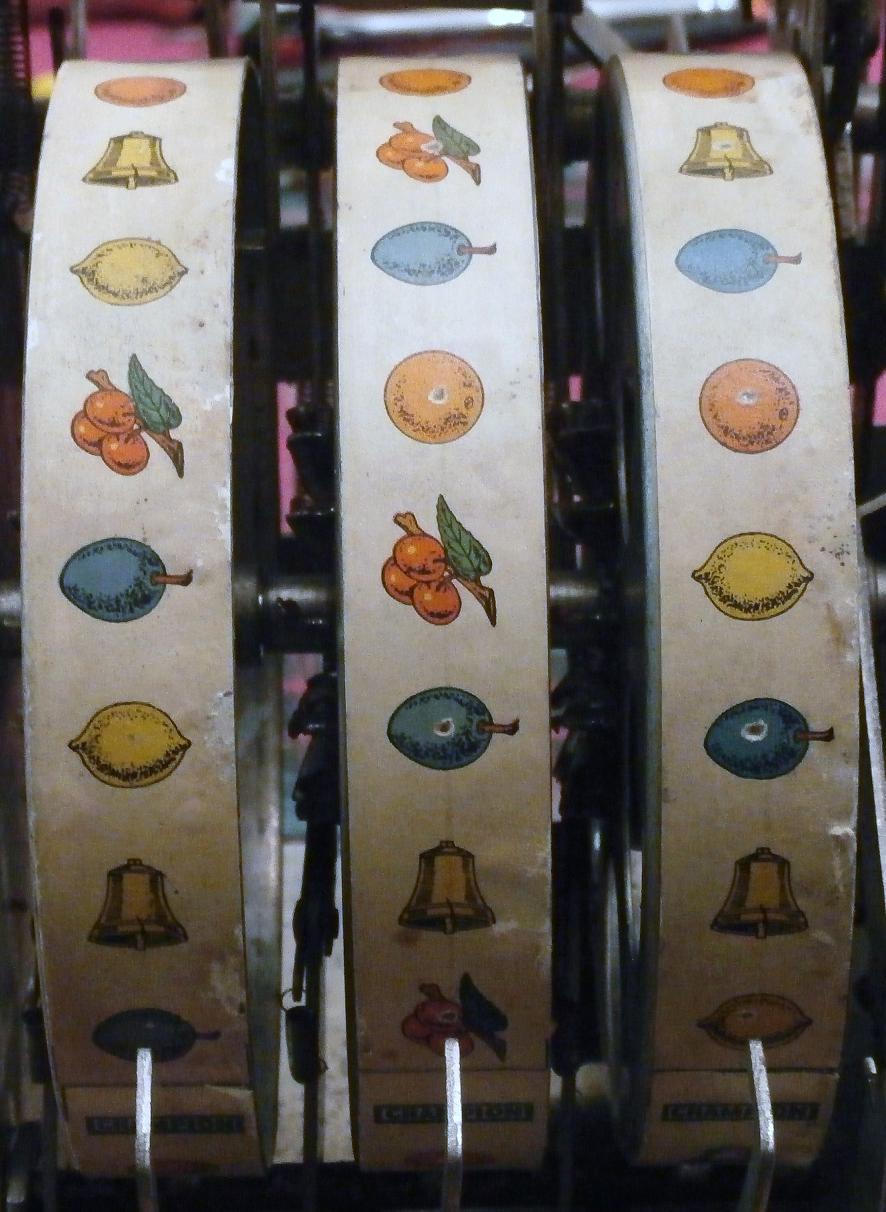

Below are images of my machine, which might not match yours. note on mine, the holes through the reel tin would be the 4th symbol down from the top "BAR" = which is the gold award bar for This machine.
These photos are of my machine , just 1 example of what was made / used.
I will follow up these images later with others via another thread. I honestly thought figuring what went where would be a bit easier but, I was wrong. So really checking into it on my machine.
Who ever thought this design up was very smart & ingenious. first; 24 symbols but, only 12 actually get played (like the early 10 stop mills slot machine). then the working lay out helps prevent other possible wins.
Yes , I took mine apart to photograph these reels.

Well the previous owner's note showing stops are incorrect. He showed on the note in a post above 9 stops on reel one, 12 stops on two and 22 on three. However just like Jeff's reels the 3rd reel has 17 stops. So I'm assuming this is one reason it is not working correctly.
So now what?

Now that I see the reels from Jeff's machine, and the 9 - 12 - 22 coded disks, those strips should have never
been ordered to place on this "Champion" model, if your disks are the same code pattern. This is going to take
awhile, to get something put together for your machine, as I have some other strips, but they are still not the
exact strips you need. The original "Champion" fruit symbol strips, had the word Champion in the Bar symbol.
I also ran across another Groetchen fruit set, but they are for a 20 symbol reel.

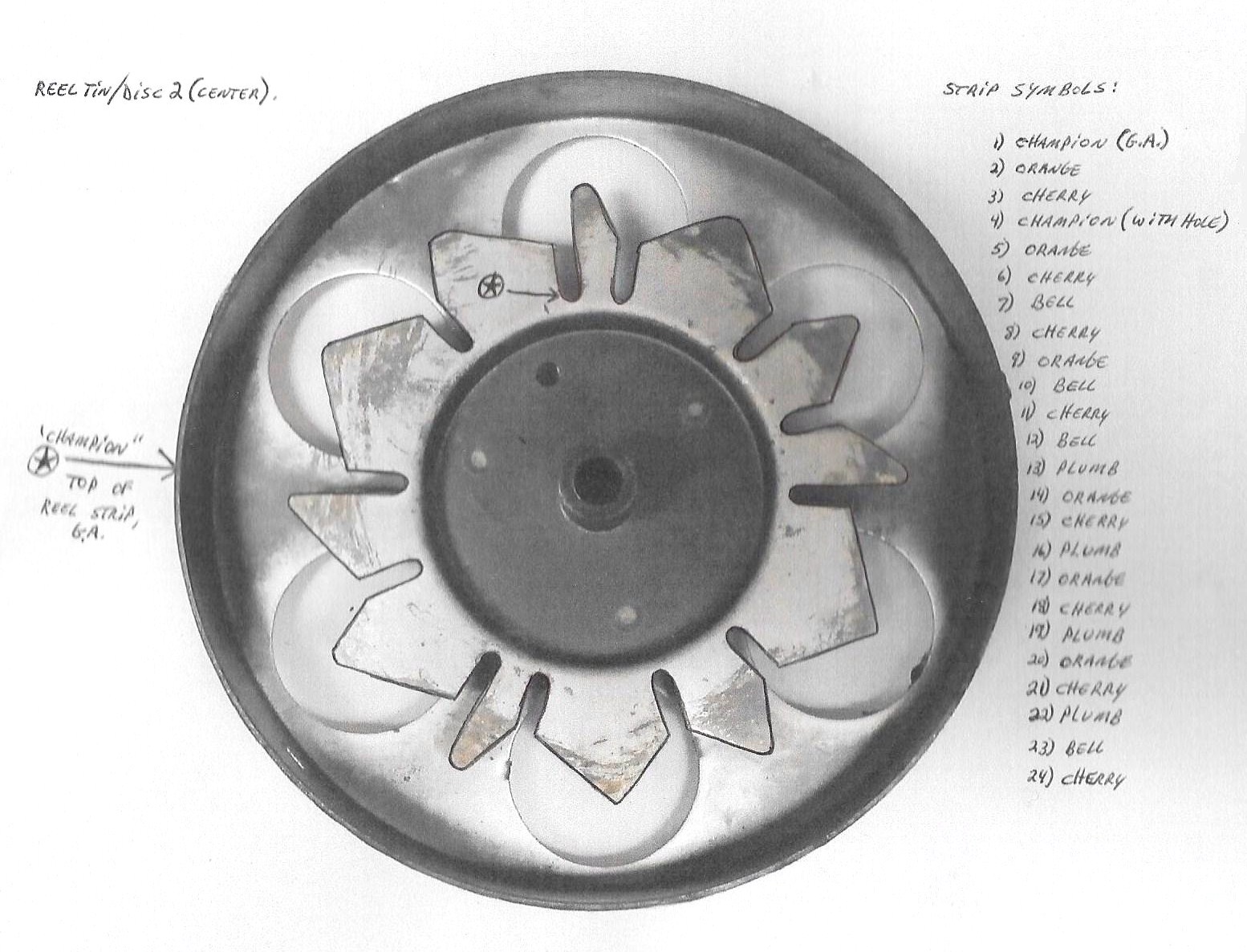

what's needed is better photos of your machine Jack = of the notches in each reel "disc". just to ensure it's the same as mine , Might not be.
do the best you can & see if the photos I put up match what you have. Any little variation , means a different symbol or win combination. who knows how many variations they may have made over the years on the Champion / Sparks machine.
Honestly, never knew mine was a 12 stop version, never had it apart or needed to & never thought about it.
the design of the "disc / notches on reel tin #2 in very ingenious , really limits many other chances of winning combinations.

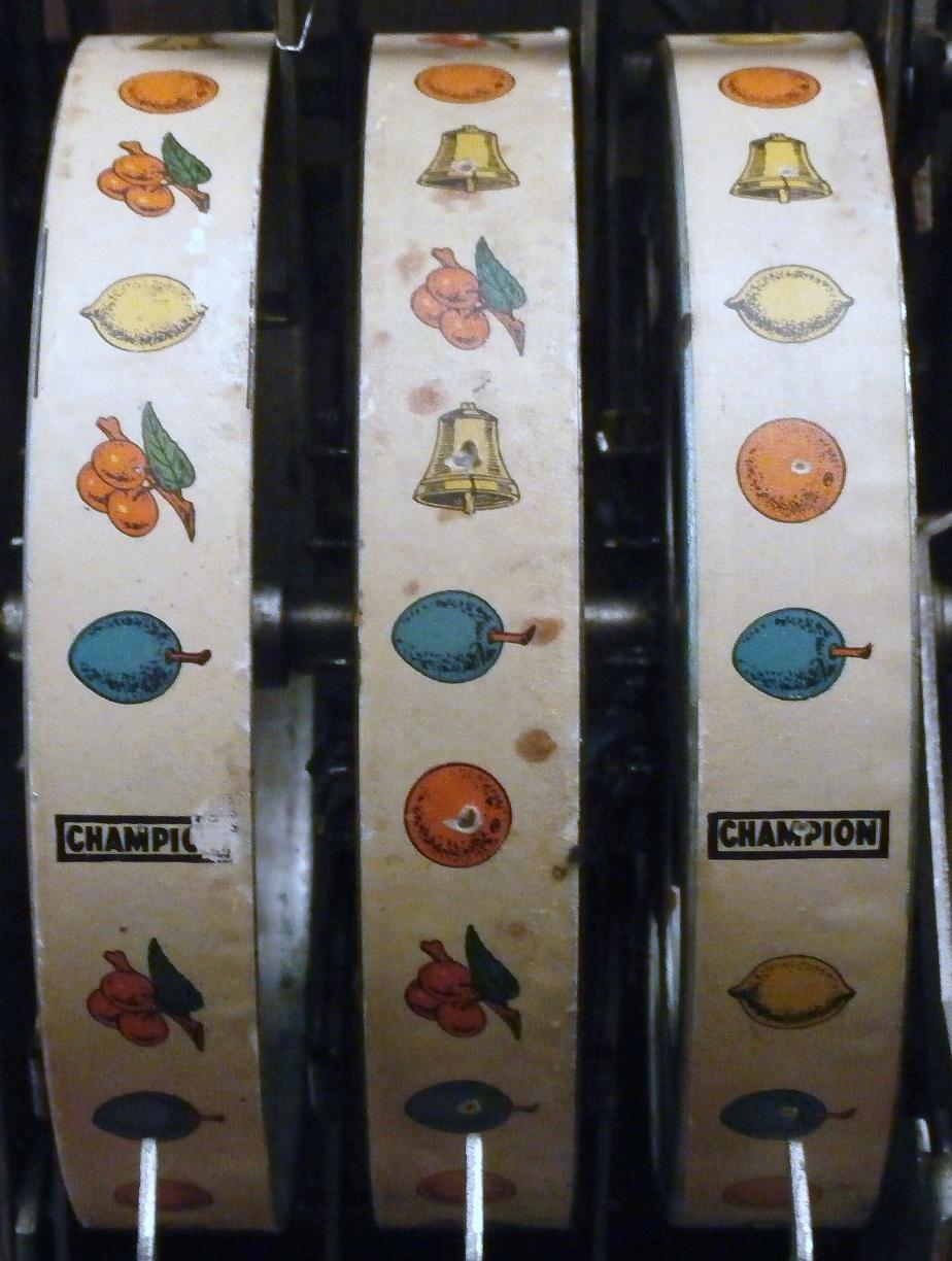

here's photos of the reel strips, little beat up But.....
notice they're a tiny bit off from each other when mounted.
