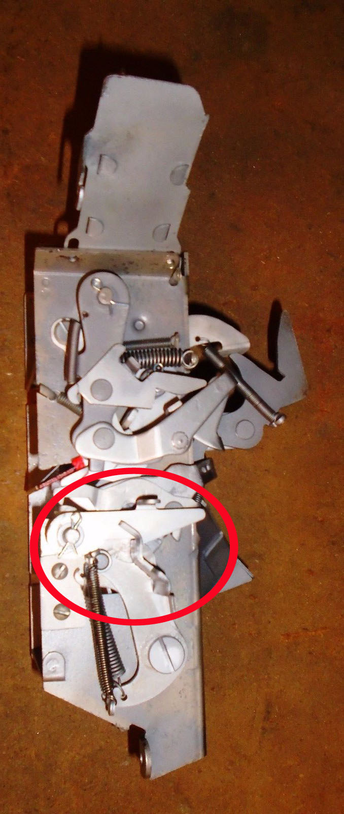

Hi Mechanic,
The jackpot is definitely not working properly. I almost bought a replacement jackpot because I thought I had pieces missing on mine.
However it turns out that front / hand load jackpots look different than other ones. Thank to @RameGoom for posting photos of his
jackpot, which looks very similar to mine, I am hopeful that perhaps I can get my jackpot functioning again.
Any thoughts?

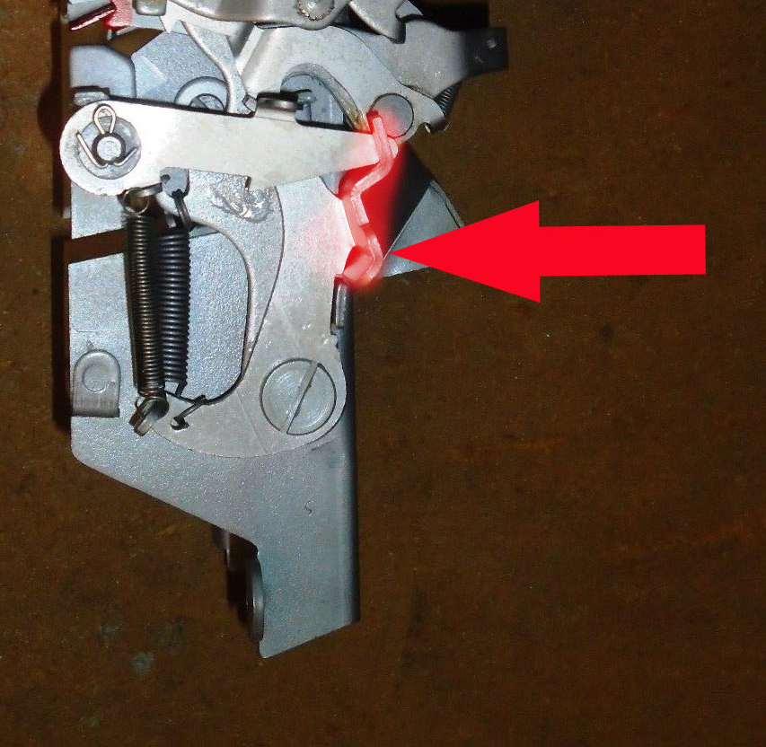

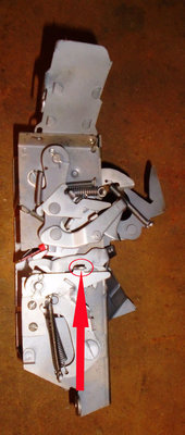

-For open it , you need to push up this part !

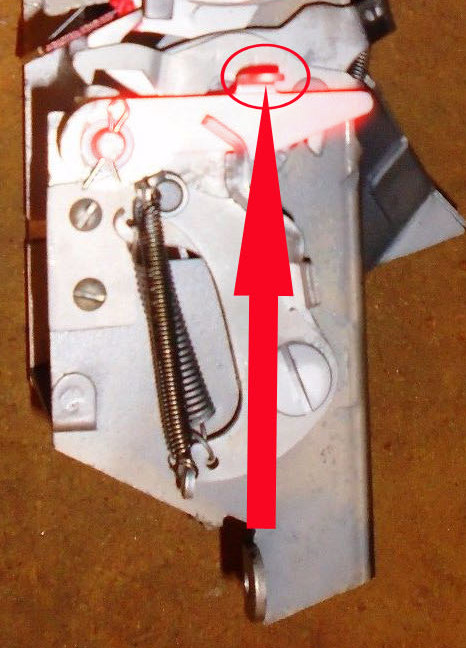

-For close it , you need to push on up this part:
That s all , very simple !!
Try this ,don t forget to put some coin in your jackpot ,and tell me if it work !

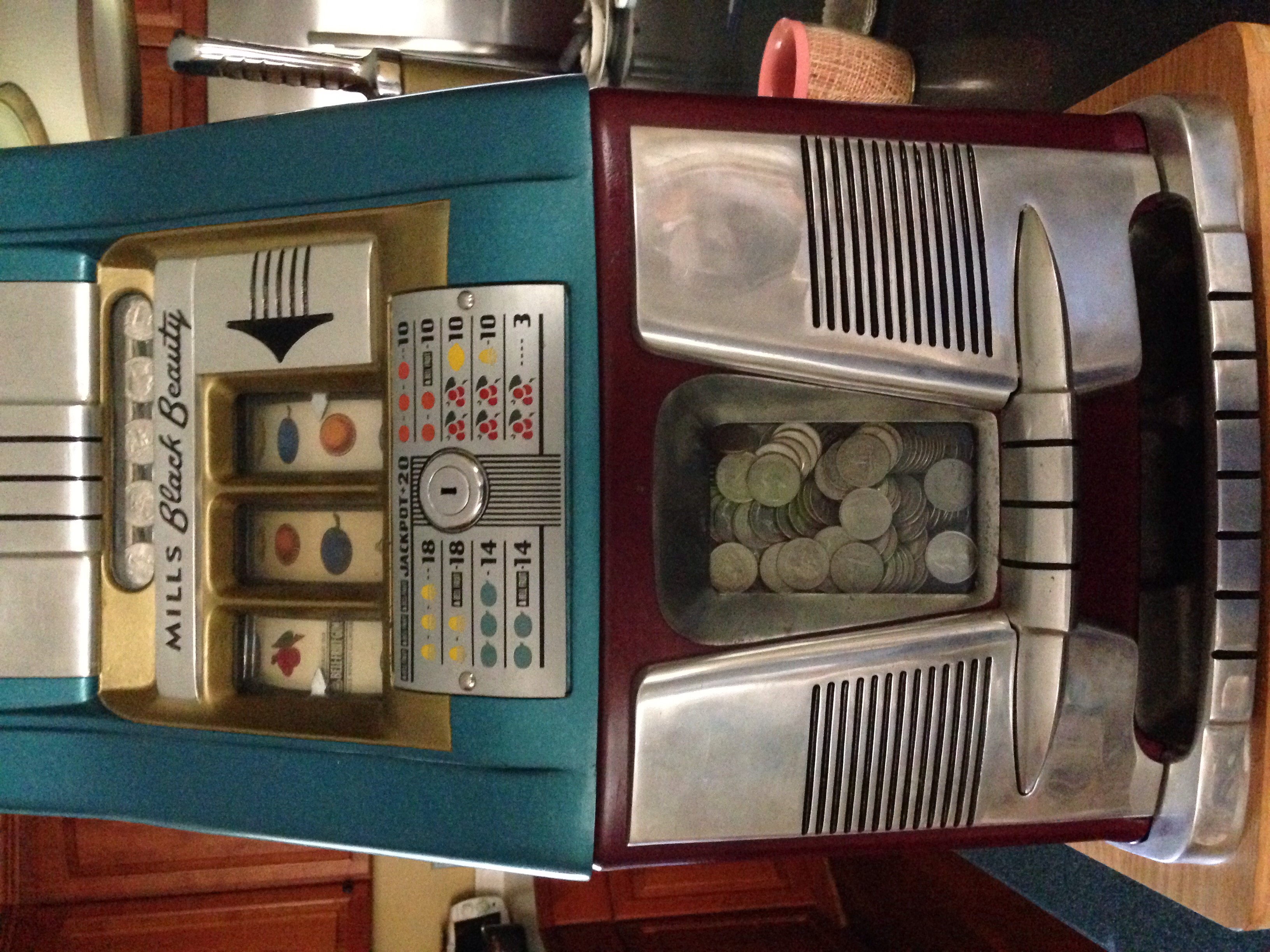

For clarity, my jackpot is currently completely full. I only learned that my mechanism had an issue
when my son got 3 bell fruit and the jackpot did not empty / nothing occurred.
I wondered, does my mechanism possibly have a setting that turns off the jackpot payout feature?

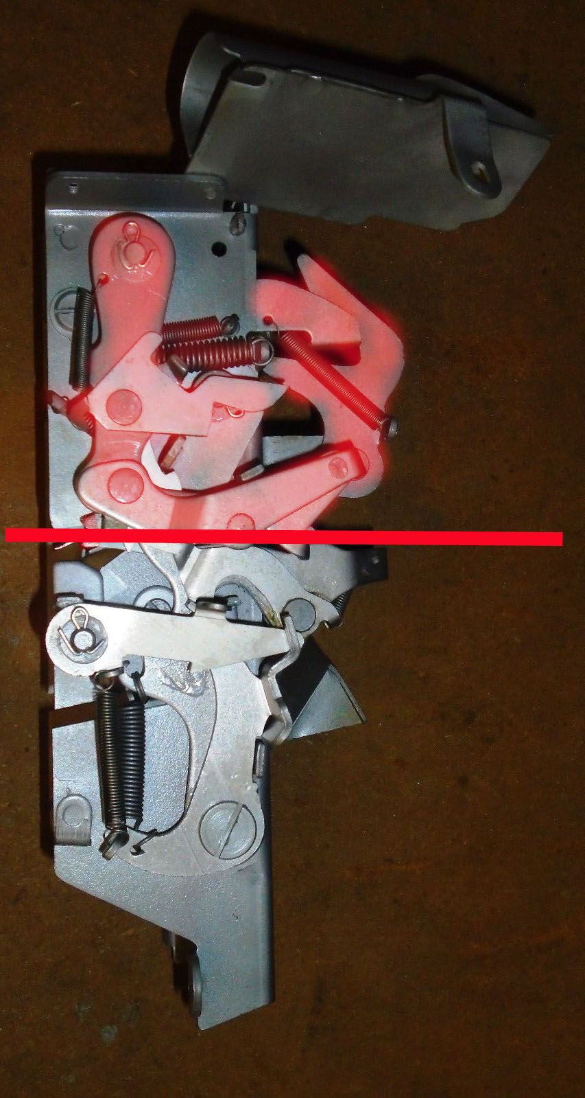

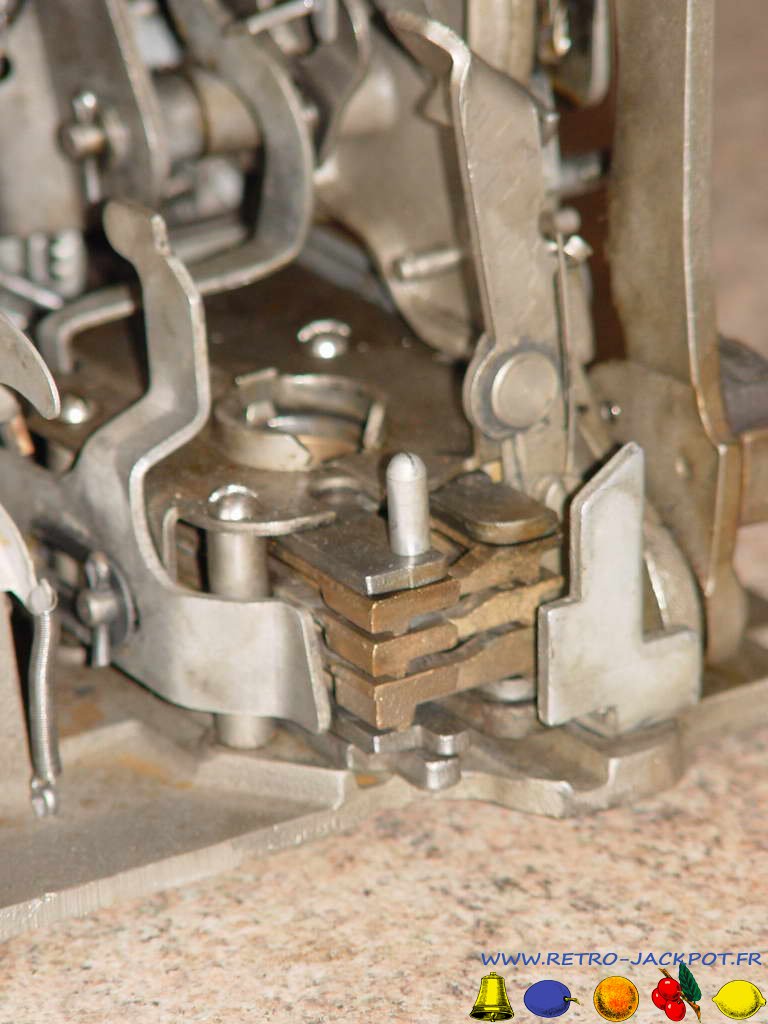

I need a photos of the coin slide when you have set to three bell fruit, and released to complete the cycle, like this view !
I know , it s not the same like your coin slide , but if you keep the same angle for take the photo ,that will be perfect !!

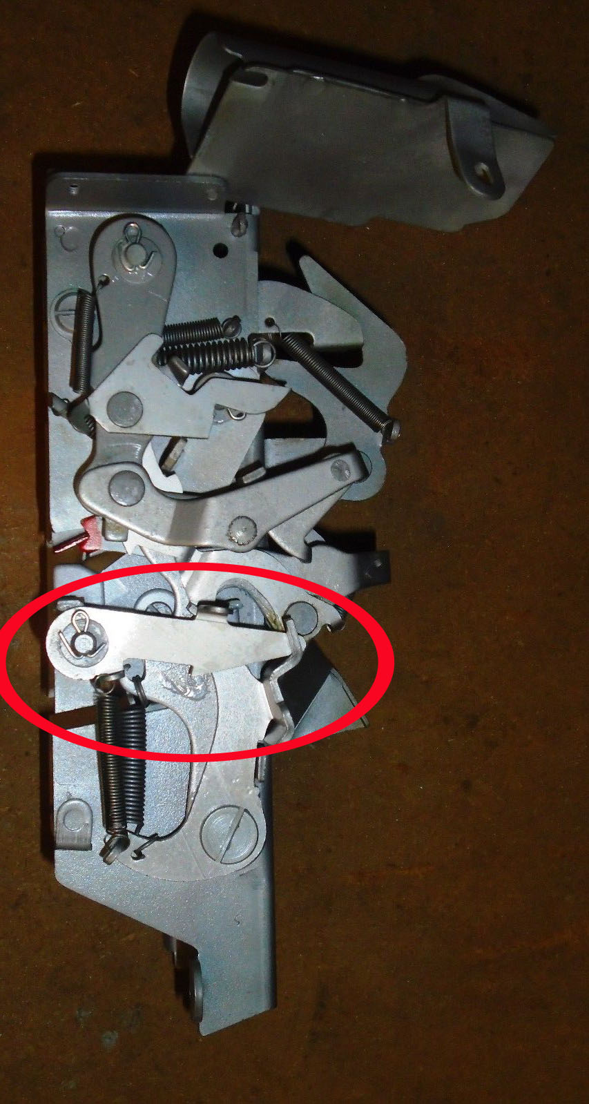

And for be sure about the jackpot , all the part see on my photo are the same than your jackpot !Exept all the parts in red over this line (not present on Hand load jackpot).
And for be clear !
Push up the red part for open the jackpot:
And this red part for close the jackpot:

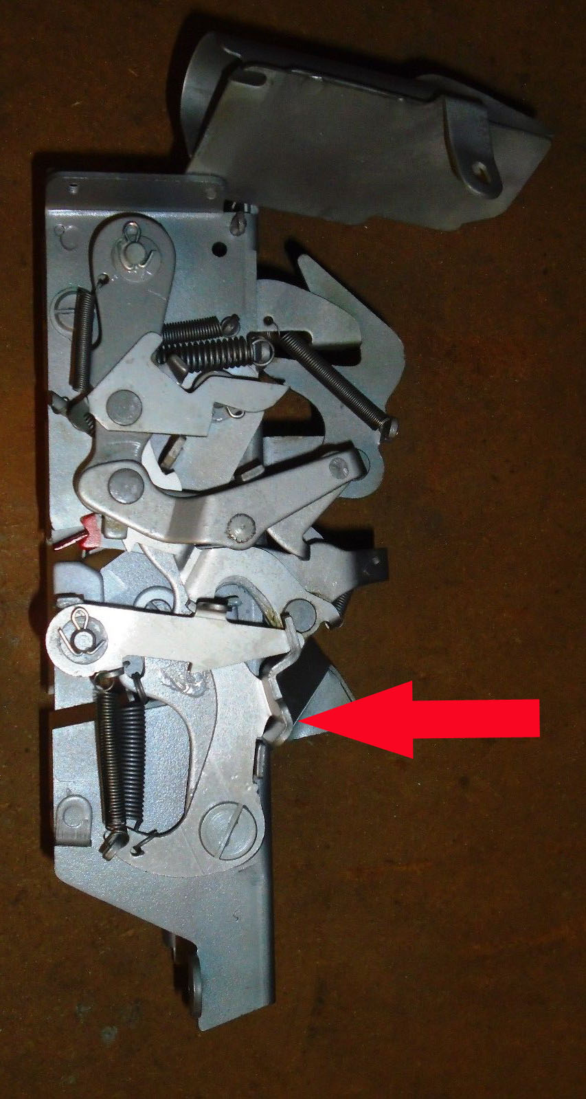

Re: 25¢ Mills Black Beauty Jackpot + 20
Postby aldiener » Sun Jun 24, 2018 1:57 pm
Hi Stephane,

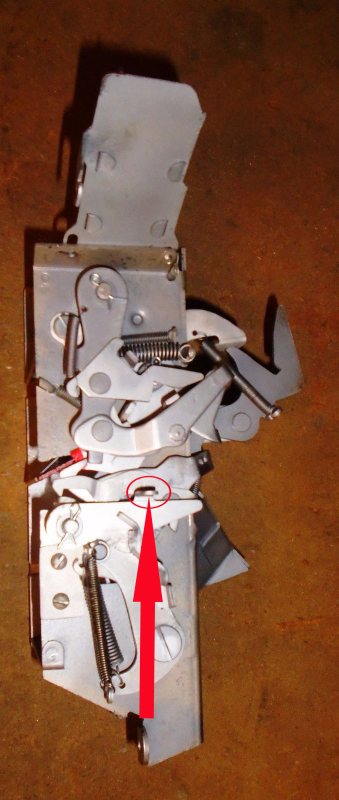

Your last set of photos are fantastic and provide the exact clarity I was seeking :-) Thank you!
Herb helped me to identify the tab in the second picture as well as the part in the third photo.
The part in the third photo is moving somewhat sluggishly but because the tab on the jackpot rightside
is stuck, I have no way of knowing if this sluggishness will prevent the jackpot from tripping.
I will keep you in the loop as i make further progress :-) Thank you again for your support.
