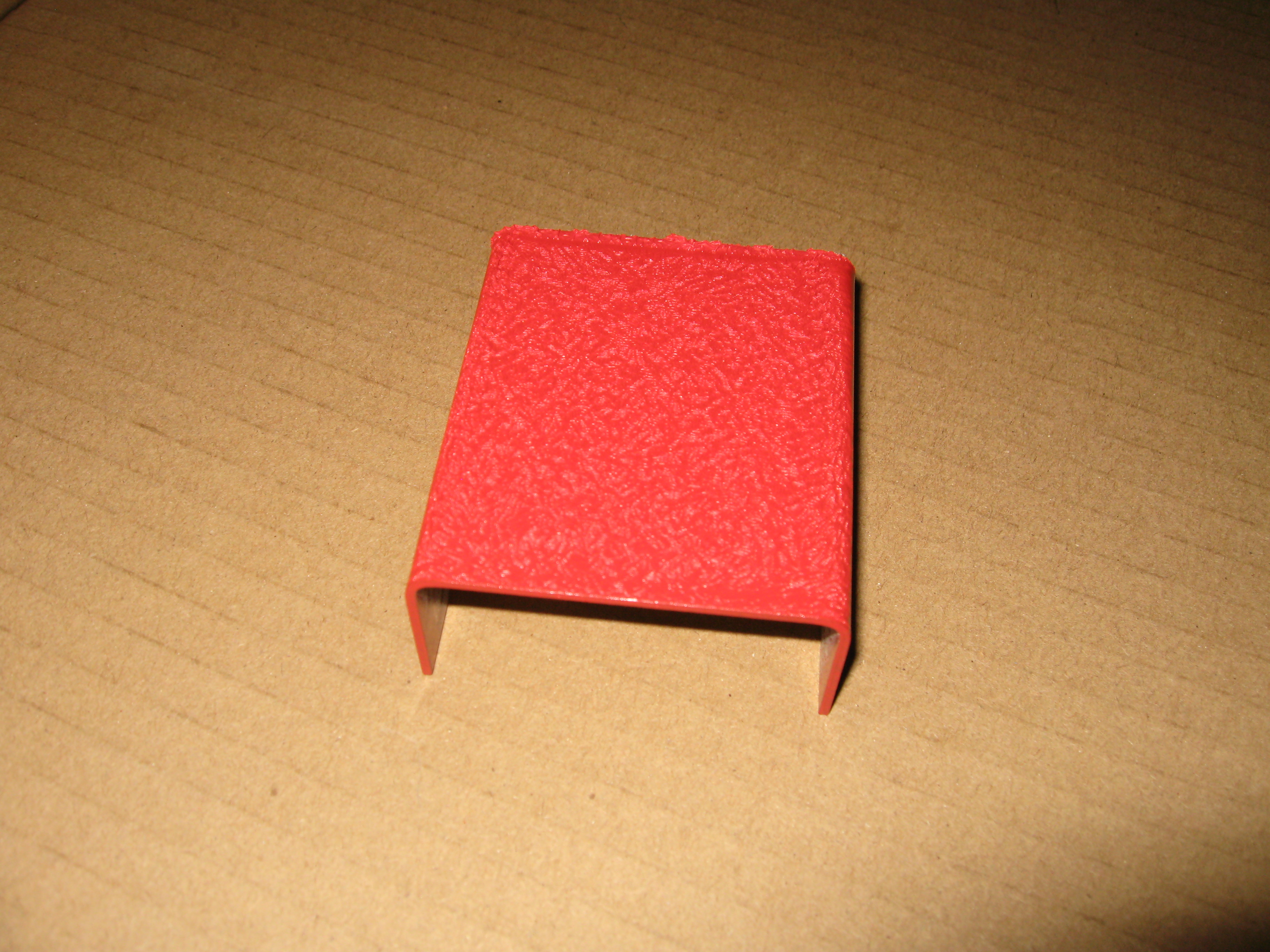

Yep I have used VHT wrinkle finish in the past and got good fairly good results (Groetchen Ginger in red recently). I am using that red as a base coat on a test piece to see how it copes with a different colour finish layer. Should be no problem getting close to the green. Not a perfect solution but will be interesting to see how it goes. Waiting 48 hours for the red to dry.

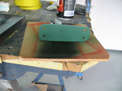

Postby integ194 » Tue Oct 20, 2020 12:34 am
Completed a test on the sample metal bracket using in separate sections primer and no primer. With primer the green (over the counter green automotive spray can) was a shade light and without primer too dark. I will play around with a slightly darker primer to achieve a closer match. I was happy that using the VHT wrinkle base coat the finish following primer and finish coat looks fine in terms of the original. I note that many vest pocket restos are finished in quite bright colours or the later twin colours. I prefer this original, fairly dour finish, because I believe it gives a 'camouflage' effect which is in keeping with the history of the machine.

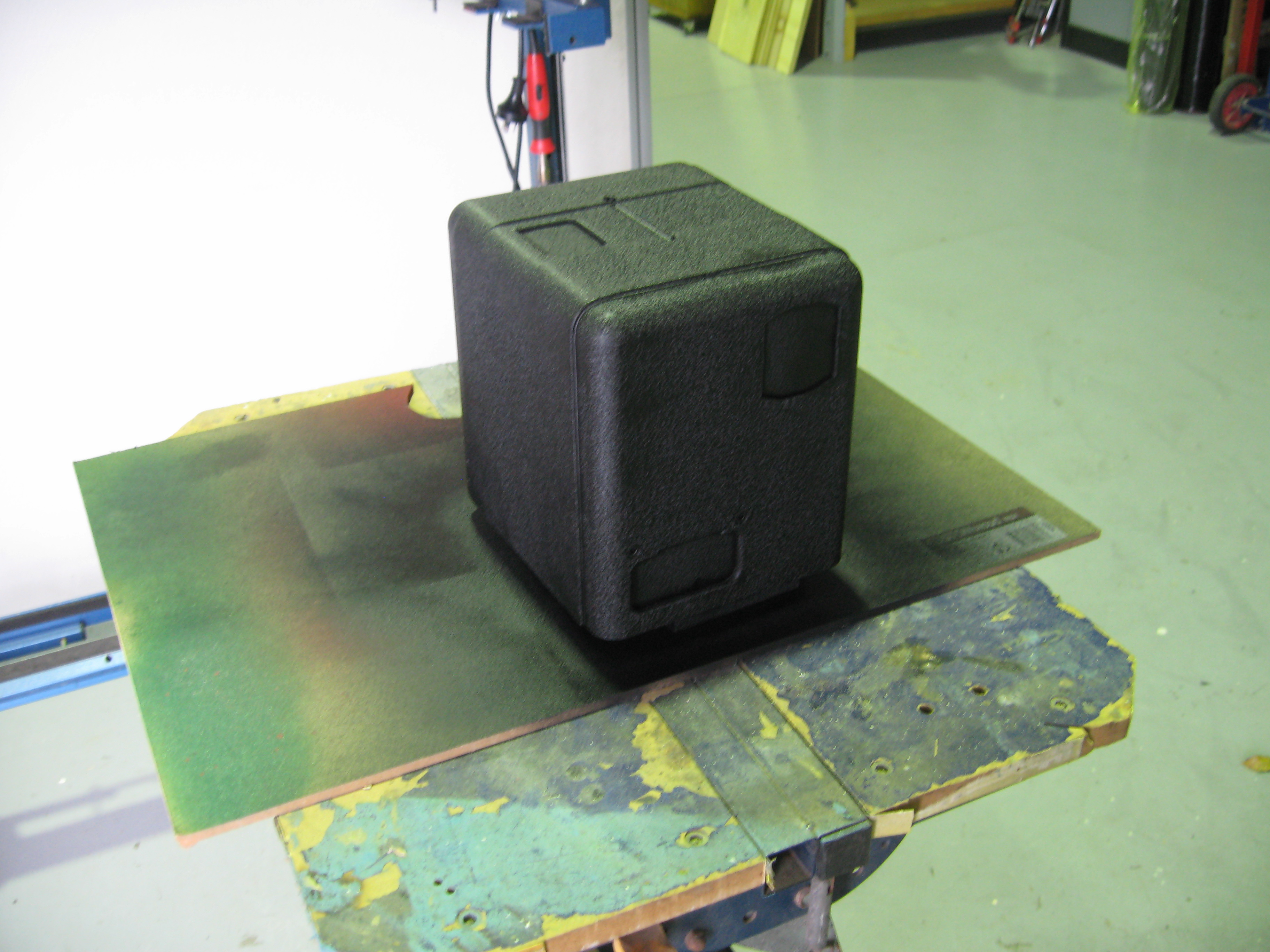

Postby integ194 » Sat Oct 24, 2020 12:18 am

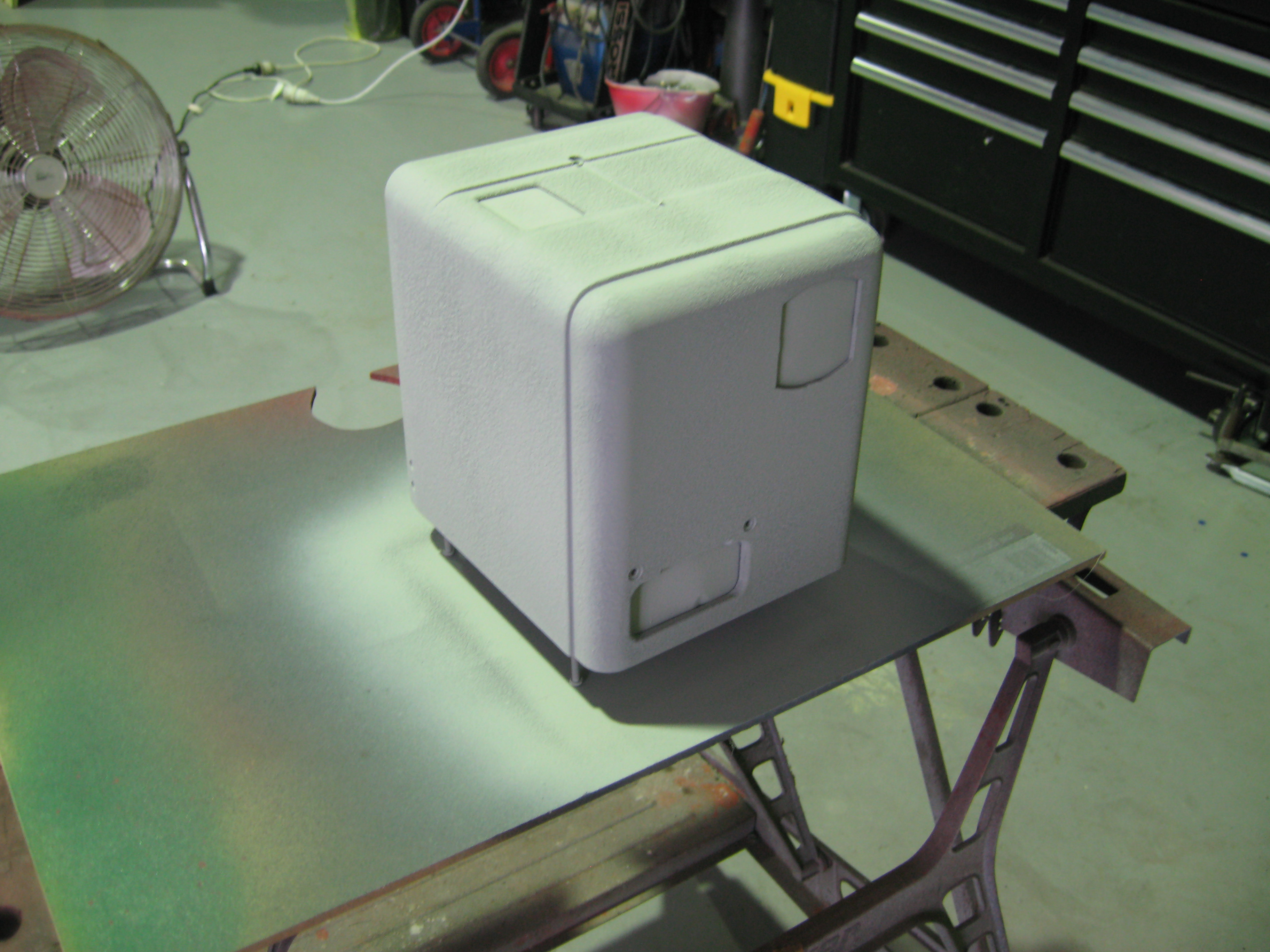

I have completed a test on a piece of cast alloy. This follows x3 coats(5 minute spacing) of VHT black wrinkle finish; after 48 hours grey primer; and a finish coat of green acrylic lacquer matched (my local auto panel beater) to the green inside the back door. I am very happy with result and will now proceed to refinish the complete housing.

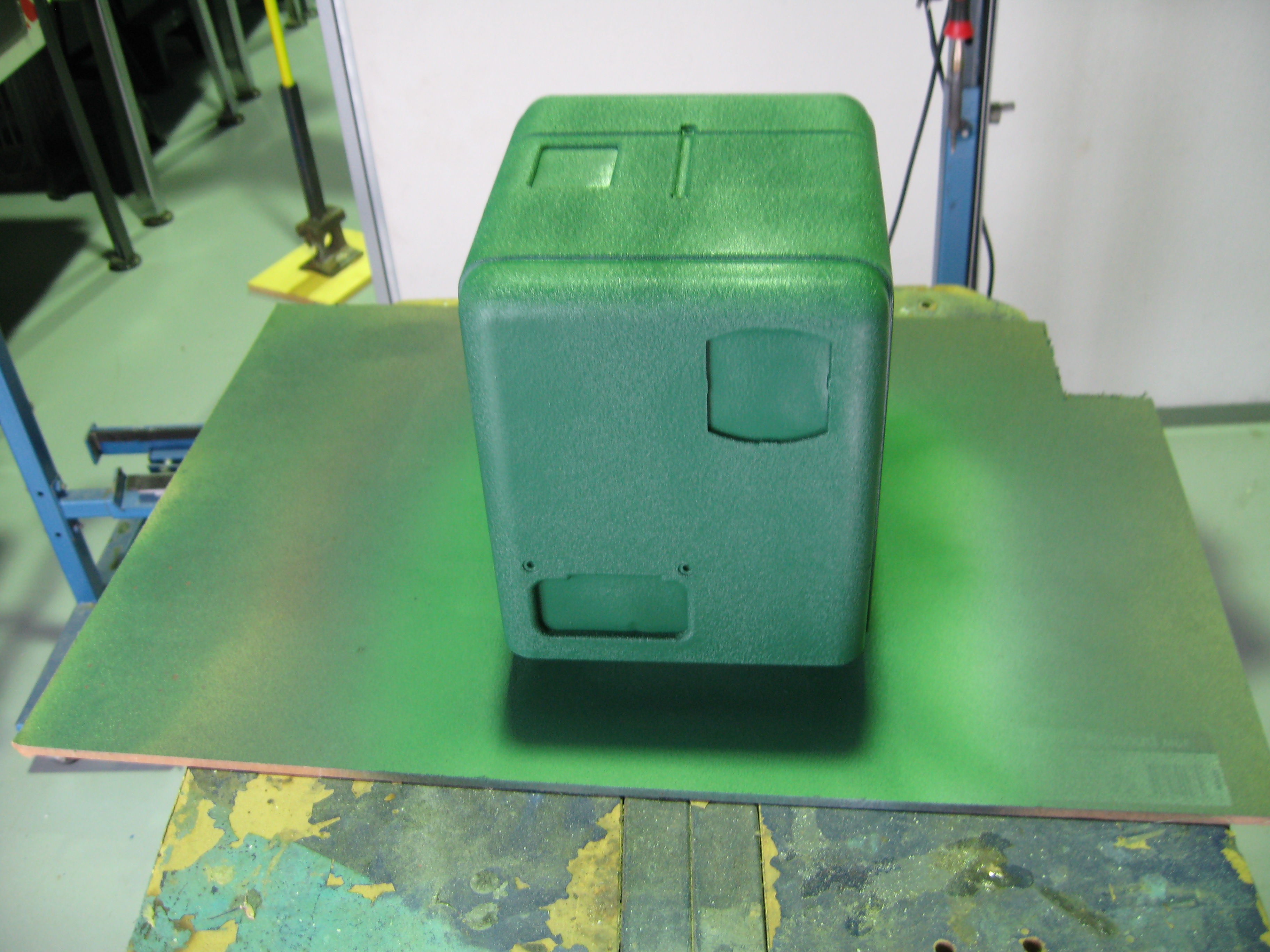

Postby integ194 » Wed Oct 28, 2020 3:58 pm
Completed refinish of the housing. Fairly happy with result although light seems to shadow the wrinkle finish in the pic. These pics reflect the black wrinkle base, primed and finally green finish. I will post further pics when resto complete.

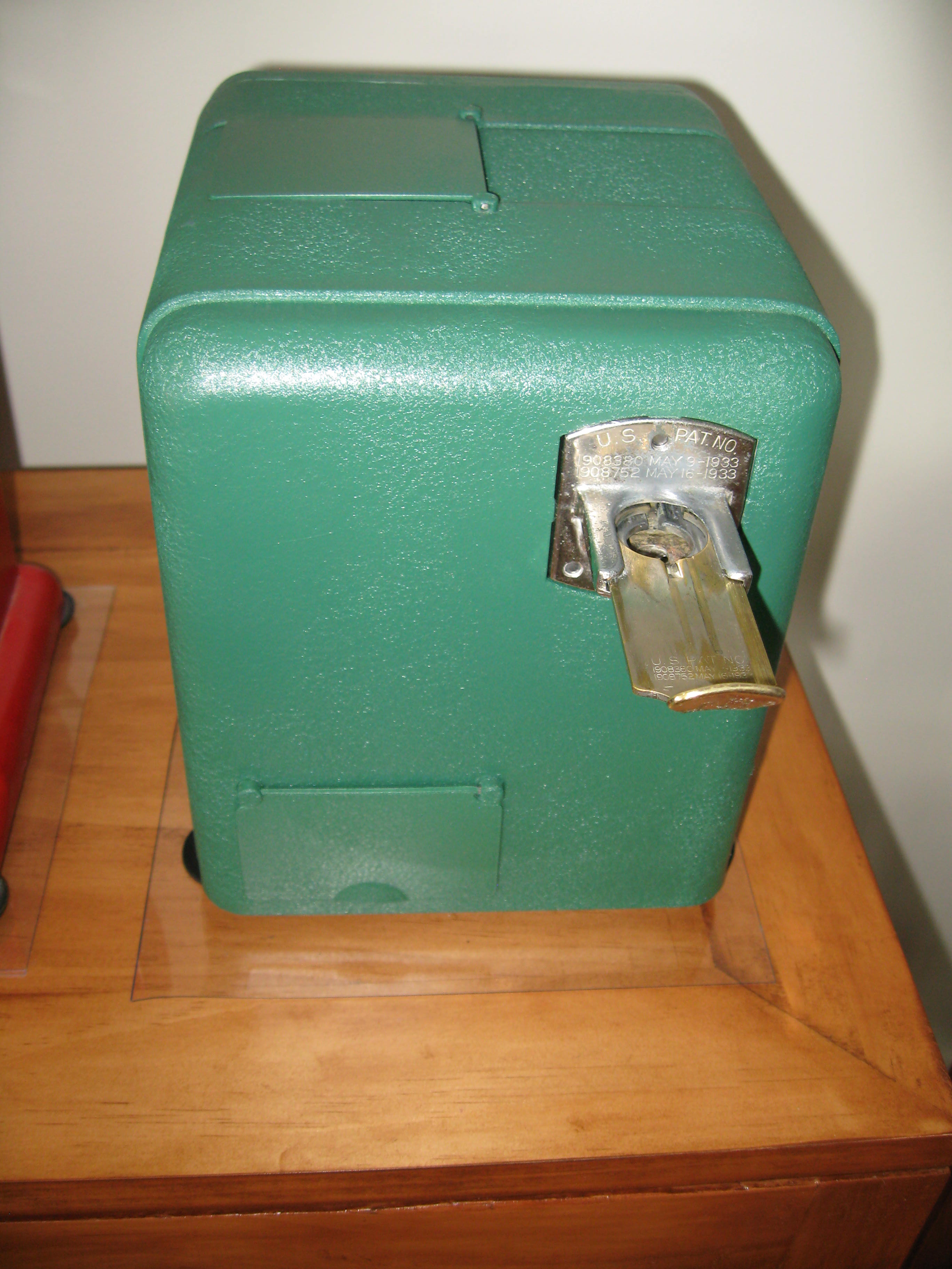

Postby integ194 » Wed Jan 20, 2021 4:01 am
Resto now complete
