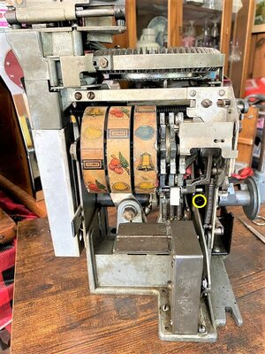

Postby Walter Newton » Mon Jun 14, 2021 4:56 am
mechanic wrote:MORE LIKE A ROLL PIN
You were spot on, even though I wasn't sure exactly where and what you were talking about.
And I just found it/saw it this morning.
But when I finally saw it, I understood everything you were saying.
It's a little brass or bronze pin, coming out of the bottom of the A-204 cam. It looks just like a cylinder pin from inside a lock. It floats in a hole.
I have no idea why Groetchen put it there, except maybe to prevent someone from giving the whole machine a good smack, knock, or tilting the whole case and mech.
Groetchen doesn't mention it on the parts manual or the operators instruction booklet (which is no surprise.)
Anyway ...
Now the mech is working and I need to put back some parts, especially the coin head, cause I removed some of it trying to find where this machine was jamming.
The mech is in good, clean shape for it's age, and it would have been a shame if I couldn't get it working.
Walter Newton

Can I bother you guys to post a picture of this thing--? I'd really like to know exactly where it is and how to remediate it, if I run into the same problem... thanking you in advance! :D
Re: Gluten for punishment - New Columbia
Postby Walter Newton » Mon Jun 14, 2021 2:40 pm
marsonion wrote:
Anyway ...
Further inspection, it's a roll-pin holding two steel plates together. I suspect pressure on the two plates eventually stressed the roll-pin, in turn, decreasing it's diameter and allowing it to float inside the hole.
I pushed the roll-pin back in, hard, with a dental pick with a curved tip, and even then, it was a tight place to operate.
I was thinking of putting a small dab of liquid steel in the hole, but I did some trail runs, and there is no way to operated in that tight spot.
So, I'm leaving it alone, if it stays, fine, if it doesn't, I guess I will have to push it back in.
You would have to dismantle half the mechanism to get to it.
Hard to see in the picture, click on the pic and enlarge it. It's on the right side of that yellow circle.
