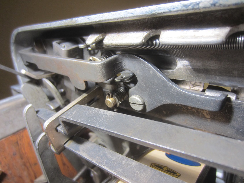

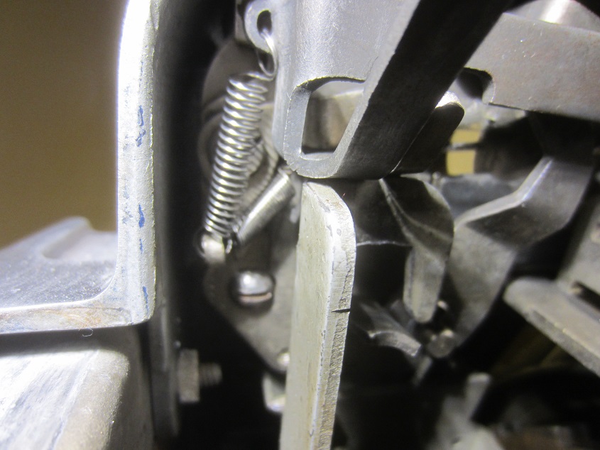

your welcome, Spring attaches to same anchor as the coin advancing locking lever bar which I see in you have in that first picture, make sure the part comes with spring and the shoulder bolt.

I am going to guess that the anchor you mention, already has a spring attached?

Re: Missing screw on Mills?
Postby Bally Bill » Sun Mar 27, 2022 2:06 pm
hopefully you find the part with the spring included but you could possibly find both on the forum or on the BAY website.

Postby wildman » Sun Mar 27, 2022 2:19 pm
I probably did not word my last response correctly.
The part I have ordered has a spring.
I was guessing it should attach to the same place as an existing spring

Postby Bally Bill » Sun Mar 27, 2022 2:28 pm
yes on the anchor attached to the escalator
