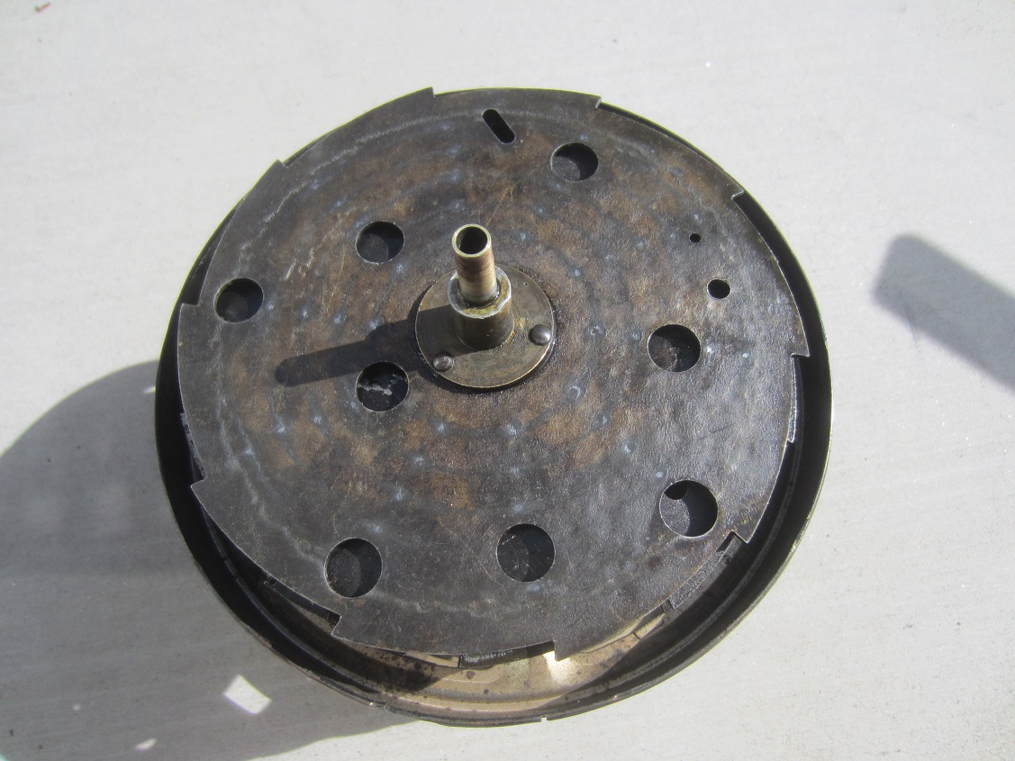

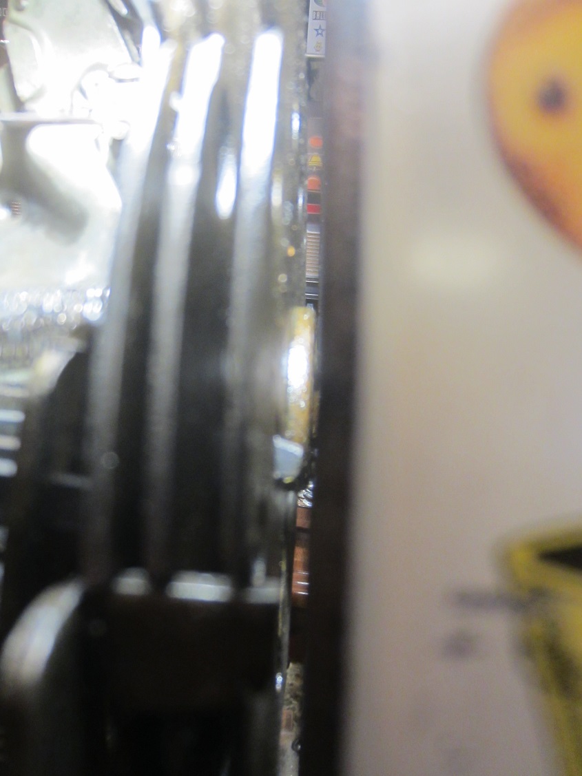

Postby Bally Bill » Sat Apr 23, 2022 5:29 am
correct me if I'am wrong but the reels themselves should have 10 holes with stop notches and 10 symbols per reel strip so none of these strips are correct because the 3 reels have 20 symbols each. If anyone has a side view picture of a 10-stop reel that would be helpful!

Postby watlingboy » Sat Apr 23, 2022 6:33 am
All reel strips have 20 symbols. A 20 stop machine will stop on all 20. A ten stop machine will only stop on the 10 even numbered symbols. The odd numbered symbols mean nothing because the mech never stops on them. The stopping is determined by the star wheel that is beside each reel. A 10 stop will have only 10 spaces for the reel to stop, the 20 stop will have 20 spaces.

Postby Bally Bill » Sat Apr 23, 2022 1:08 pm
Hi Geroge, Thank you for that information and once again I"am learning something new in this slot machine hobby which keeps my mind sharp! Now just have to figure out the correct reel strips from Rick frinks catalog but I think the standard 10 stop is going to be the correct version I will try.
