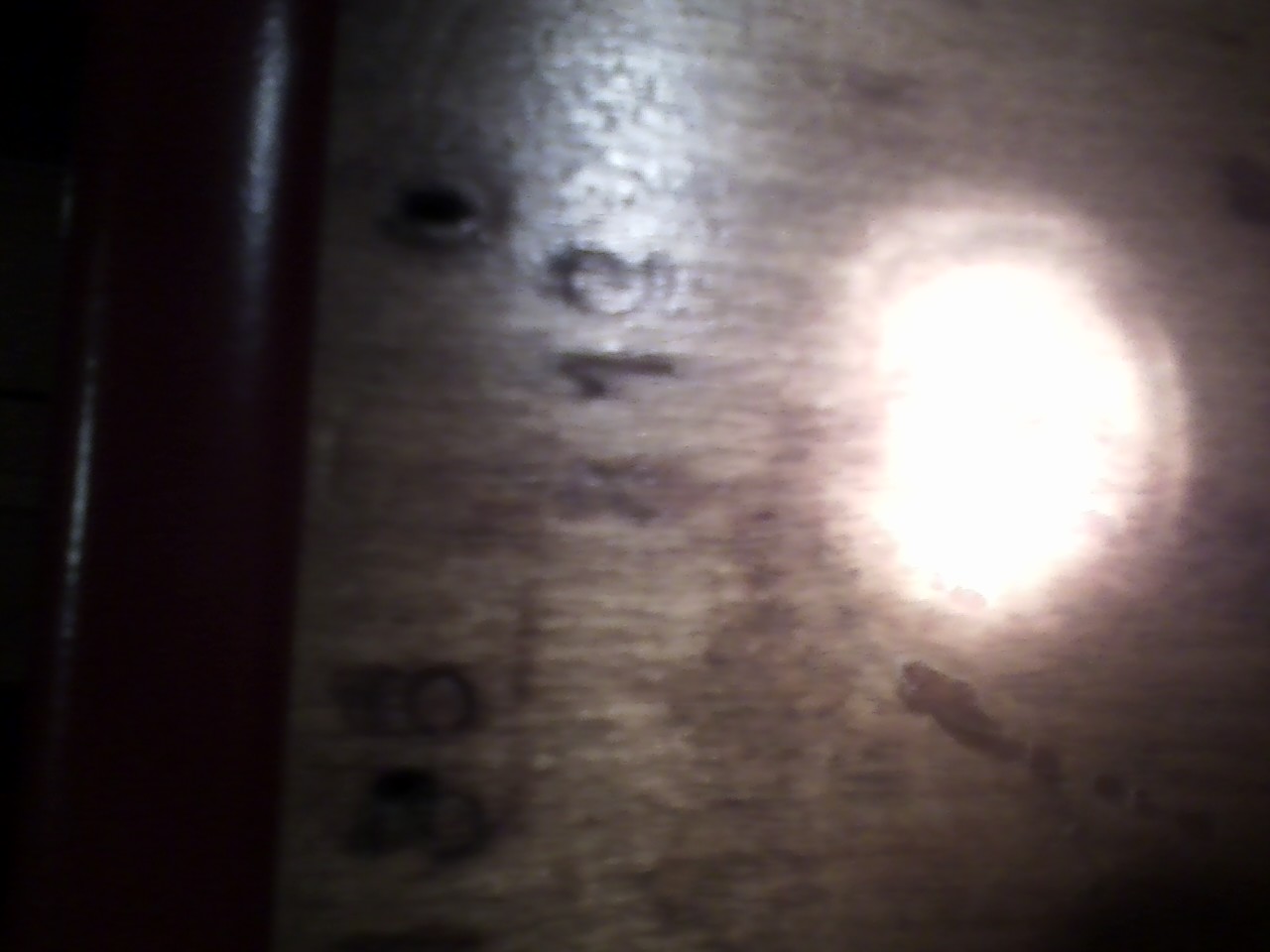

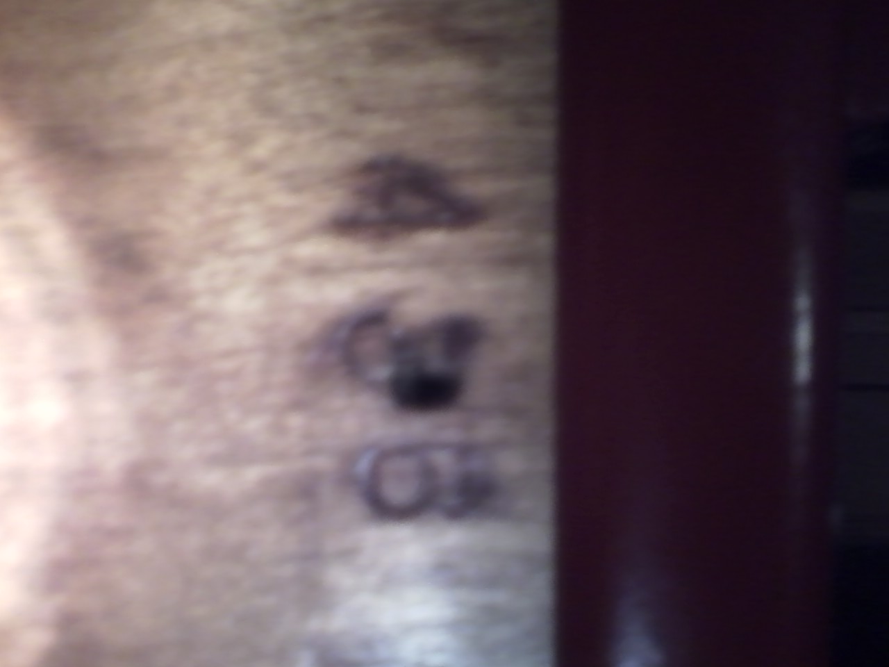

Three pictures are attached. On the top handle side is the number 436. Not too far below it is the number 712 or maybe 612. Along the base is the number 92436. What do these numbers mean? I will pop the pin out like you said. I can't tell yet if there are any rubber seals inside of the hydraulic regulator? If so, does the black fluid mean that the rubber has deteriorated. I used to see deteriorated rubber on all VW bug hydraulic wheel cylinders but I have no idea what is going on here. Thank you for your wonderful input.
Cabinet base 92436
Either 712 or 612
Number 436

Regecon wrote:Three pictures are attached. On the top handle side is the number 436. Not too far below it is the number 712 or maybe 612. Along the base is the number 92436. What do these numbers mean? I will pop the pin out like you said. I can't tell yet if there are any rubber seals inside of the hydraulic regulator? If so, does the black fluid mean that the rubber has deteriorated. I used to see deteriorated rubber on all VW bug hydraulic wheel cylinders but I have no idea what is going on here. Thank you for your wonderful input.
From the base, we get the cabinet serial number for the Cadet that it originally was from the factory. From the mech pics you previously posted, we find a partially obscured mech serial number from the factory (look to the bottom left edge of the frame from the rear), a number ending in ...512. This indicates that the "carpet doesn't match the curtains" and that the mech may well have originally come from a Commander, as I suspected in an earlier post. I think your pump originally may have come from a Dough-Boy or earlier model, but at any rate I'm pretty sure it wasn't originally associated with this particular mech.
The three-digit numbers burned into the wood are part of another Scooby Mystery I've been trying to run down for years. More on that later, after I wake up. #-o

Oh yeah, the three-digit numbers burned into the cabinet side... here's what I think it might be all about. On another thread, forum member mechanic wrote:
I did some research on the Knockout machines, what I found is Caille Bros sold out to Fuller Johnson Co in 1932 but kept the name and one of the bros as Pres.. The intro of the new art deco models were a hit till the pumps started having problem and then the AC Multibell flop. This was all in 1938-39. The Knockout was to be the next for the 1939 model year, however, A. Caille was in the process of selling the company. In the latter part of 39 early spring of 40 the remainder of all machines approx 2000+ plus all surplus parts were sold------ to------- Buckley Mfg. Co. they in turn finished completing all remaining Caille machines using the surplus parts and any missing parts were hand fabricated with materials on hand. This continued well into 1944 when all machines and parts were exhausted. It seems that if the company was being sold about the time the Knockout model was to be released, it probably was not put into production. It also explains why you have found machines that look like someone slapped some aluminum siding on it. Those machines may be actually Buckleys.
viewtopic.php?f=6&t=1277
I haven't been able to turn up the source of mechanic's information, but I have no reason to doubt his story. Two of the Caille machines in my collection have these burned-in numbers on them, and they are both "monsters," i.e. made up of mix-and-match cabinet and mech parts from different models. The more interesting of these monsters looks like the ad illustration for a Knockout... it has the number "814" burned into it with exactly the same sort of fonts or dies used to brand yours. It also had a Mills (or Buckley--?) style club handle very cleanly grafted to it! Now, I thought this must've been done by the same person who had house-painted the cabinet blue and made several bailing-wire *ahem* "fixes" to the mech, and when I restored the cabinet to its original color scheme, I also located a Knockout-looking handle and put the Mills handle on a shelf. Several months ago I was moving some stuff and noticed that that handle hardware has the number "814" scrawled across it in orange crayon. That same scrawl can be found on the inside of a couple of other cabinet castings on the thing. I speculate that this machine was assembled on the Buckley floor as mechanic describes, and the 3-digit numbers are the floor serial codes for these monsters. I'm also thinking of reconnecting that Mills handle to the machine, to make it more *ahem* "original." #-o
Your burned-in codes coincide (imperfectly but suspiciously) with the last three digits of the cabinet and mech, respectively. Now, since it appears that you have a Cadet with the guts of a Commander and the heart of a Doughboy :D , the question is, who played Dr. Frankenstein in this scenario--?
I suspect Old Man Buckley.

Postby Regecon » Wed Feb 22, 2017 6:26 pm
The number at the bottom left side of the base is 91812. It appears that the second set of numbers on the wood side could easily be 812. Does that help in any way?

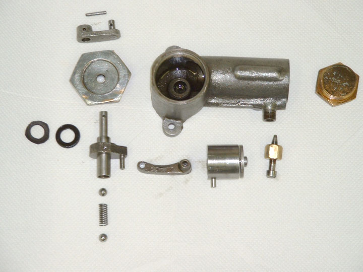

Next I tried to knock out the pin using a nail punch so that I would not smash the head of the pin but the pin would not move. But as careful as I was, I ended up smashing the head of the pin. Would you recommend that I heat up the shaft so that the metal expands around the pin or would you recommend that I drill out the center of the pin with a fine tipped drill bit? Can these pins be replaced with new pins at hardware stores?
The end of the piston has a screw at the end. What happens after I unscrew the screw? Is there a rubber seal or what?

Postby marsonion » Wed Feb 22, 2017 8:39 pm
Regecon wrote:The number at the bottom left side of the base is 91812. It appears that the second set of numbers on the wood side could easily be 812. Does that help in any way?

Maybe we should move this discussion to PM to avoid boring-to-death the casual forum browsers; as usual, I have more questions than answers, but I'll try:
1) Two different serial numbers on the edge of the cabinet base of a Cadet--? Never seen that, but I probably shouldn't be surprised. No idea whether that's meaningful or not. Posting a couple of pics of my (confusing) Cadet serial number locations.

3) The screw at the top of the piston is a shoulder screw. Don't lose it! It retains a washer-like cap on the piston which acts like a valve during operation. Think about it and you'll see why this is so. No, there is/was no seal nor sealant associated with those parts so far as I know.
