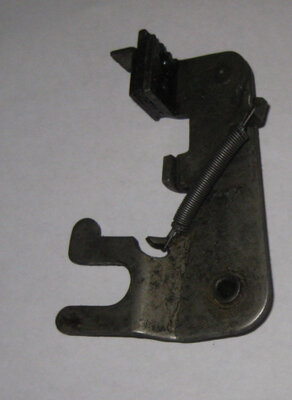

It seems like the reel kicker might not be spinning the gears well. I have an older style kicker (as pictured- this one isn’t mine, just an example).

The tip of your reel kicker might be worn out or yours is the wrong one .

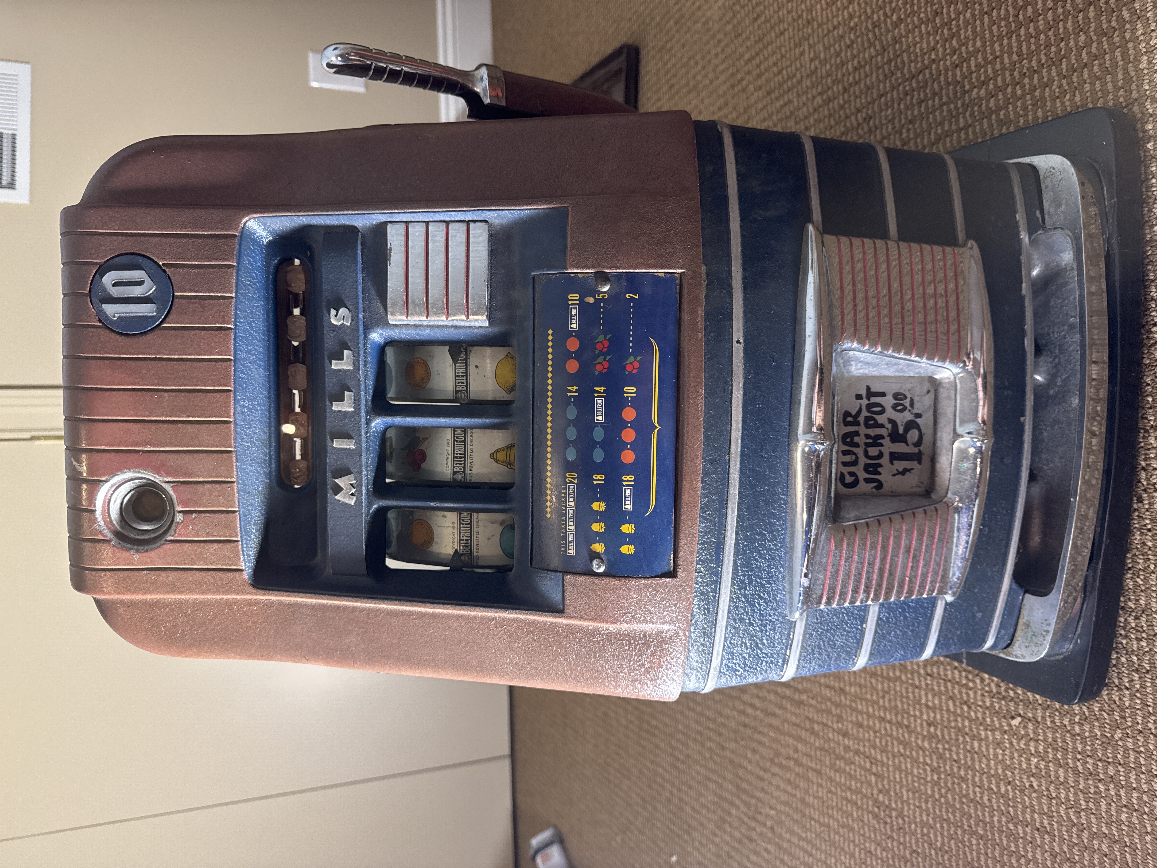

Here is a photo. Clearly I have a lot to learn about this machine.

Postby jmisatu » Mon Aug 04, 2025 9:26 pm
Mills hi-top circa 1948. Also, good one Patrick(Marsonion).

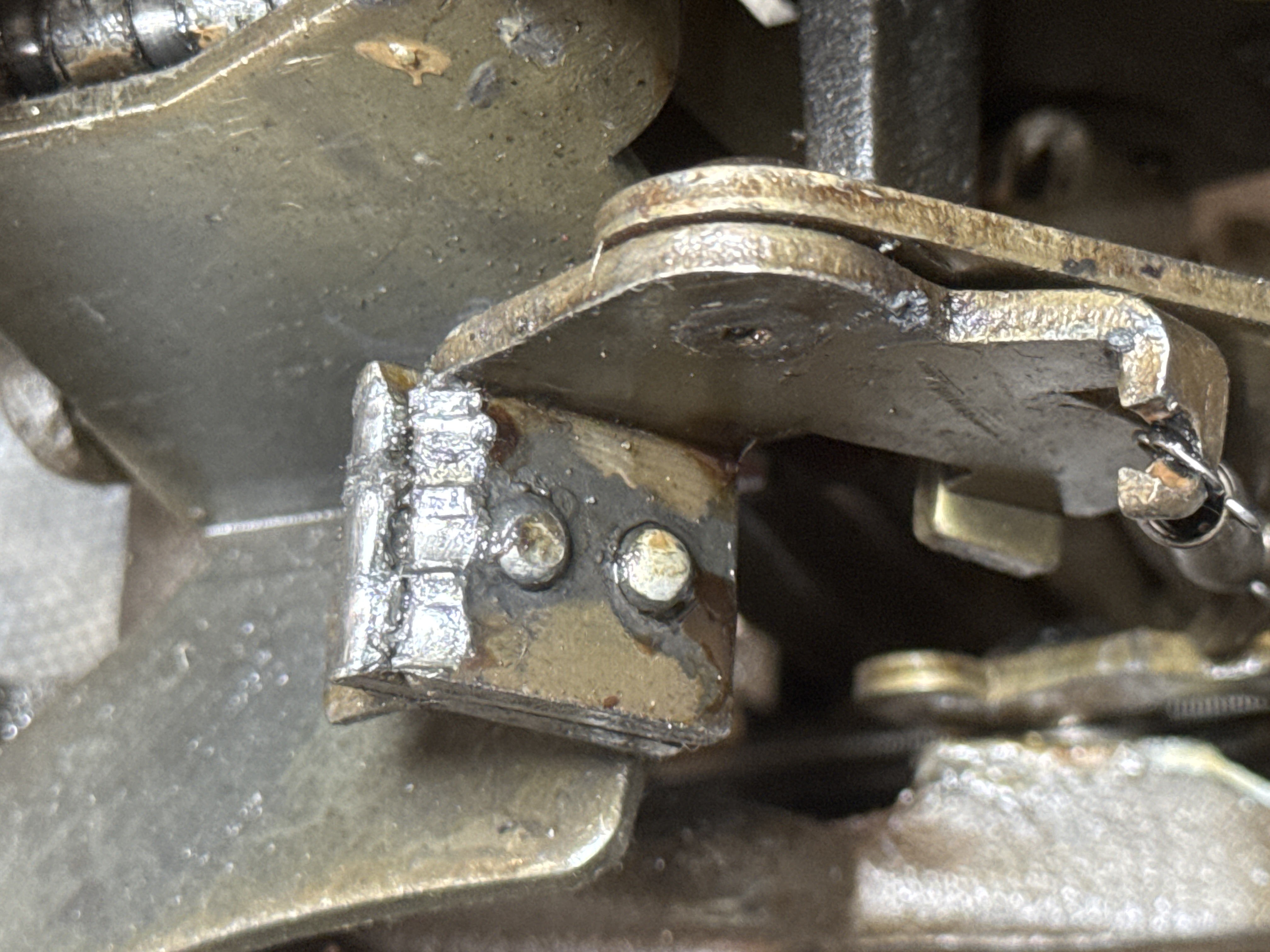

Here is the reel kicker. Looks to me like it’s got 3 deep grooves where it contacts the three gears. Seems like this might be the problem?

Postby radiorich123 » Wed Aug 06, 2025 11:38 am
That should be replaced !

jmisatu wrote:Mills hi-top circa 1948. Also, good one Patrick(Marsonion).
Thanks, Jim-- and certainly, this is a Jewel Bell, one of the earliest Hi-Tops (debuted February 1947, according to Bueschel) and it appears to be in its original navy blue and maroon color scheme...
BTW I didn't mean to be snarky nor to embarrass our new member Sigmund35 (Welcome!); he's after information on what he's got, and this ought to be the right place. I wish I could assure him that researching vintage slots is straightforward and easy, but it ain't: part numbers, serial numbers, production dates... it's all clear as mud, and it doesn't help that there's also so much (presumably inadvertent) misinformation circulating "out there."
Sigmund35: Yup, that looks like a pretty worn-out kicker! :(
