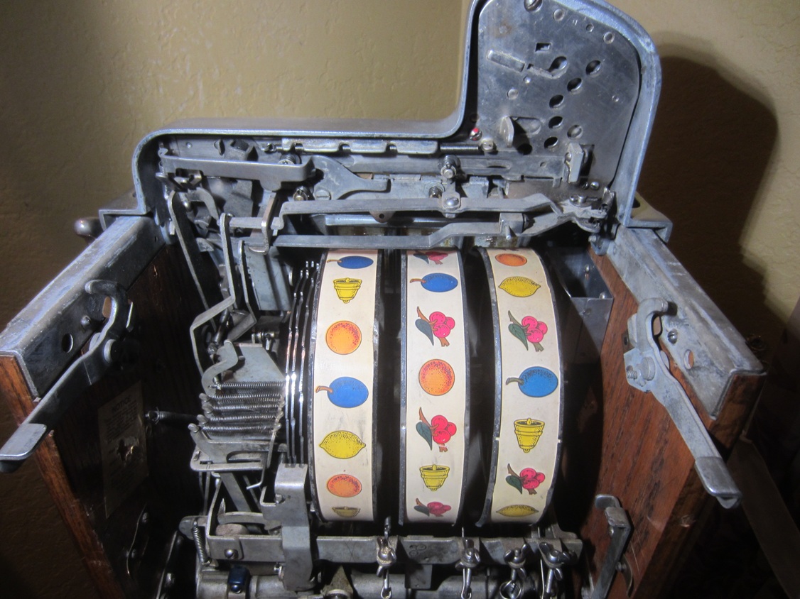

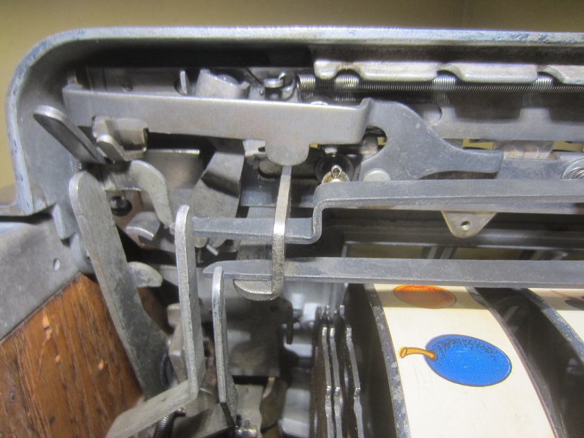

Hello I think if you post a picture of the entire escalator/mech in the case maybe we can identify your issue, here is a few pictures of a working setup in a mills castle
Bally Bill
Posts: 118

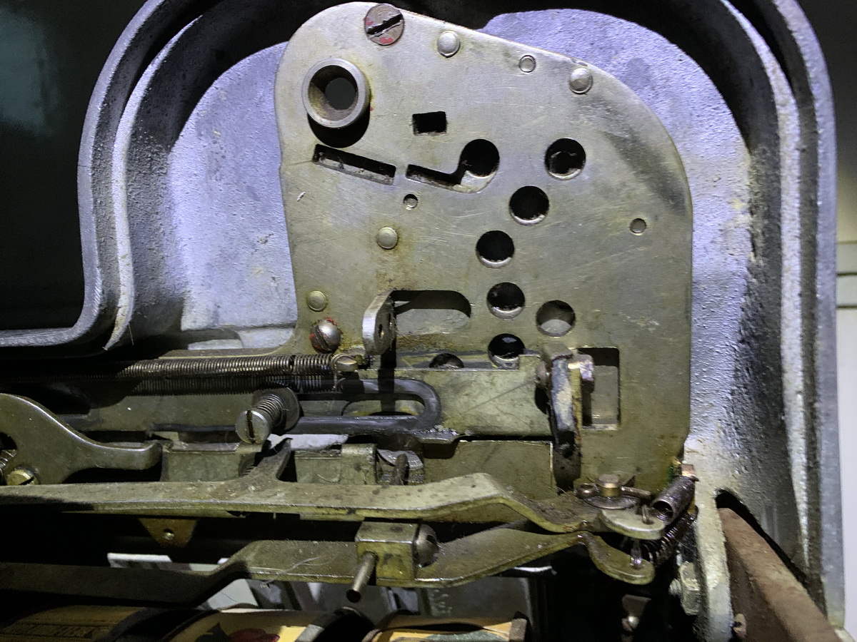

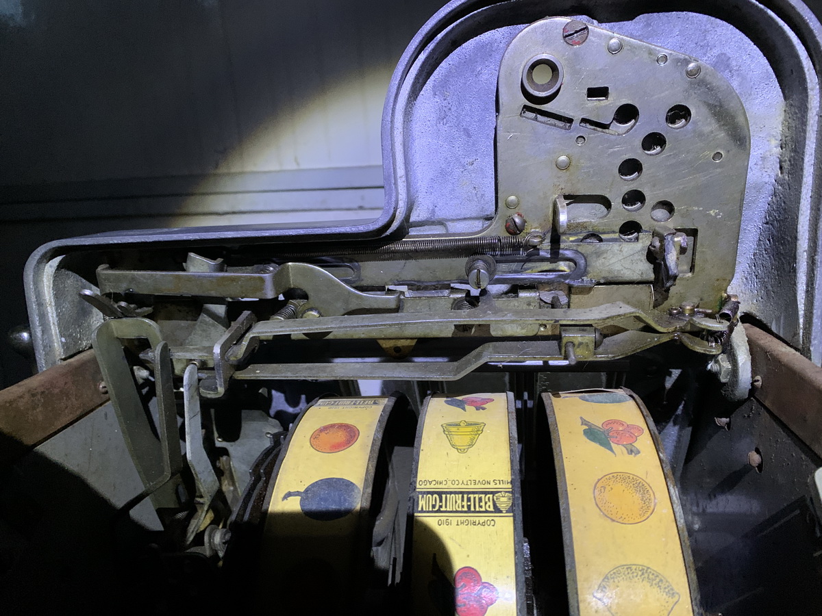

Postby LotusGuy » Thu Dec 18, 2025 4:04 pm

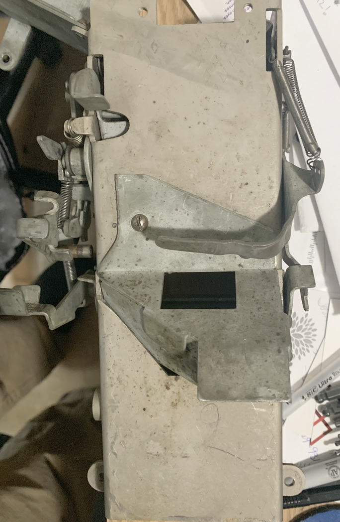

It was cold and dark last night, but here are three pics of the escalator.
LotusGuy
Posts: 28
Joined: Thu Sep 18, 2025 8:15 am

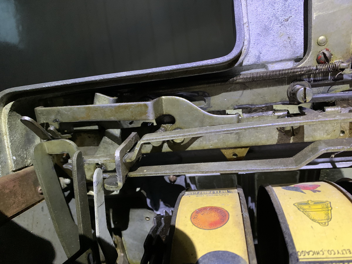

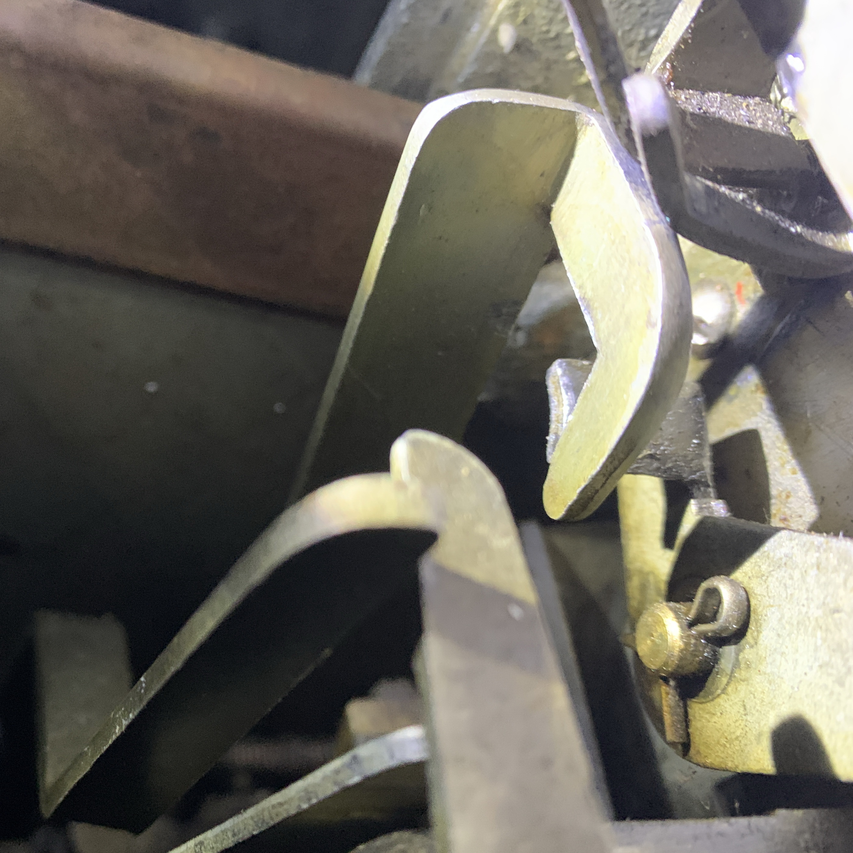

Re: Coin advance not working

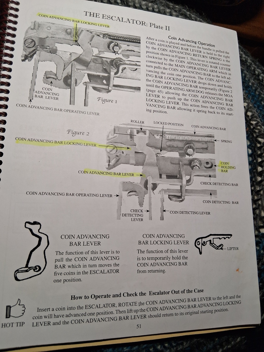

Postby Bally Bill » Thu Dec 18, 2025 8:00 pm
ok that helps, your free play is caused by the check detecting arm being pushed too far back and will affect the coin advancing bar lever. The coin advancing bar locking lever looks like its bent upward too much and should be flat then the tip bent up.
Bally Bill
Posts: 118

Postby LotusGuy » Thu Dec 18, 2025 10:28 pm
Thank you Sir! when the sunlight returns tomorrow, I’ll look over that lever

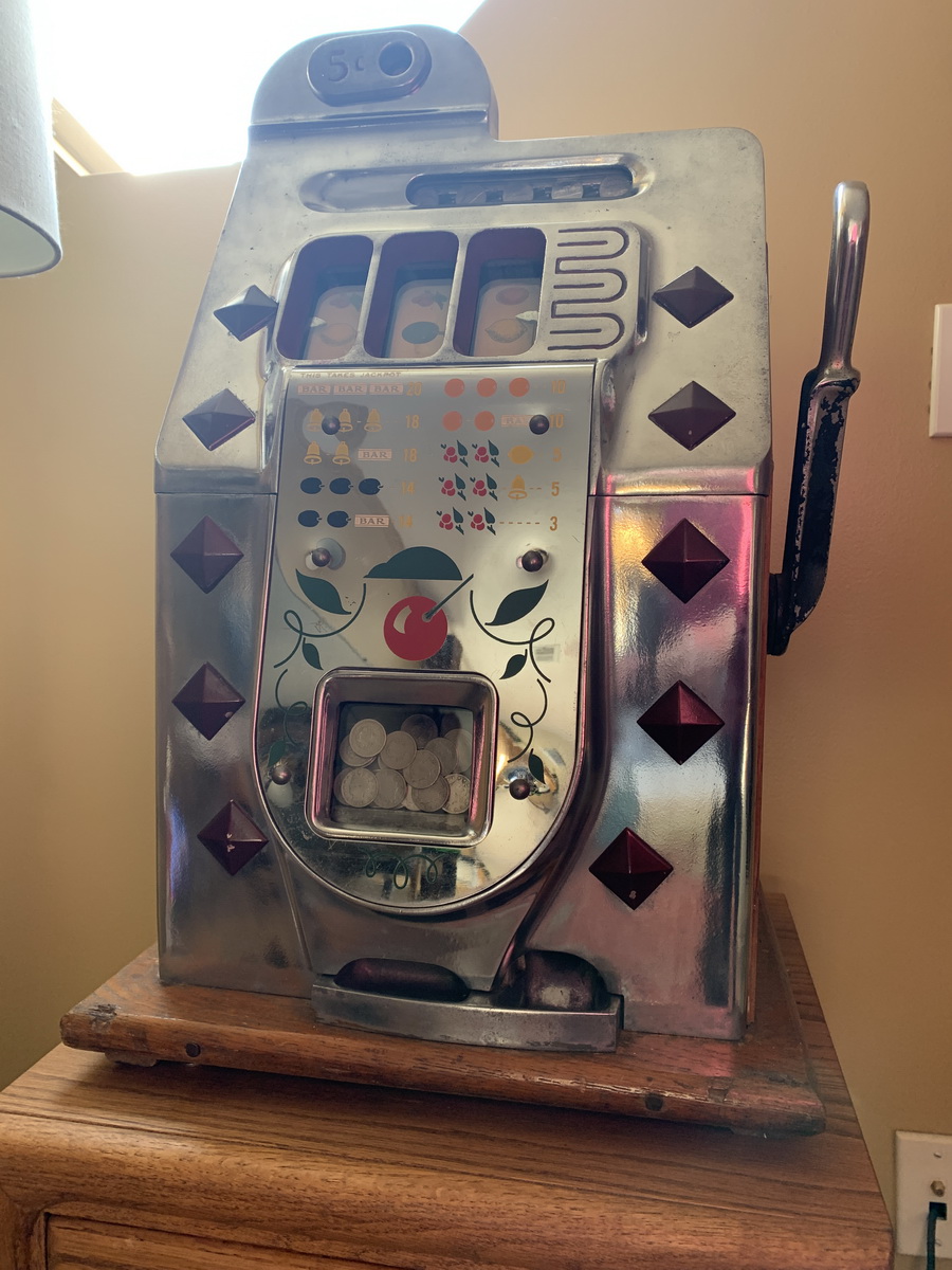

Here is what the machine looks like today with a replaced OEM old stock bib:
