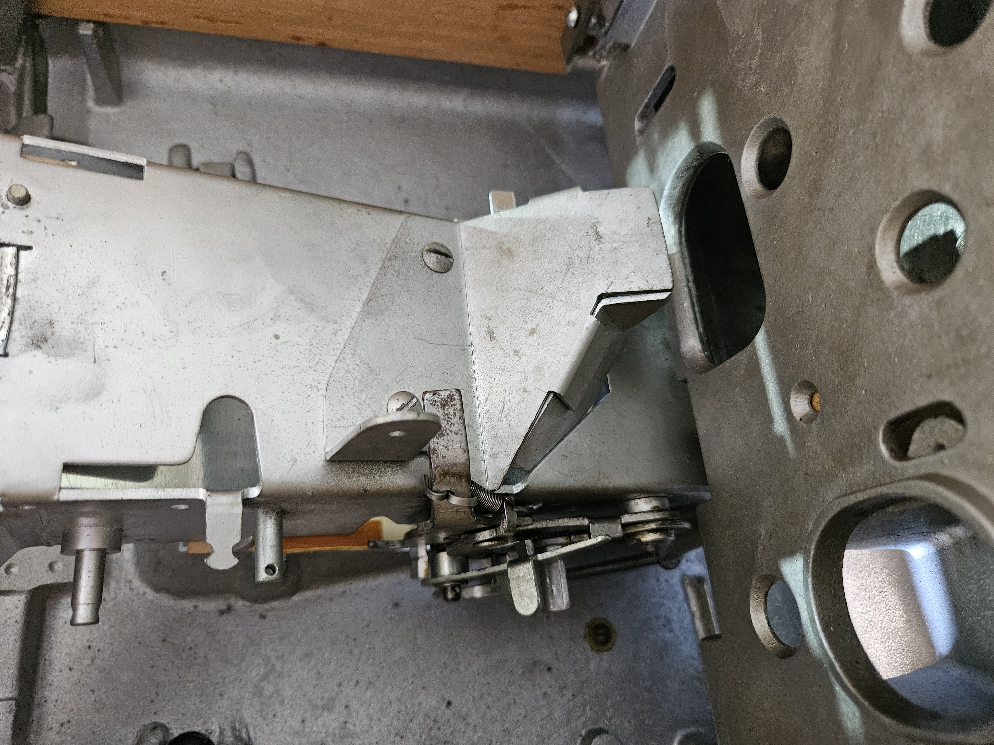

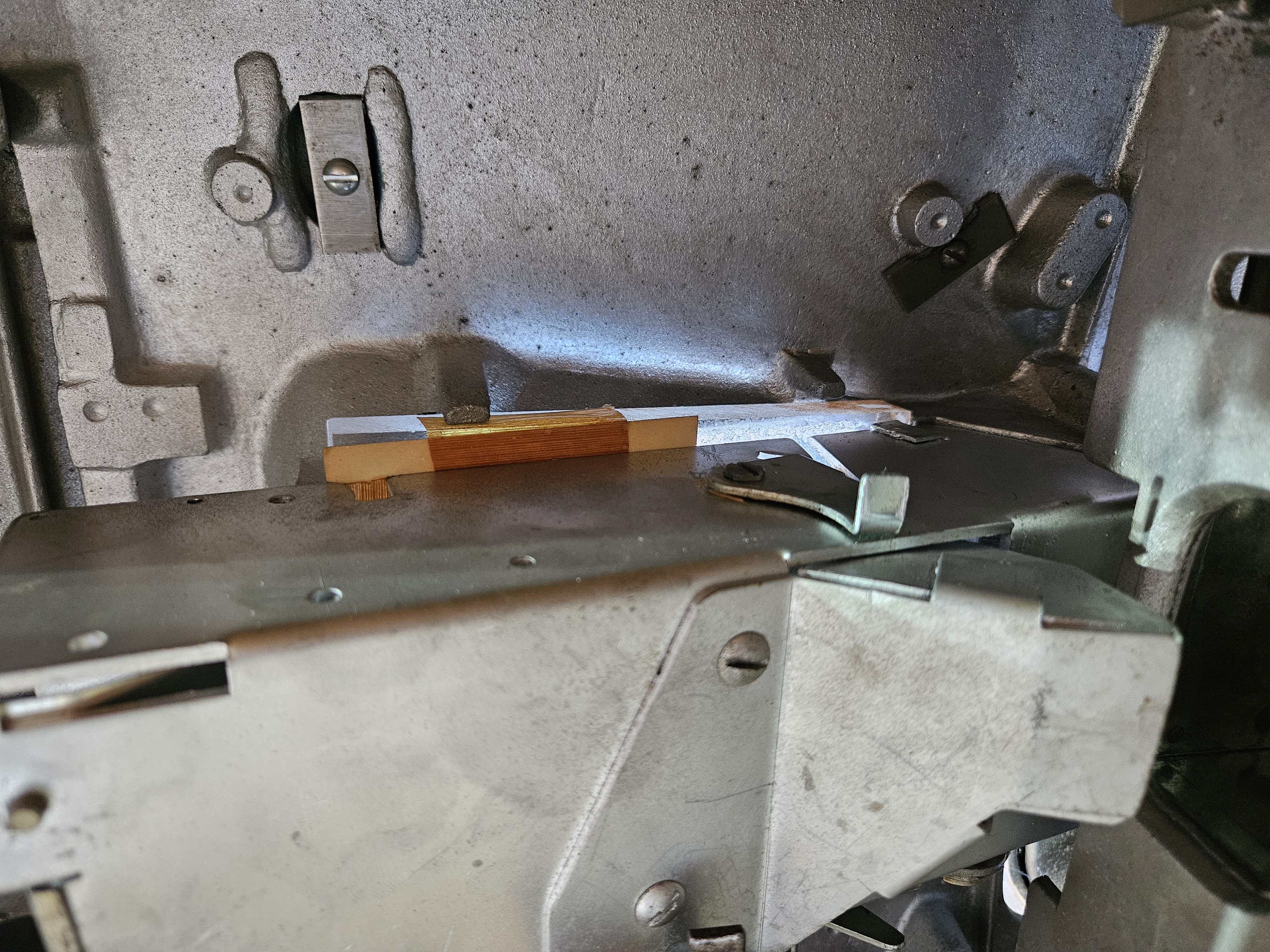

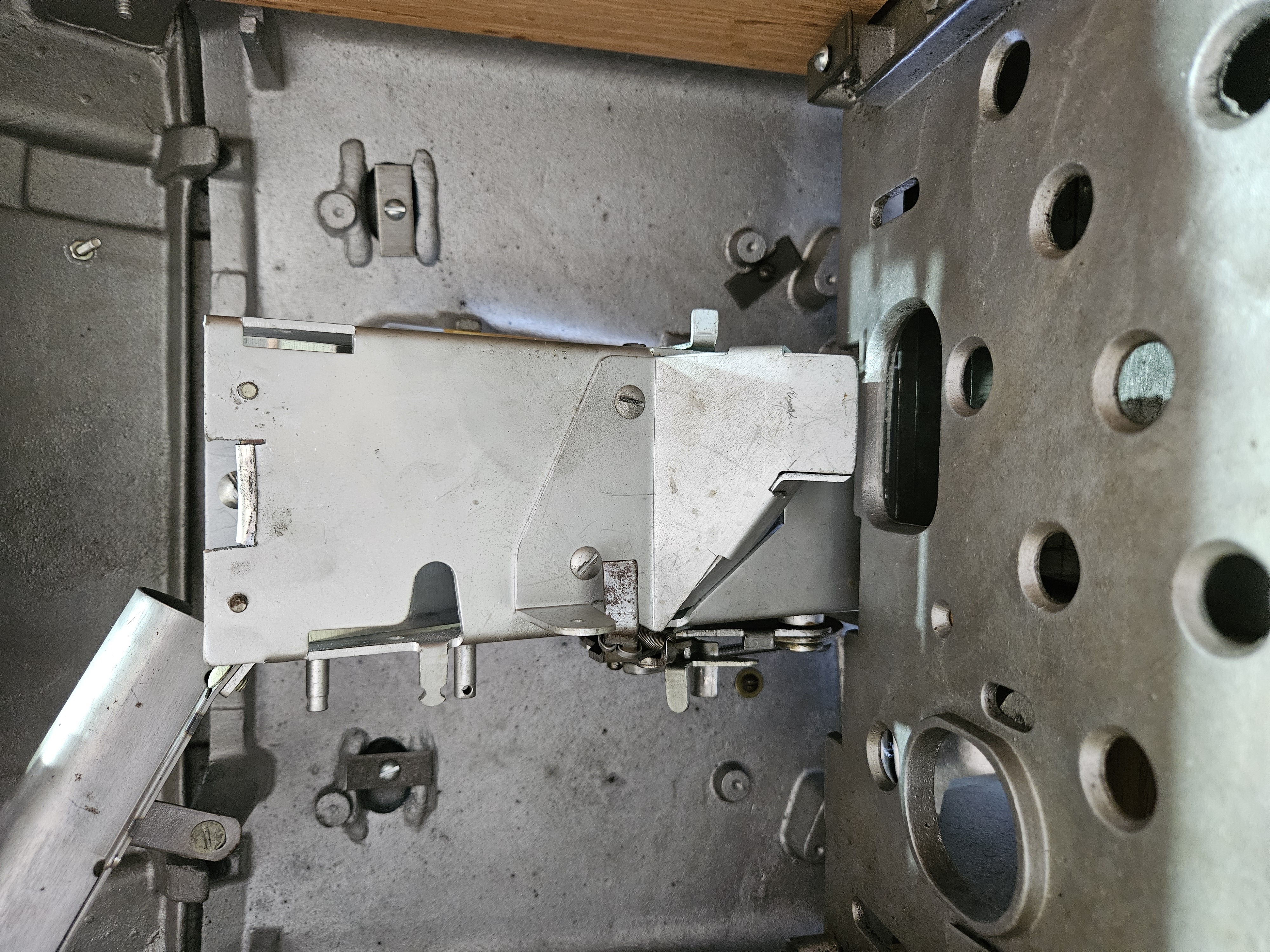

Postby Marine6619 » Fri Feb 27, 2026 11:20 am

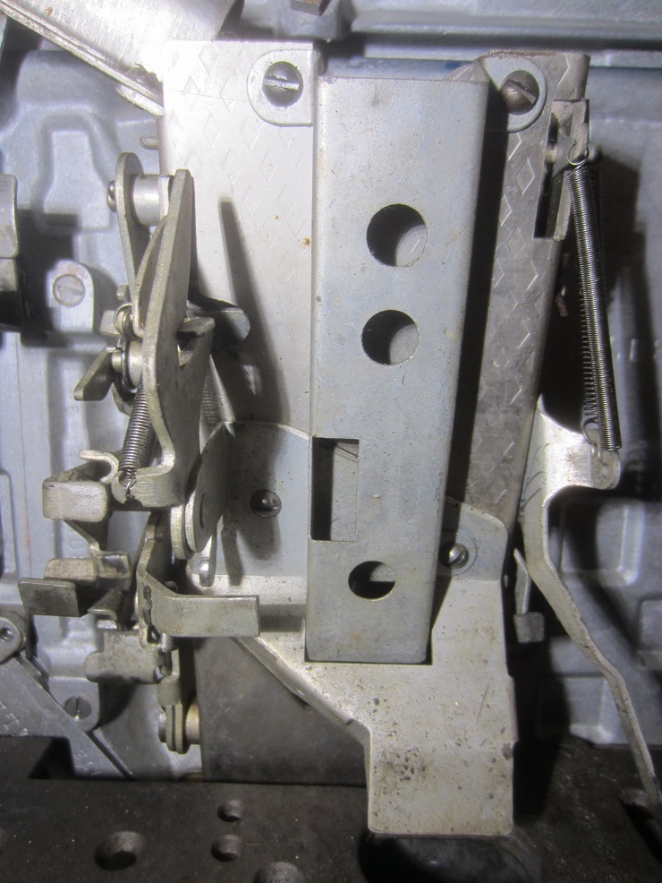

I have Mills 25 Cent machine that is a reproduction (or so I am told). The jackpot never pays off. In looking at the inside of the machine it appears that there may be parts missing. Can someone verify this by looking at the attached pictures. Also I believe it the jackpot is lever actuated. If missing parts are the problem, does anyone know where I can obtain the needed parts?
Thank You,
Dan

Re: Mills 25 Cent Jackpot Parts
Postby jmisatu » Fri Feb 27, 2026 11:57 am
You seem to basically need a whole jackpot due to so many missing parts. Get a repair manual online and look at pictures of what it is supposed to look like.

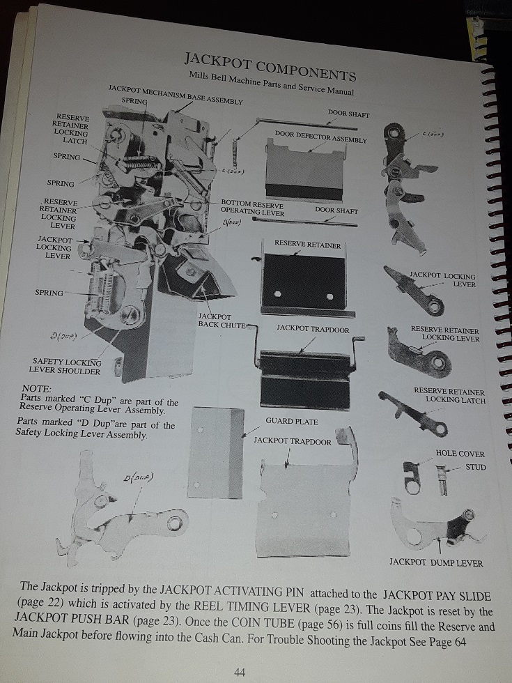

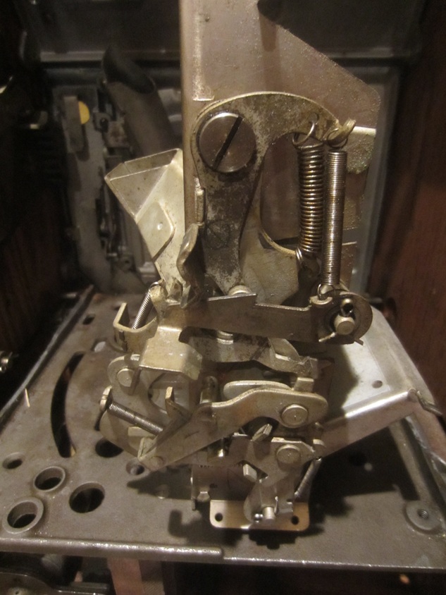

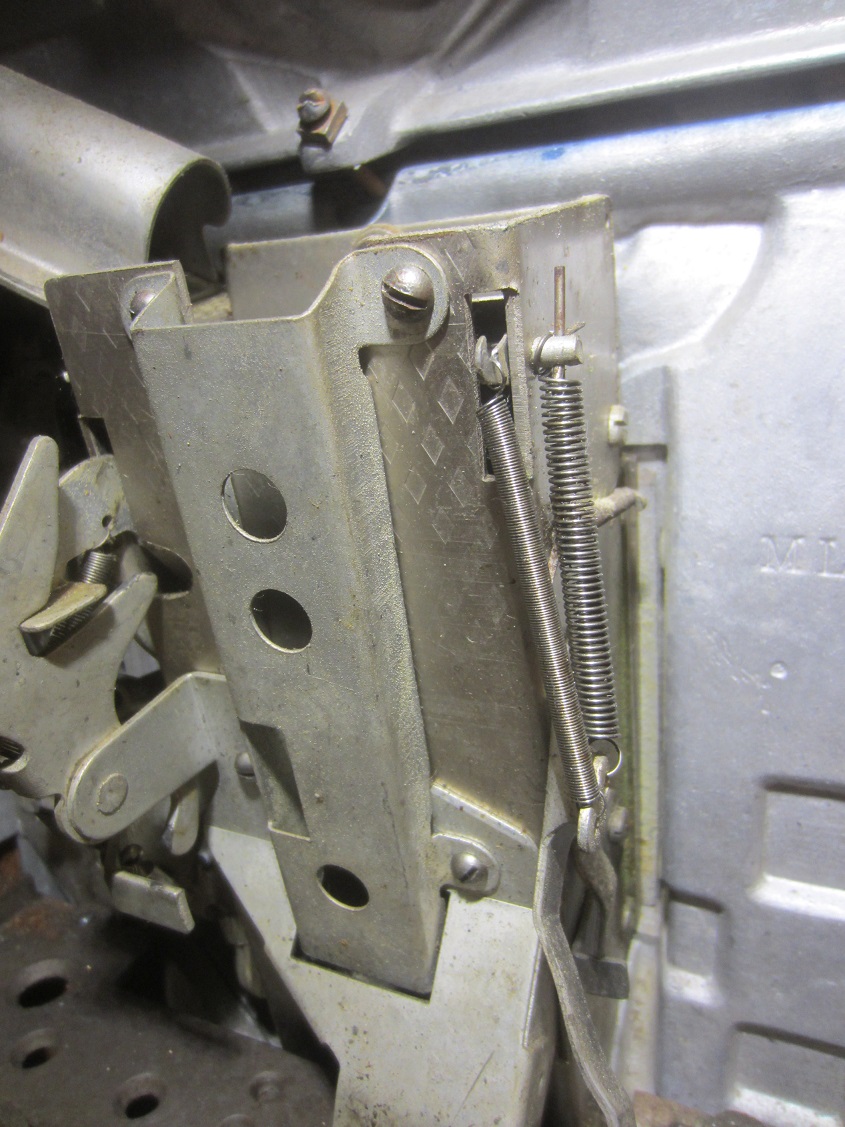

Postby Bally Bill » Sat Feb 28, 2026 9:56 pm
Hello Hopefully this helps solves the mystery-Ebay has 2 right now
Postby Marine6619 » Sun Mar 01, 2026 9:20 am
Thank you for the info! I plan to purchase a manual on-line.
