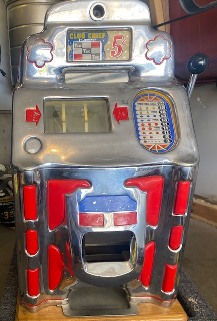

The lore is that my dad acquired this nickel Club Chief (Tic-Tac-Toe) in 1950, after the Montana Supreme Court ruled slots unconstitutional, but before it could be confiscated and destroyed. Matching numbers on mech and cabinet. It's been in an attic for decades (protected by a plaid dust-cover). Now, with a little lube and loosening of the reel brakes, it runs well, and pays out.

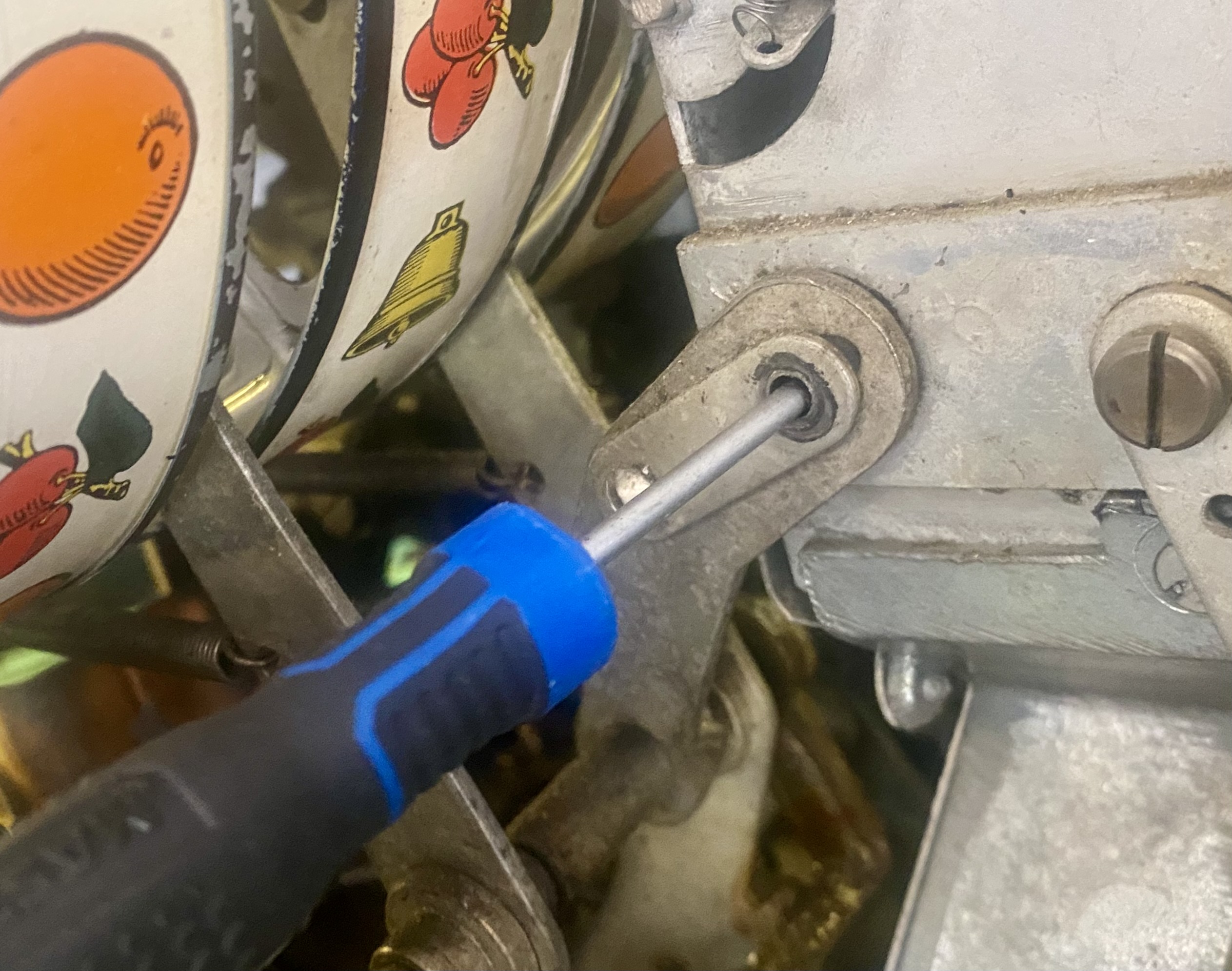

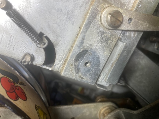

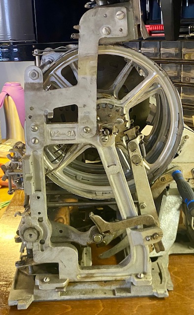

As shown in the pics, it is missing a machine screw. Anyone know the thread specs?

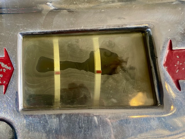

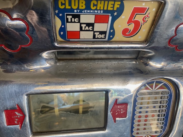

The cabinet is also in good shape, though the pay/reel window has something going on. What are your suggestions for cleaning the exterior, while preserving the patina?

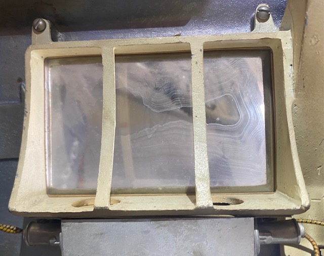

front of reel display glass V8-23
back of reel display glass V8-23

Postby memphisbigdave » Sat Jul 18, 2026 4:46 am
The little window is delaminated. It’s a glass sandwich with plastic in between. You can take it apart or replace it with plain glass. You can take apart the light sockets and clean and replace them or replace the whole thing with LEDs

Thanks, BigDave. I'll try that. Any suggestions on the cleanup of the exterior?

Simichrome metal polish

Good tip on the simichrome, Big Dave. Tube should arrive today.

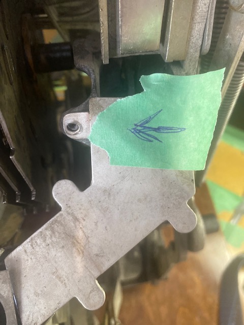

The missing screw on the JP looks to be a pan head #6 or #8 (32 TPI). It's the same screw that holds the cover of the coin tube.
missing screw hole
Can anyone confirm?

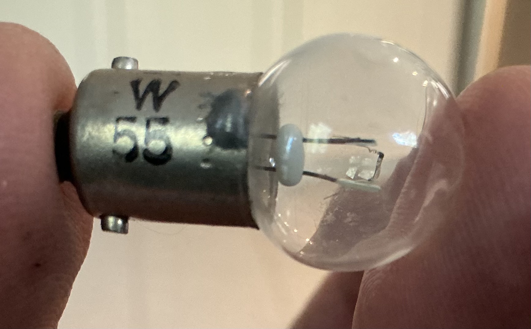

Anyone know of a supplier of Jennings Club Chief light bulbs?
The jone that came out is labelled W55. I suspect that’s the unit #, not the wattage.
TIA!

Postby flyingfred » Tue Jul 21, 2026 6:46 pm
The W is for Westinghouse. This is an automotive bulb. Check with Autozone or equivalent.

Postby Montanaman » Tue Jul 21, 2026 7:47 pm
Thanks, Fred. I’m thinking that’s not an OEM Jennings part. What would be an appropriate/ vintage bulb?

Postby grapeman1 » Tue Jul 21, 2026 7:50 pm
Standard pinball machine bulb

Postby radiorich123 » Wed Jul 22, 2026 5:50 am
I have all of the bulbs in stock # 55 # 47 #44 are all 6.3 volts. $10.00 FOR 10 BULBS YOUR CHOICE.
