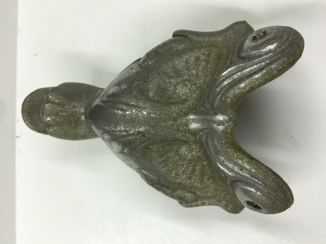

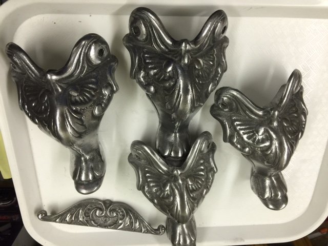

The following slot stand legs were polished using only 80 grit buffing compound from McMaster
You can see no detail was lost. If you want to have the work done by a company that specializes in slot machines email Dave Berten at http://mrslot1.com/
Heavily corroded
I hope this info helps! Good luck and be careful with those buffing wheels, never buff with the edge of the work facing up, always facing down. The wheel will grab the work and yank it right out of your hand.
Jerry
They buffed nicely in about an hour total and will appear more shiny when the residue is cleaned off.
