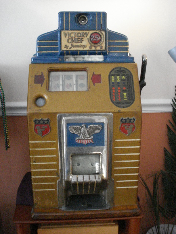

Postby alanb » Sat Aug 29, 2015 4:31 am
I am looking to replace the glass in a Jennings Victory Chief 25c.
2 of the three are cracked. All 3 had the 2 pieces of glass with a piece of plastic between.
I had also wondered about why that plastic was there and happy to learn why it was there, above.
What would I expect to pay approximately for the 3 pieces of glass?
Thanks for helping out a newbie. This is my first machine that I got passed to me last year from family. I have been reading all posts for a few months and really appreciate the knowledge here and the assistance provided to others.
I am learning a lot just reading others posts and responses.
alanb
Posts: 6
Joined: Sat Feb 21, 2015 12:04 pm
Re: plastic between the glass
Postby RameGoom » Sat Aug 29, 2015 6:09 am
Bring all three pieces to your local glass shop (mirrors, windows installation) and have them copied. Don't tell them the glass goes on an antique, tell them instead that they're "sight glass" pieces for equipment - otherwise the price escalates. Ask for the same thickness, no need to be tempered.
And definitely ask them to wet-sand all sharp edges. It shouldn't cost more than $15 for the largest piece, and less for smaller pieces.
