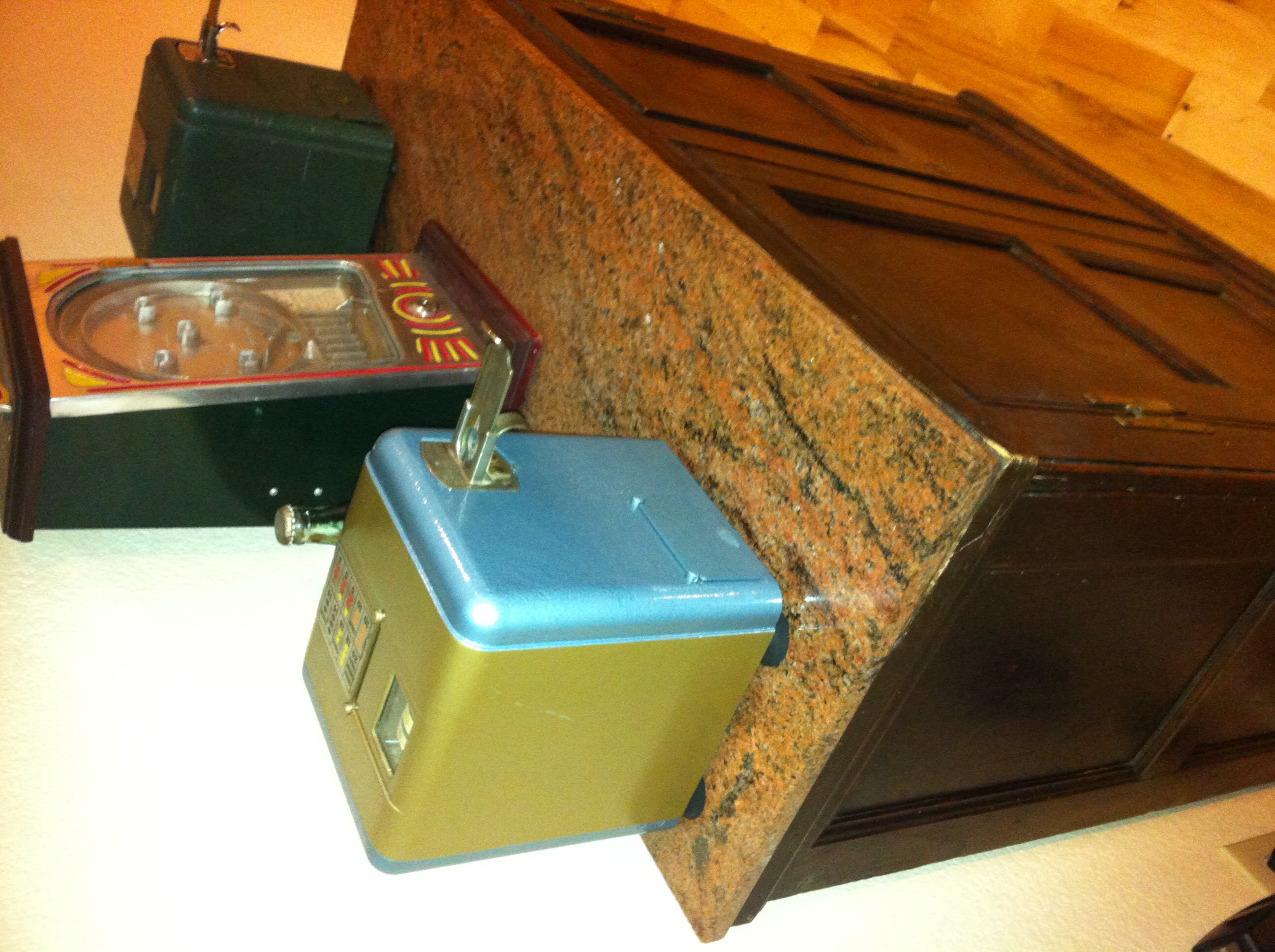

Here is a pic of a one center I recently painted

Postby pj waelti » Wed Dec 09, 2015 5:03 pm
That looks good. Do you remember the colors?

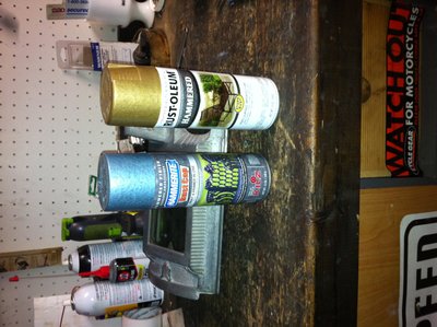

Here are the 2 colors . I found the blue through amazon
