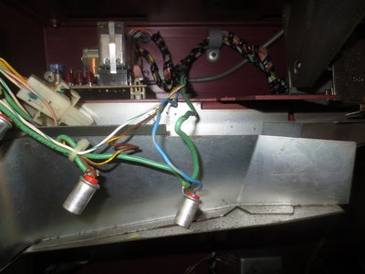

Hi Jim thought i would start a new thread again, I have a few Photographs here again for you, as you can see i found the blue and yellow wire it goes to the back of the machine then upwards to the top of the machine so i am not sure whats next.
What you said about the wire going to the door, in one of the photo,s you will see a whole pile of wires going to the connector, but that blue and yellow wire doesnt seem to be going there,it seems to be going to another bunch of wires to the back of the machine and then upwards, unless that blue and yellow wire from socket 4 does eventually end up at that large connector by going to the back then top of the machine and heading back down again not to sure

Oliver How are you doing? good I hope! Well you may have to get into the top of the machine, there should be some kind of access. If the blue/grn wire terminates at some point then you will need to trace the next color in the circuit. The wires should end at the big connector that clips to the mech. you can also take the connector cover off the cable be carefull not to crack the paper inner liner and check the solder joints for wires touching each other or the cover. More to do later ,however getting close to eliminating the problem at the cabinet. Still have issues at home but this helps take my mind off my problems !!! Later Jim

My biggest problem is how do i trace the fault up the wire, i know the tab on socket 4 indicates a fault but following the wire for a fault i am not sure how to do as i guess all we really need to do is follow the wire looking for the fault, either from the socket 4 or maybe i should carefully open that connector to see if all is okay with that. i am just a little inexperienced in following the fault if you know what i mean.
