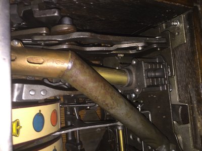

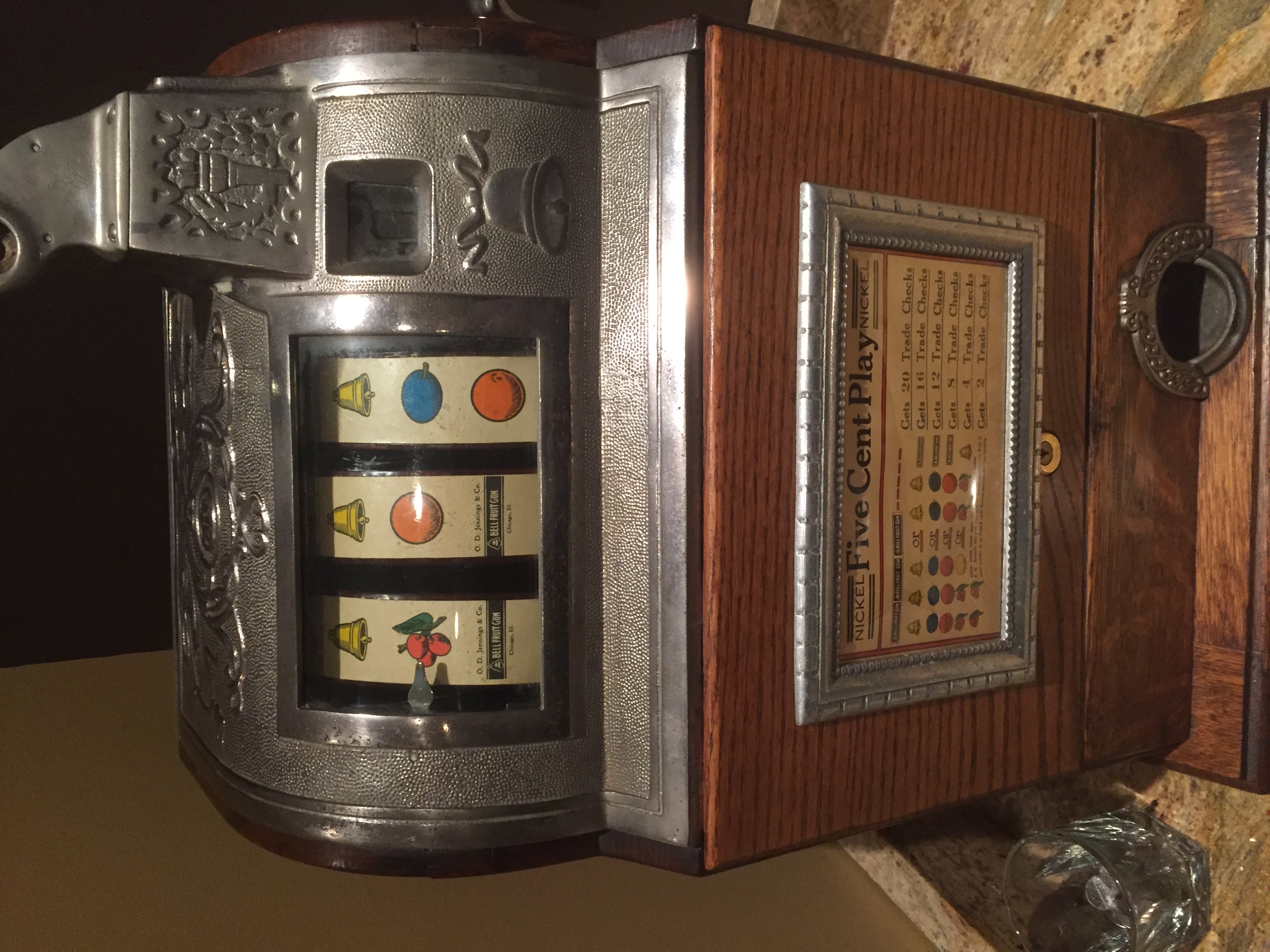

Postby md171 » Fri Mar 04, 2016 7:00 pm
Here's some pics

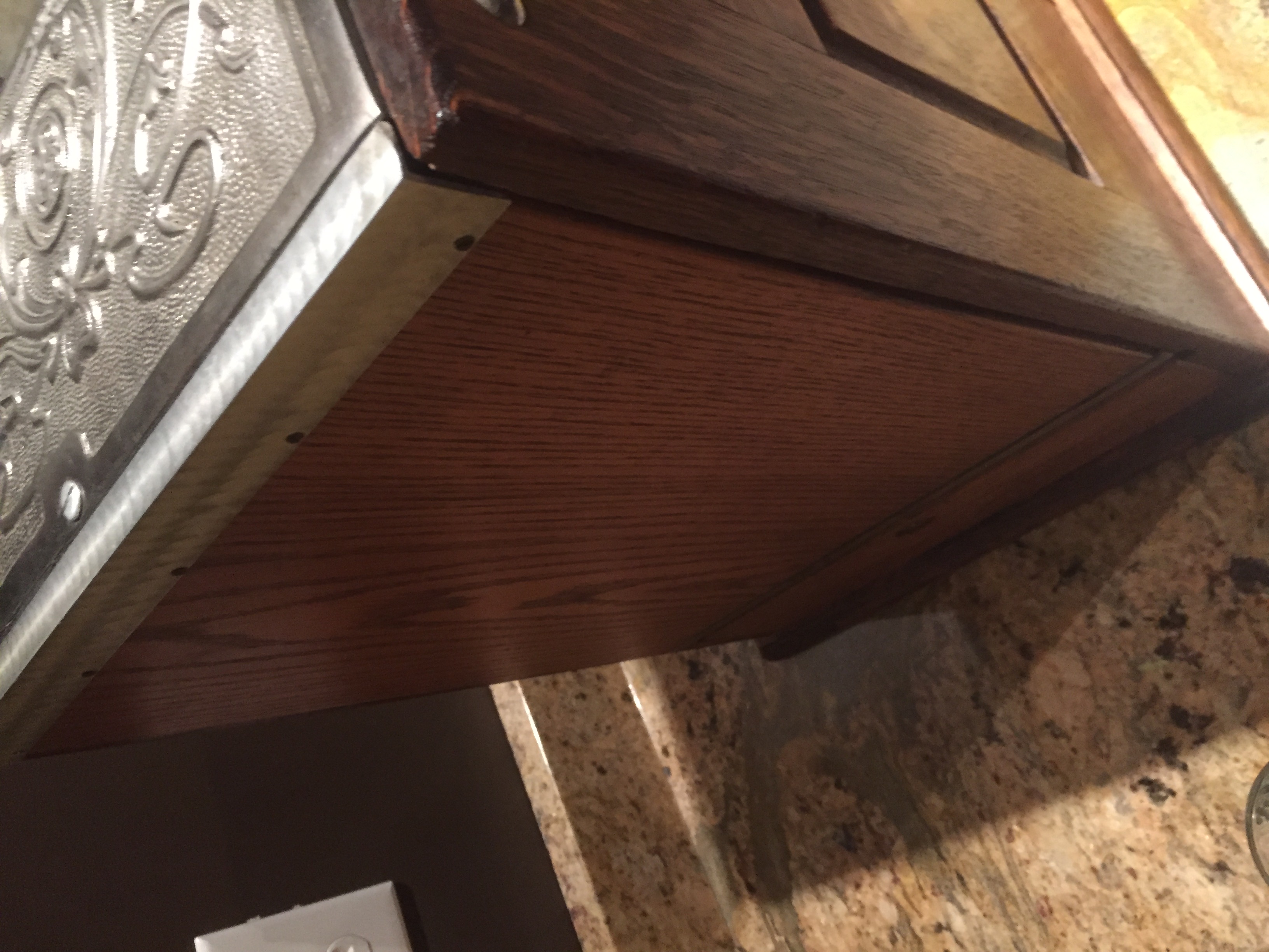

Postby md171 » Fri Mar 04, 2016 7:16 pm
Here's the backside.

Postby mechanic » Fri Mar 04, 2016 9:44 pm
An early Operators bell, can't tell by the pics if the top is cast iron or aluminum. The plate below the handle was for a side vendor unit. lifesavers type candies. The back door is home made, as is the front wood cover. See if the vertical unit with the numbers is in the front? You will need to open the front and remove it to check.

Postby md171 » Sun Mar 06, 2016 12:19 pm
The only numbers I could find is LB39 on the coin tube that goes to the bottom of the machine (not the jackpot pay tube) and LB6 on the top slide plate retainer. Anything involved with any candy payout is long gone it appears.

Postby SLOT DYNASTY » Sun Mar 06, 2016 5:41 pm
md171 wrote:The only numbers I could find is LB39 on the coin tube that goes to the bottom of the machine (not the jackpot pay tube) and LB6 on the top slide plate retainer. Anything involved with any candy payout is long gone it appears.
Those are not the numbers that 'mechanic' is referring to. You are missing the entire
future pay mechanism, that mounts in front of the reel bundle, and to the left of the
drop tube. It has a flat cast bar, with raised numbers, that correspond with the reel
symbol combination for payout. A single number will show in a small 1" window on the
lower front panel, which you don't have either. I don't have a pix of one in this computer,
or I would have shown you what it looks like.
