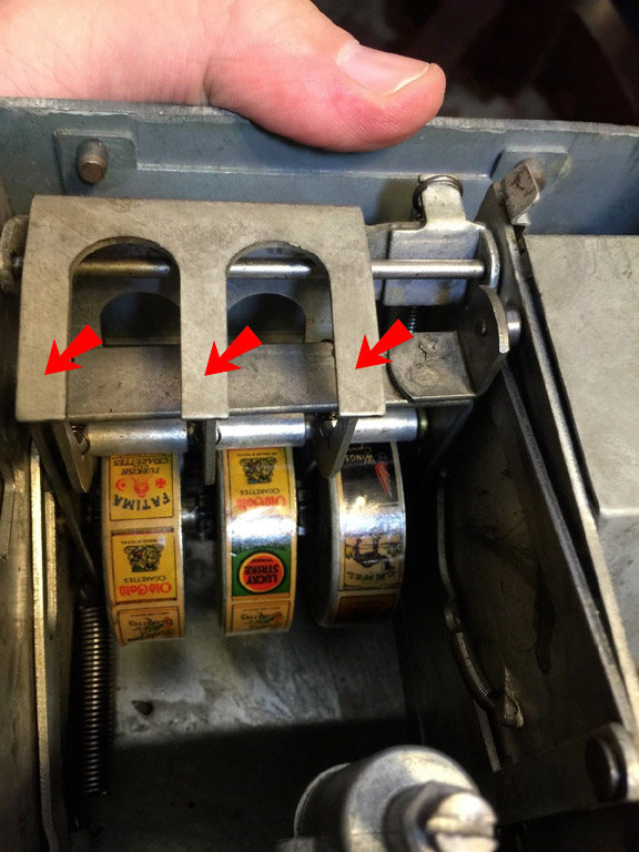

Postby marsonion » Thu Dec 05, 2019 8:47 pm
Try bending the indicated steel bars, which act as a sort of timing fork for the reel stops. I think if you bend one toward the inside of the machine a little, it will delay the drop of the associated reel stop; bending it outward (i.e. toward the back door) will make the associated reel stop drop sooner... or maybe I have that backwards :roll: try it and see. WARNING: A little goes a long way! Just tweak these bars a tiny bit, like a quarter millimeter at a time, and carefully observe how the cycle proceeds with each adjustment.
Batlestar60 wrote:I followed your instructions and it helped a lot. I’m getting my Imp dialed in.
In the video that Imp’s reels spin and then come to a stop one at a time, left to right. Is there a way to adjust to get that? On my Imp the left and middle reel come to a stop at the same time, then a second or two the right one stops. I’d love to get the reels to spin and stop like in the video
Thanks in advance,
GS

Postby Batlestar60 » Fri Dec 06, 2019 6:34 am
Hey thanks! That worked perfect. These machines are a load of fun!
