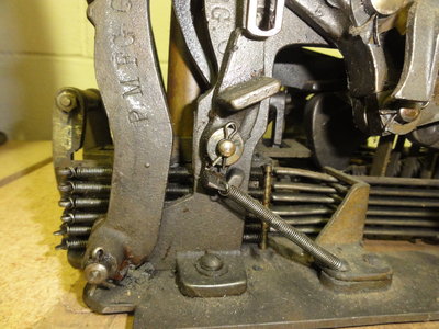

This is a pretty original machine and would like to keep it as such but want to maintain it of course. Problem is I cannot fill the jack pot. When I messed with the weight and made the moving floor stay up so coins would drop into the jackpot it only filled it with 40 nickles maybe and then I do not know where they were going as it was not dropping them. When I pulled mech out all the coins dropped out the pay out slot. Another thing that may help as stated is when I pull the whole mechanism out the jackpot open and dumps any coin. Can someone take a look at this pictures and see what spring or part is missing or out of place? Thanks,,Rick B

Here is a picture of your missing part. This is on a Pace FOK but basically same as on Mills and Watling. This lever is the safety or lock lever for mech operation and likely you will never need it. They do show up on eBay frequently. Flip
