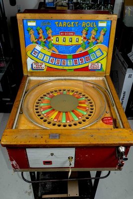

Rick:
Here is a pix of another one, in my files, from 2009, in 10c play. What denomination is yours?
Sorry to say, that I don't know who owns it. Nor do I know where the pix was acquired. But at
least you know there is another one out there.
Too bad we don't have the number of that phone sitting next to it. :(
Bally 10c 'Target-Roll' Roulette Pinball 1957 (orig)1.jpg (26.39 KiB) Viewed 9051 times

Thanks Bill for the extra picture. They're always useful.
