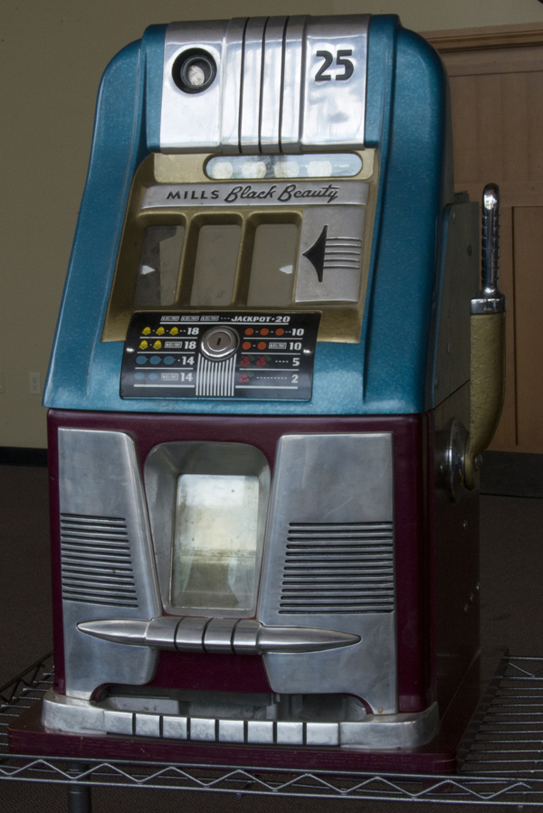

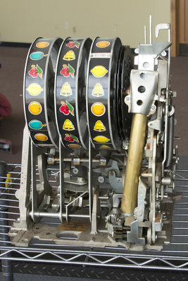

A neighbor brought me two machines to help get operable, a Mills Black Beauty and a Mills War Eagle. They've been sitting for many years, as his father bought the Black Beauty brand new. So upon further inspection, the grease has turned to tar and oil is non-existent, which I would expect. But, the mech has remarkably low wear, and as I understand it, the machine was purchased for home use. He also had a stack of related paperwork, of which I made copies.
So I'll start by removing the reels and spraying the mech down with naphtha, then oil everything. Oddly, there are two bugs on the reels. Wondering why you'd have bugs on a home-use machine, I discovered the receipt for the "percent regulators".
The War Eagle was previously painted blue, sides and all, and I suggested a restoration, but seems he wants to keep it as is. Looks terrible, yet it's all there. Big job to strip and detail though.
The Black Beauty has a jackpot fill lock on the front, but it seems the jackpot also fills from the coin chute. Maybe it's only the reserve that gets filled manually? Any ideas?

I don't think hand load jackpots had reserves or automatic load feature.
I thought one of the purposes of handholds was so the owner/operator knew exactly how much was in the jackpot.
Re: Restoring a Mills Black Beauty
Postby JHSS-1944 » Fri Jul 22, 2016 1:32 am
I agree with Dave on this.
many operators hated having some one run over count the coins out then , hand pay the rest, since the J.P. never filled to the needed amount (specially at 2 a.m.). hand loads were refilled on the spot soon as it hit a J.P.
I don't recall any slot having both features , as the Operators bought / ordered them in 1 form or the other, straight from the factory. I don't recall right now IF, the black beauty was offered with the hand load option , Most weren't. goggle images of Mills high tops & you will see far fewer with the hand load lock on them.

All Black Beauty's were Front Hand Load Jackpot's. While you didn't post a picture of the inside of the machine, I'm guessing you are referring to the Chute that is connected to the top left side of the Jackpot. That is there to channel the Coin Tube overflow coins to the cash box. If you look closely, you will see there is No Way for those coins to enter the Jackpot. They simply run down the back side to the cash box.
The Blue War Eagle looks great. I wouldn't repaint it either. Nice original machines.

Thanks for clarifying that about the jackpot. I have removed the jackpot to lube and clean it, and will look closely.
