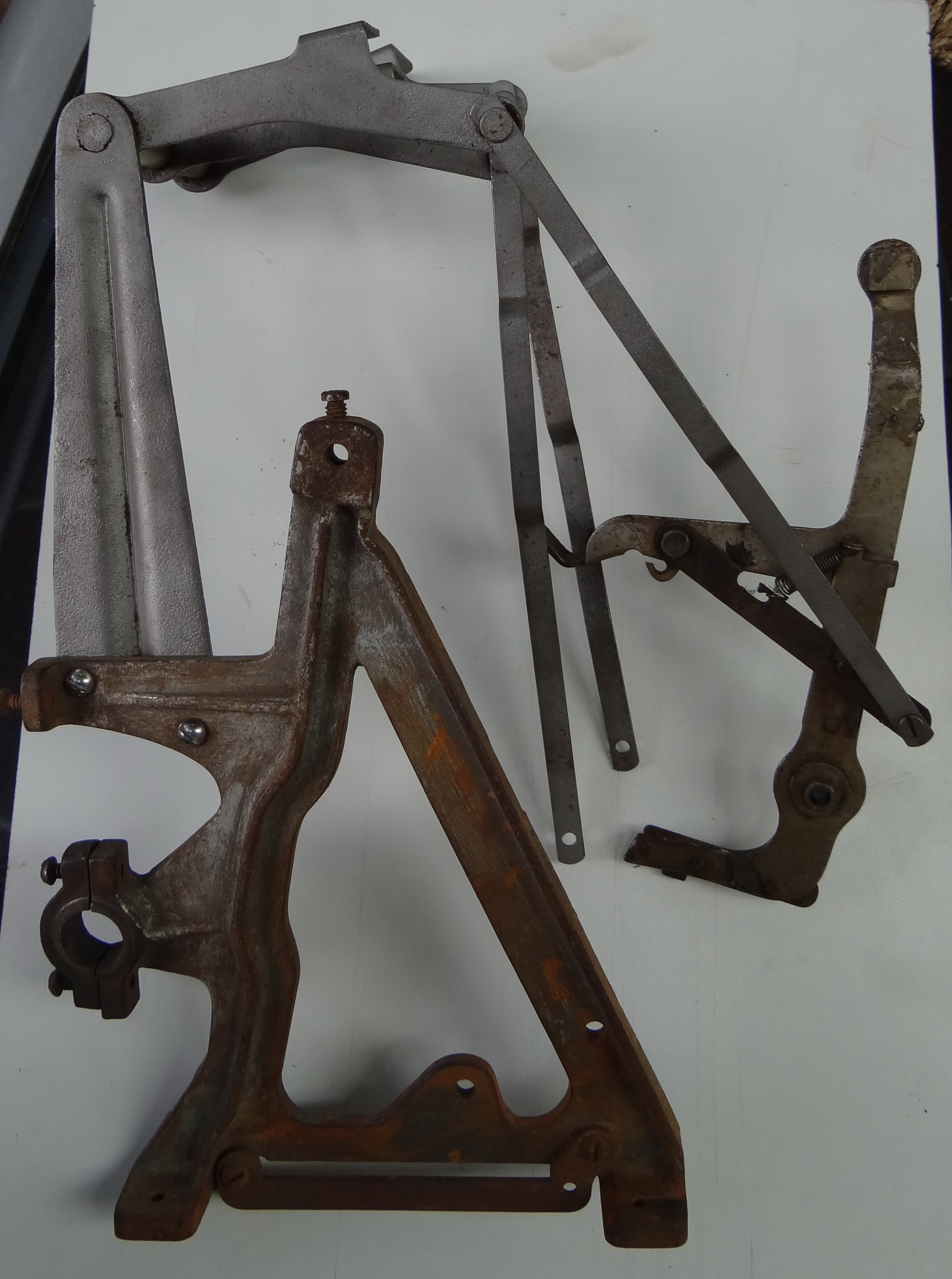

just need some quality photos of the mechanics out of the cabinet.

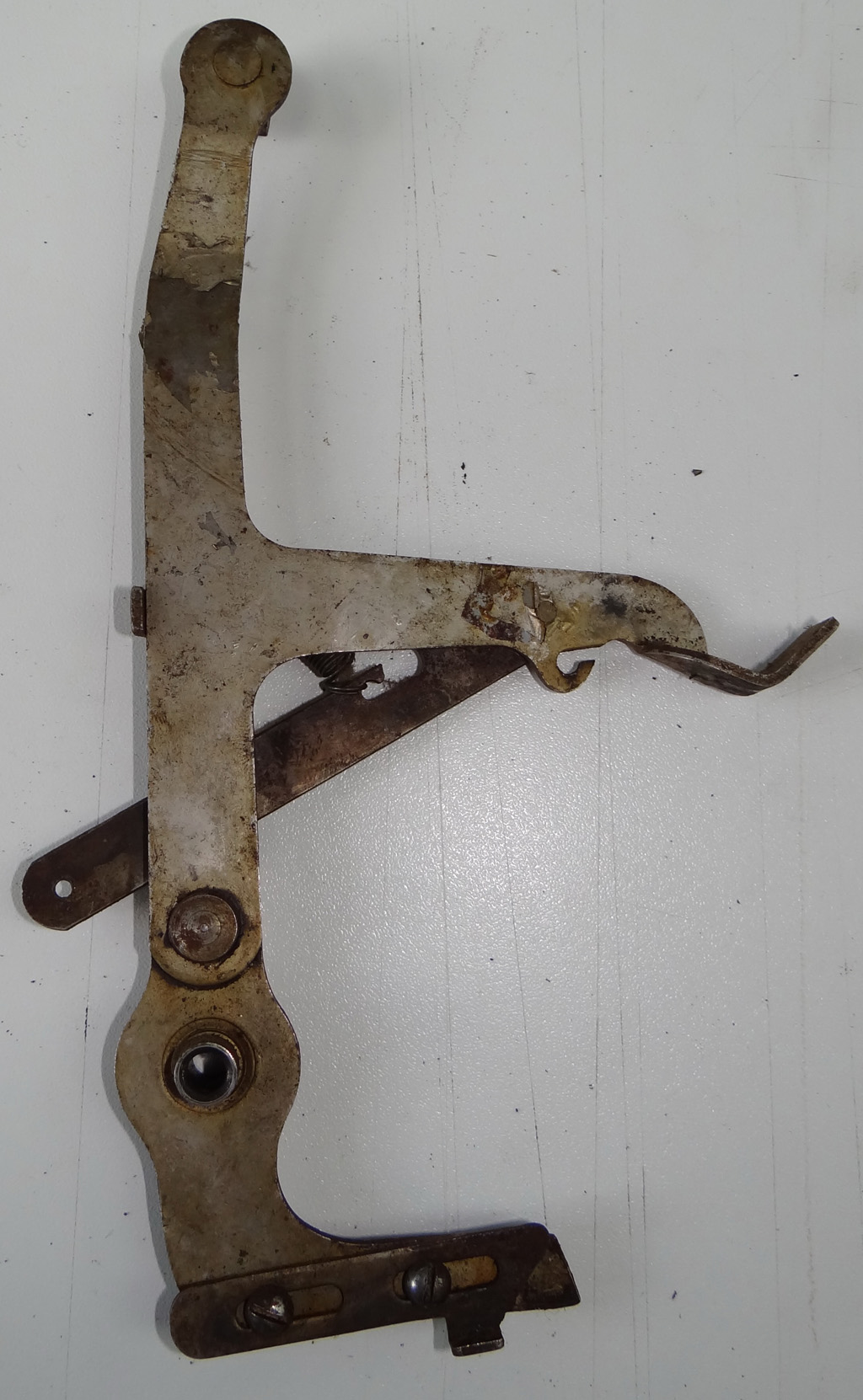

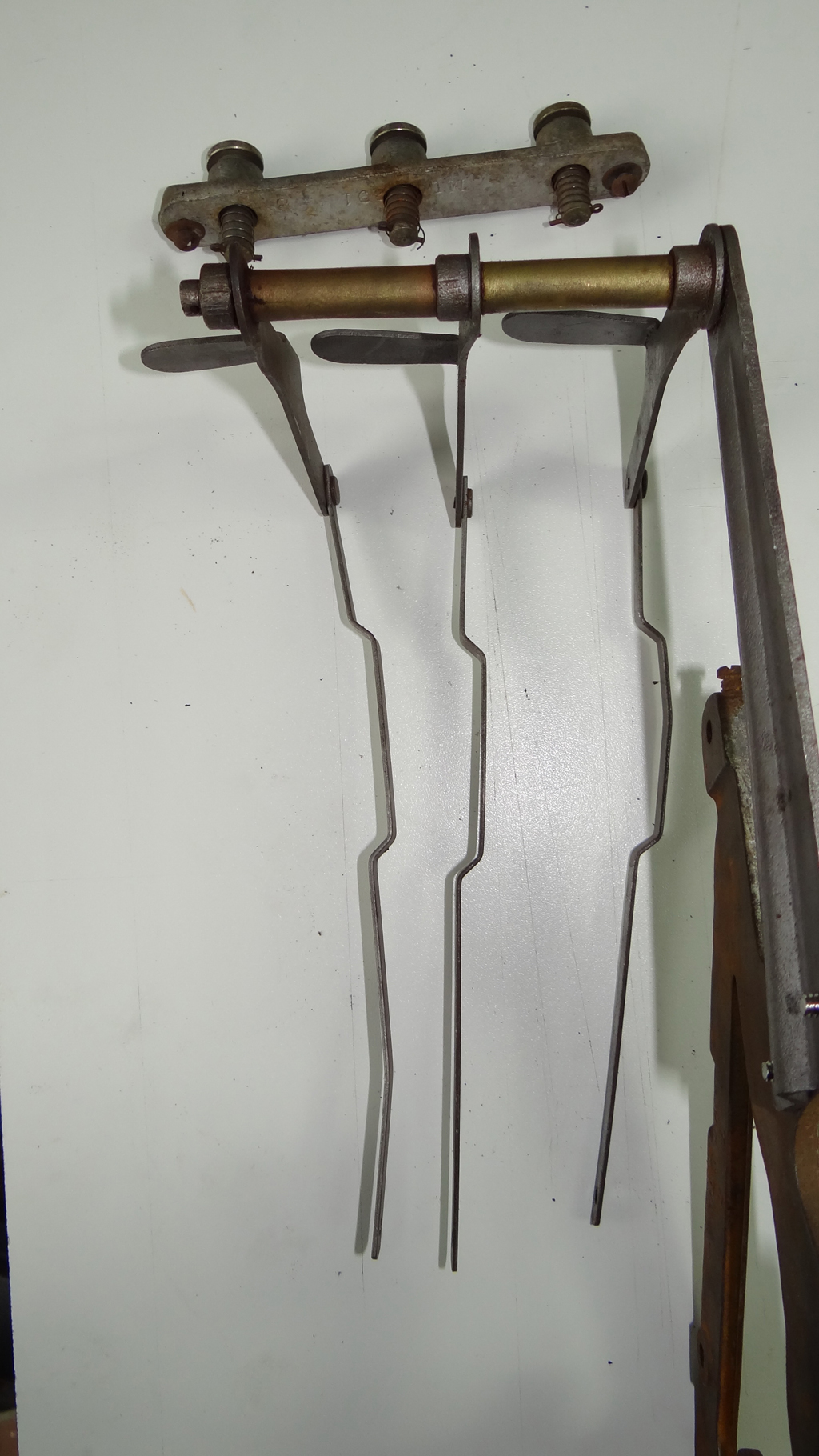

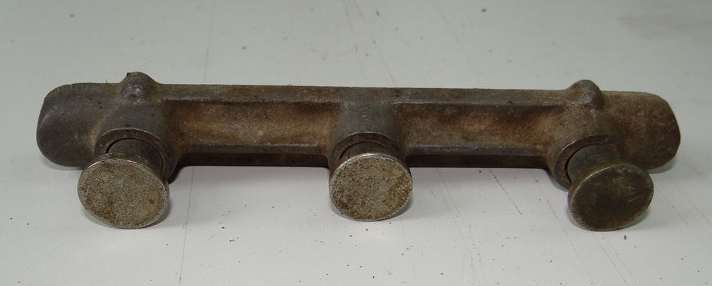

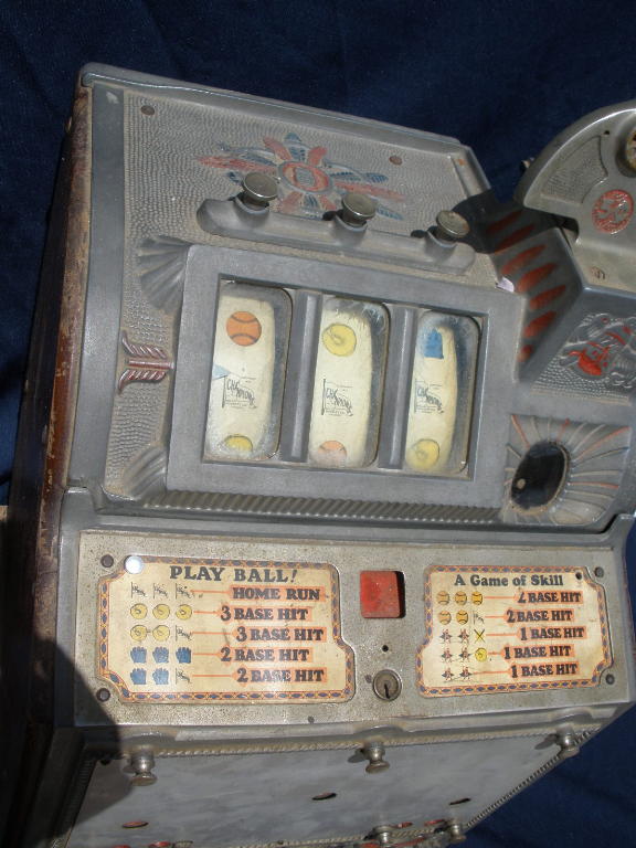

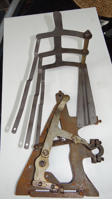

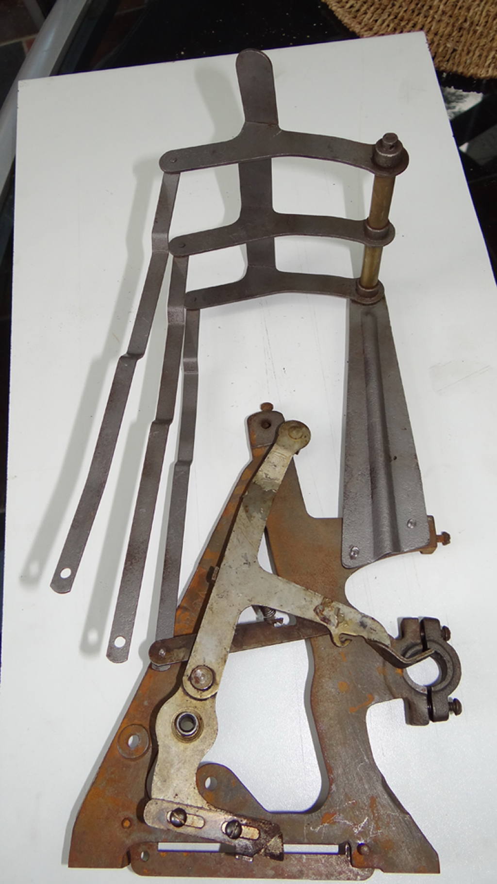

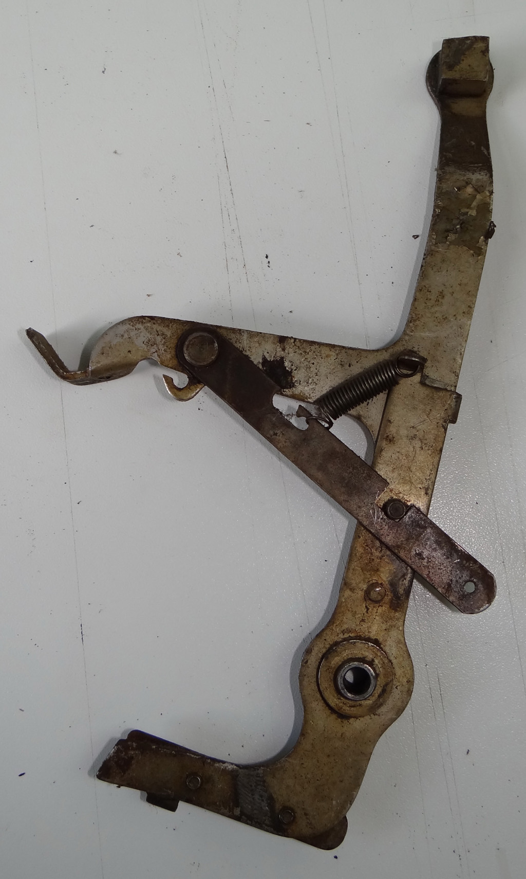

Postby gsx11r » Fri Jul 29, 2016 8:06 am
Hi Again
There is some photos !
If you need more info , let me know !
Stephane

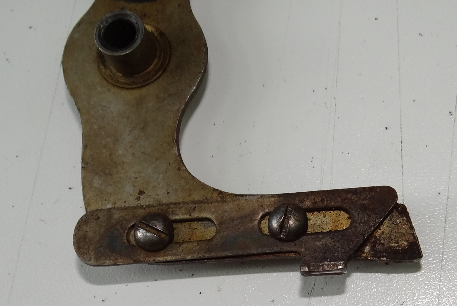

For info this is the "1259 stop trip lever shoe " ,so , you need 3 !One on each arm !

Stephane ; Thank you very much for these Great photos !!!!!
exactly what I was hoping for !!

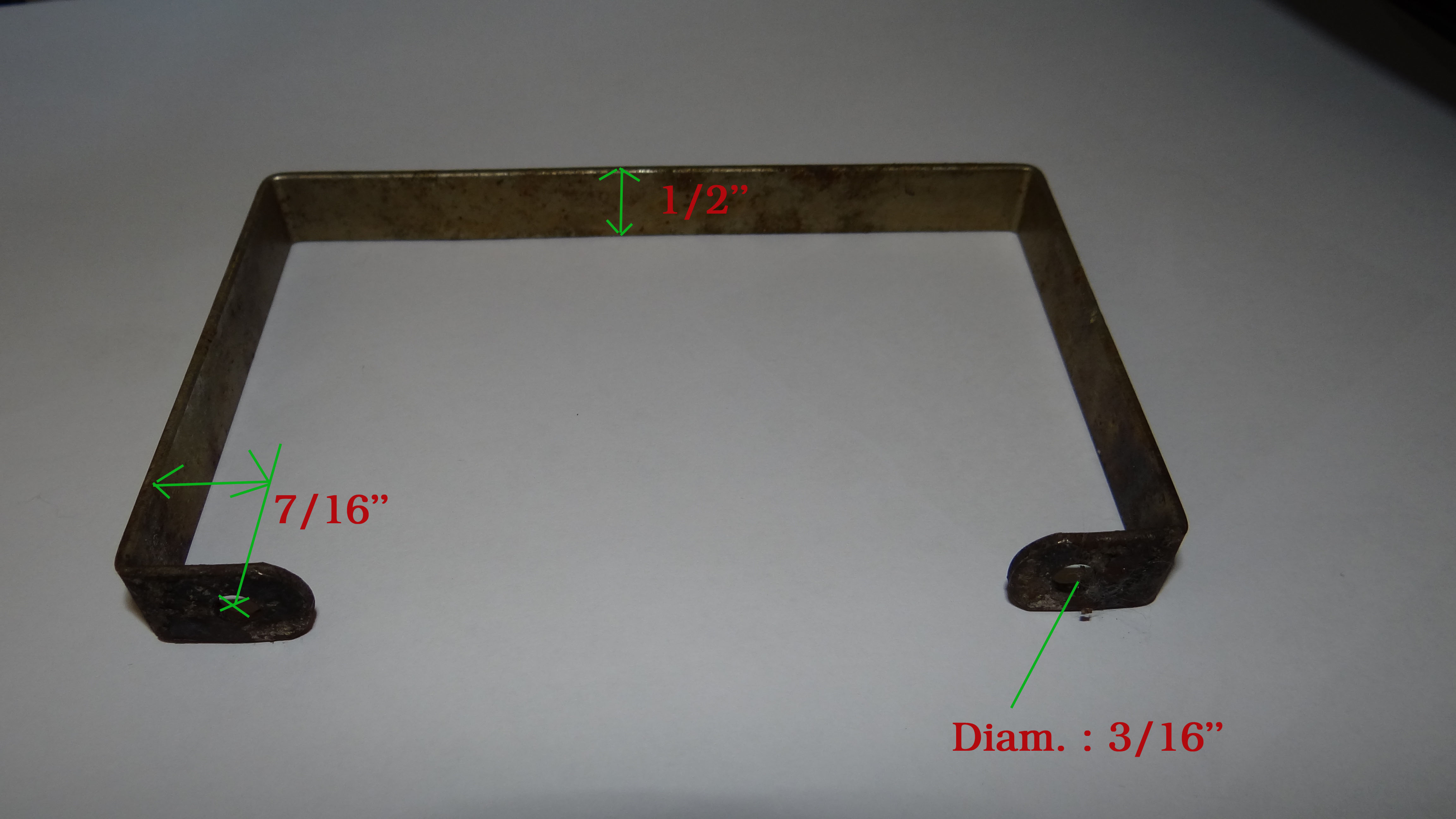

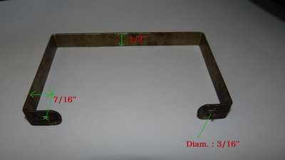

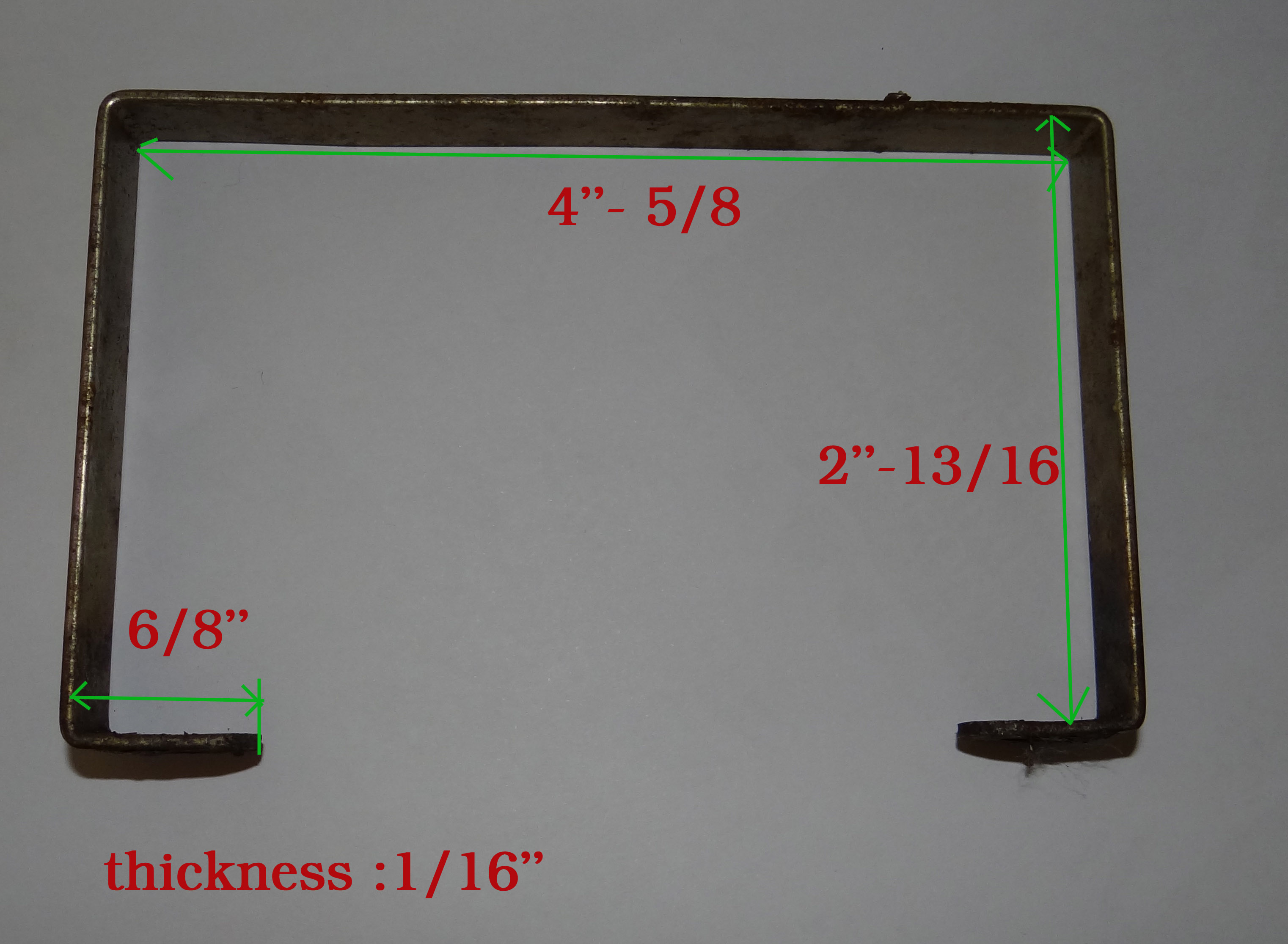

can you give me the rough size estimate on part #1263 ( stop bar) Not shown),how tall ?
I should be able to make something very close from these photos for my slot machine.

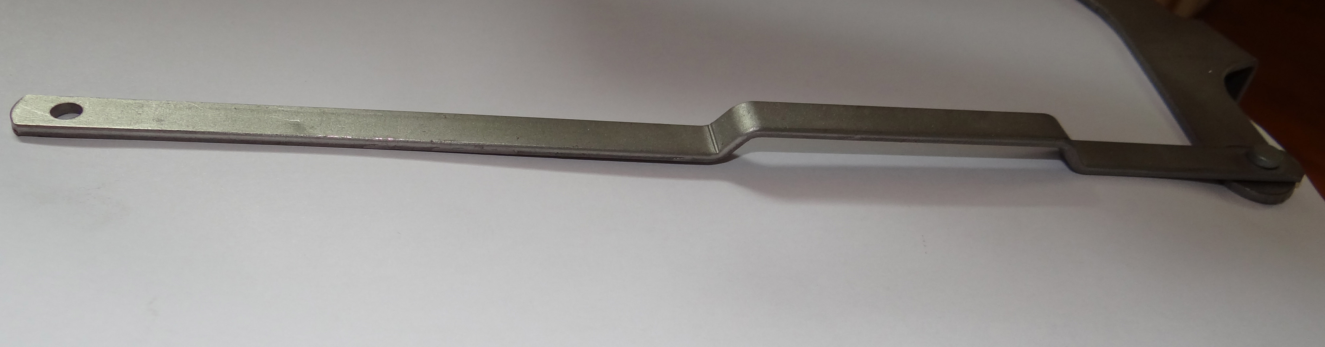

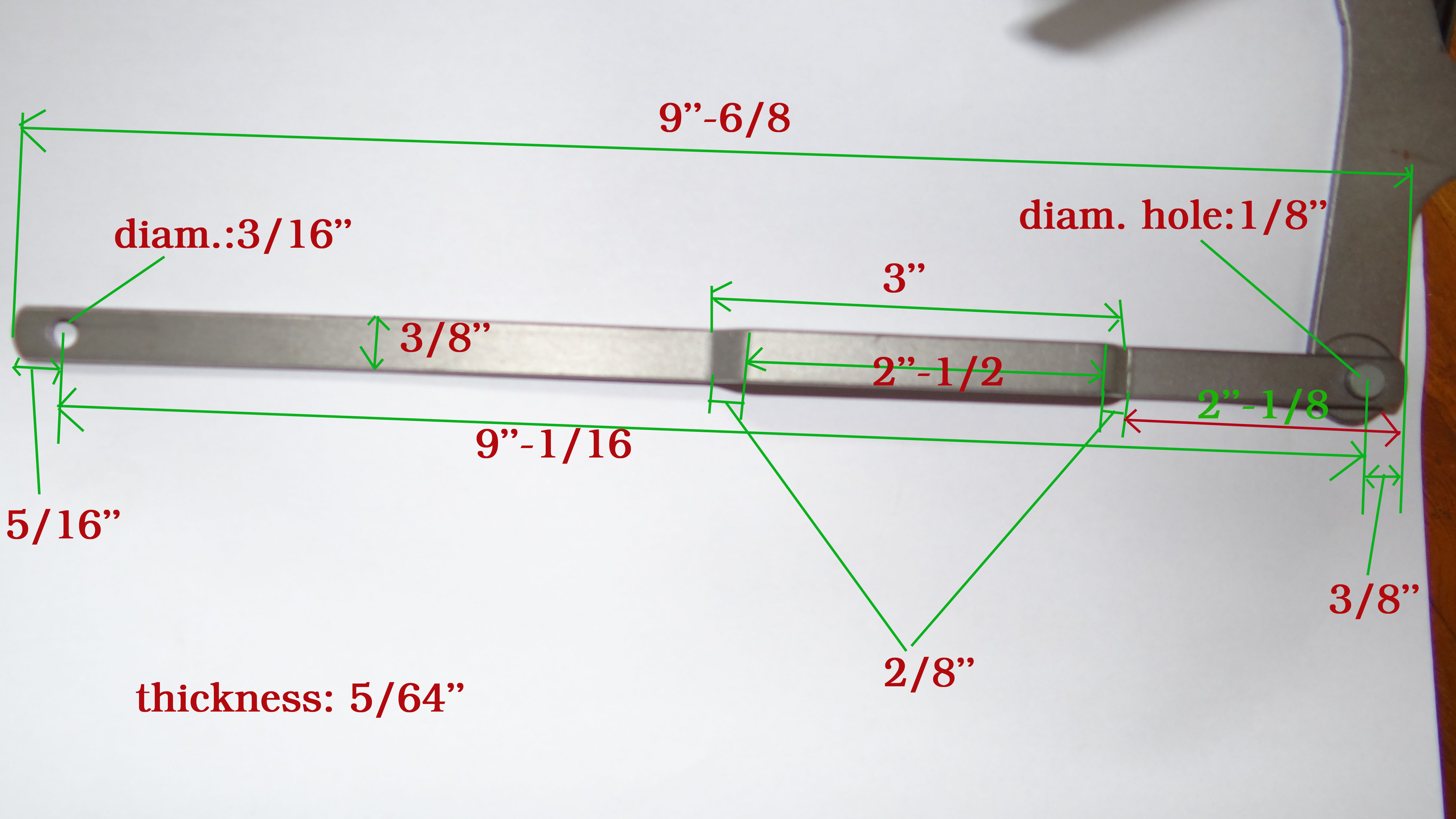

can you Please give length of part # 1262 ( stop lever connection) ?? if I get this correct , the rest will be easier to modify to fit & work.

Hi Jeff
Oupps , I forgot the 1263 !Sorry
You must have all info on this photos ! let me know if need more !
Stephane
Warning !! All this info are for the "ON TOP" skill stop only !!!The others are different !!!
