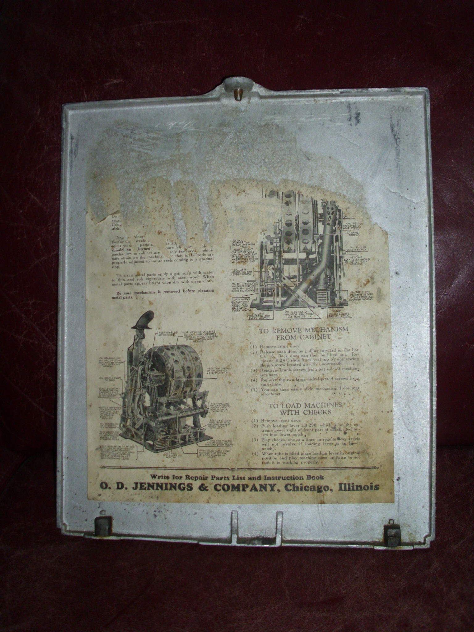

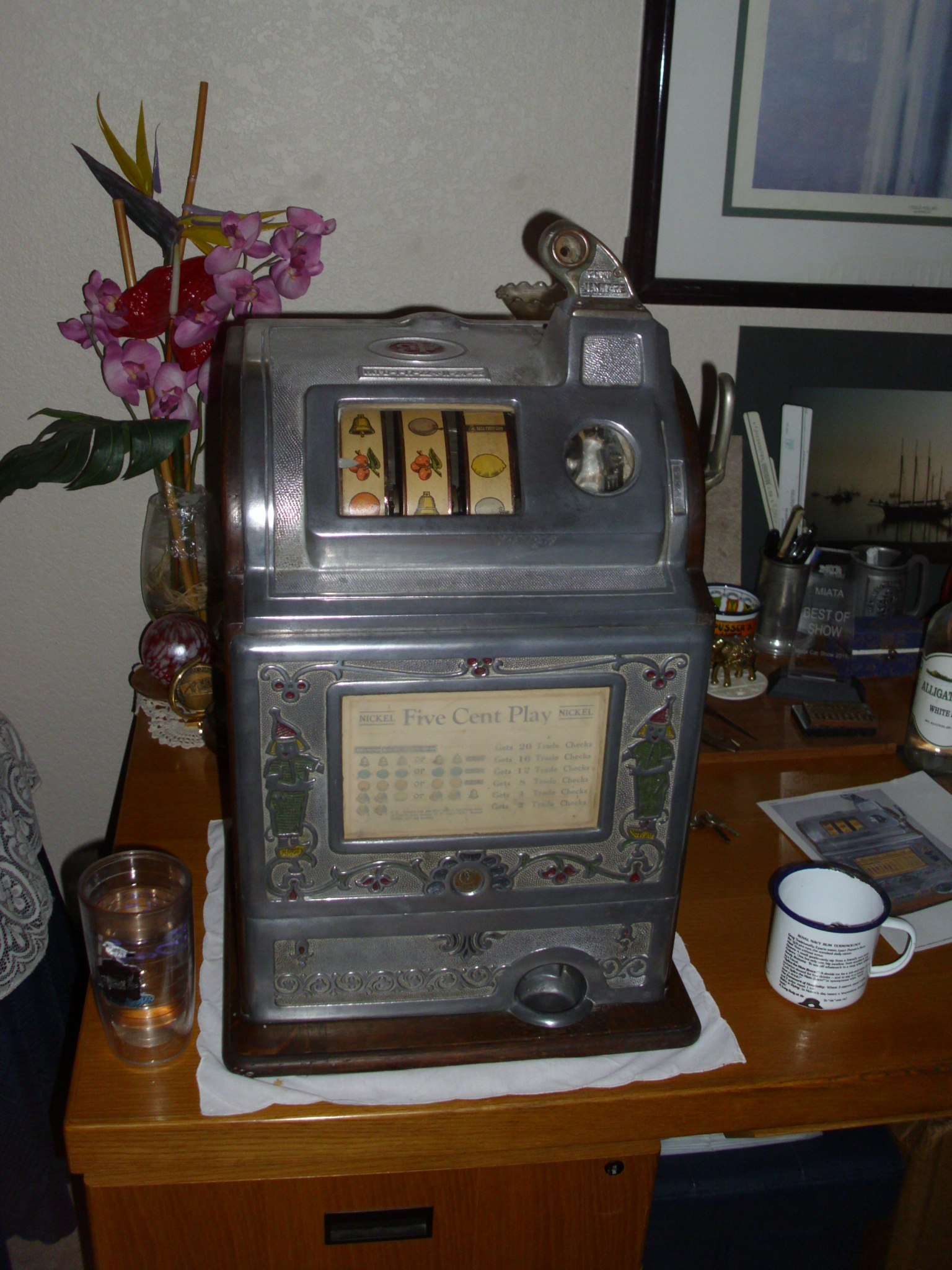

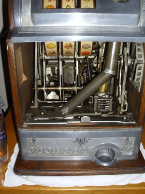

Alright folks, here are some pics, I also attached a pdf of the magazine ad that was in the cash box from September 1927. Do you all think that might be a good date about when this guy was made?

Postby Richard13 » Tue Jul 26, 2016 5:17 am
Holy cow the glow in that aged oak is phenomenal. It looks like you cleaned up the castings too what a nice find! Congrats.

Doing some detective work - I was looking at the ad I found and scanned in. I believe it is a page from the Detroit Yacht Club's newsletter! It is one of the oldest clubs and they built a new (now historic) club house in 1923. I just emailed them through their web page to see if somebody could verify the page is from their newsletter and if they would have any old pictures showing slot machines. It would be great if I could verify all this!
