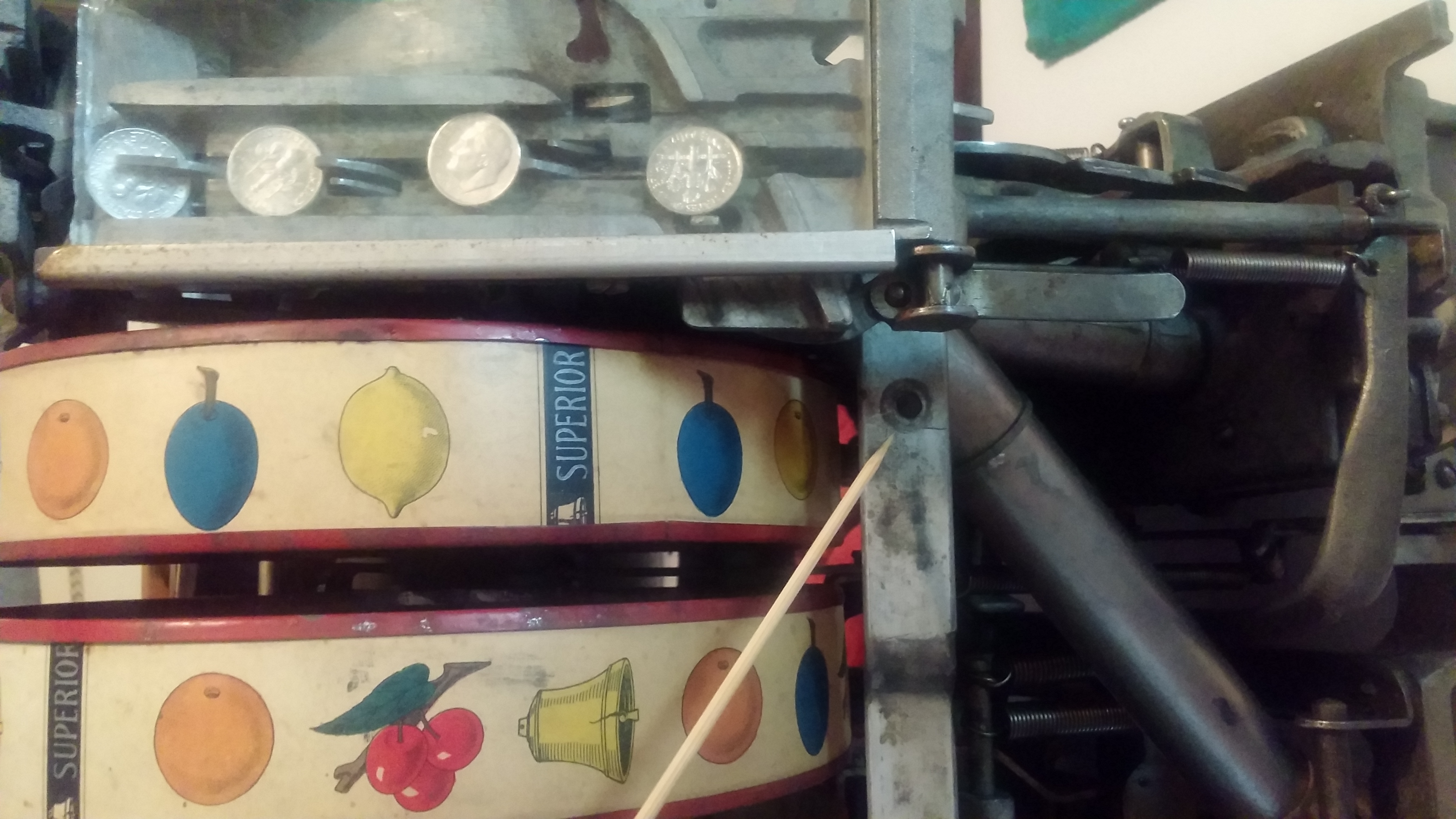

Another question until I purchase reference material...on the main operating bar ,what is suppose to attach to this hole (pictured with a wood stick pointing to the threaded hole)
briank
Posts: 238
Location: Leland, Il
Re: How to empty coin tube
Postby oldslotman » Wed Aug 03, 2016 8:41 am
detachable bolt handle. Used to cycle machine outside of cabinet
