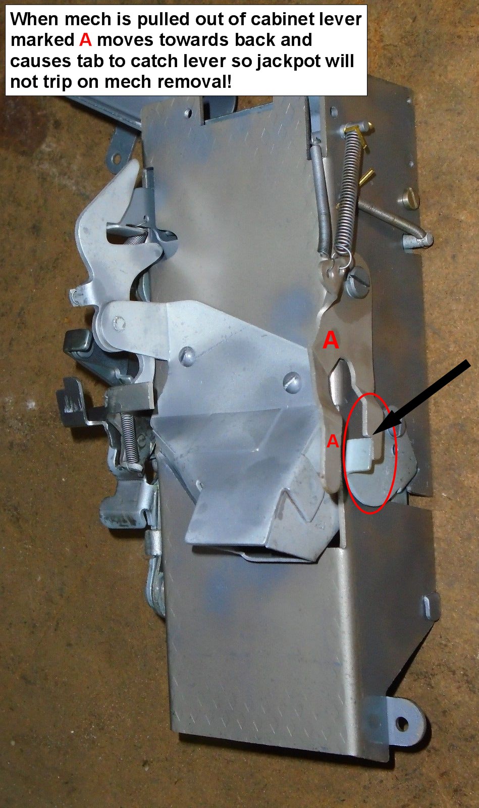

I have a mills high top that opens when I take the mech out and closes when I put it back in. I don't think it was made that way. The machine works great I just don't like the coins dumping out when I take mech out. Is there a part missing or did seller take it out to resell.

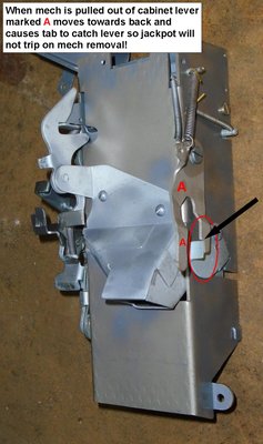

When mech is pulled out of cabinet the arm marked with the RED A in the picture moves towards the back and in so doing locks the jackpot so as not to release coins when mech is pulled out!
Possibly this is missing on your front jackpot or the spring that operates this arm is missing or stretched!

Yep!
I'm missing the part marked A. I found a shoulder screw in the cabinet that is probably used for part A. Is there a reason for removing this part.

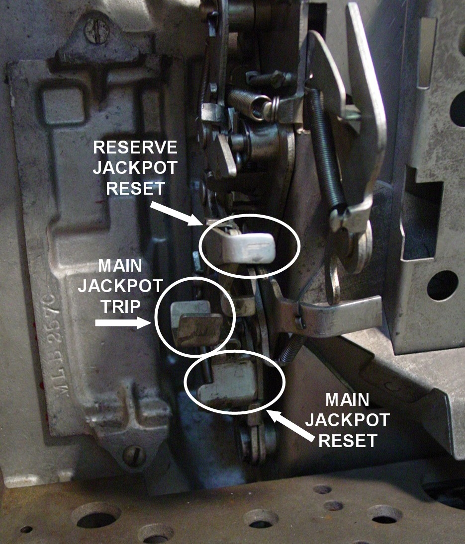

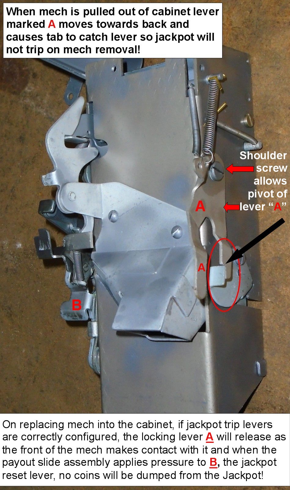

If shoulder screw is present on side of jackpot housing as shown in the picture below then more than likely the part, lever "A" has been removed and I would replace it if dumping of the jackpot on mech removal is a problem which in a home setting is not that big of an issue as long as all jackpot trip and reset levers both on jackpot housing and payout slide assembly are set correctly as described for reference in the other two pictures below!
As when sliding the mech in the jackpot should not dump if the mech is slid in smoothly and firmly with no hesitation or reverse movement as that may cause the tripping of the MAIN JACKPOT TRIP lever! Also, your name is familiar and as I am in Northern California have you ever called me off of one of my internet listings, just curious!

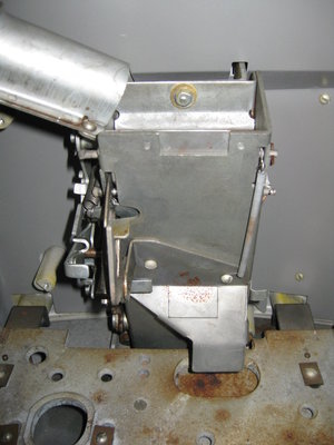

Postby oldslotman » Thu Sep 29, 2016 11:31 am
If your mech looks like the one pictured above than yes you need that side lever. But if it looks like the picture here where there is a jackpot trip lever above the top jackpot slide than you don't need that lever. I believe most if not all high tops had this type of set-up unless someone changed the mech to an earlier type.
