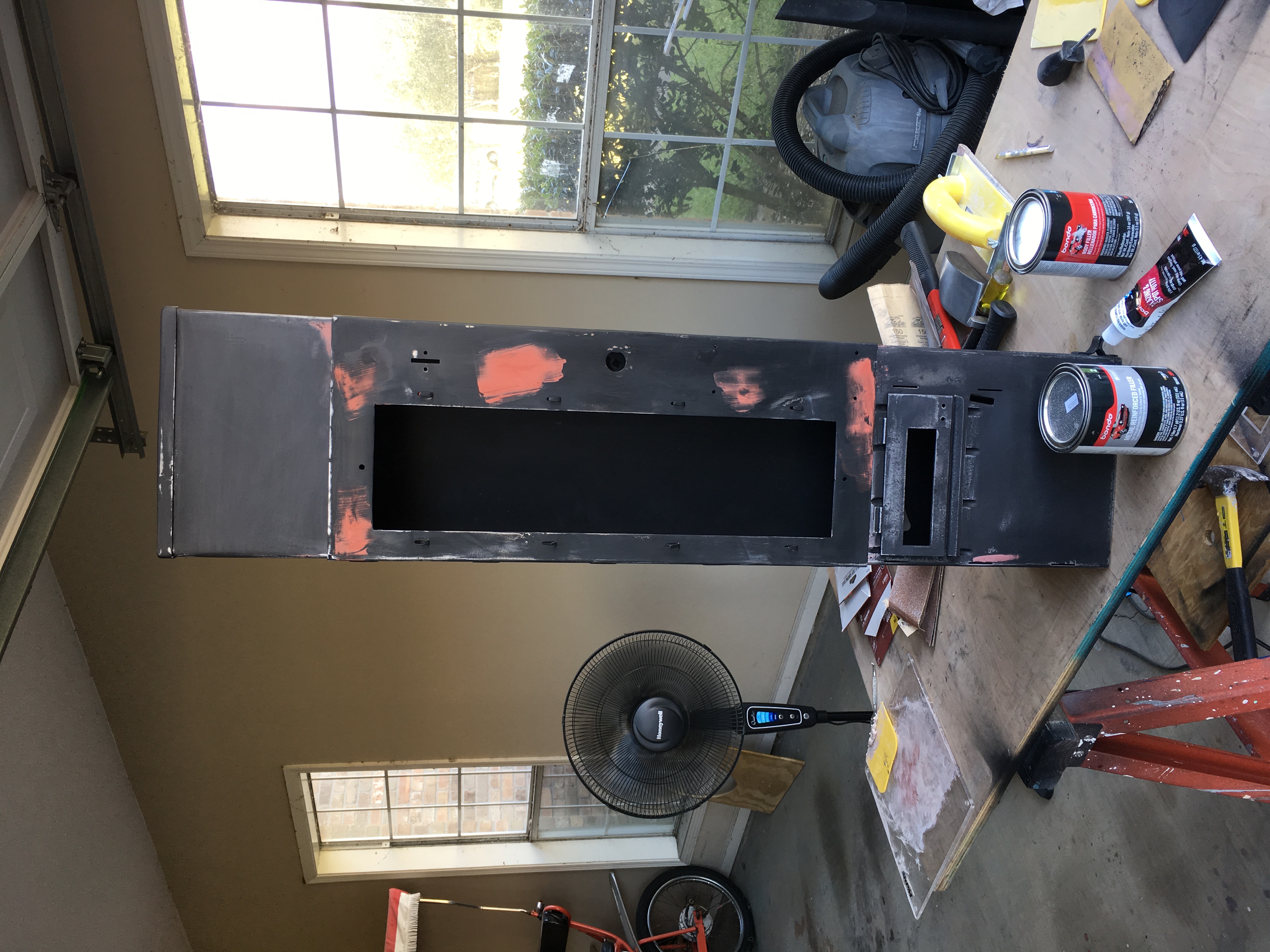

Postby d12bn » Mon Oct 10, 2016 2:04 pm
I have my vending machine sandblasted,treated the rust and primed. It has some pitting and a few pin holes. Should I use bondo, filler or something like Metal to Metal?
Thanks

Postby briank » Tue Oct 11, 2016 10:47 am
I would use spot putty if it is only pitting and pinholes. That way no mixing,you can use straight out of the tube.

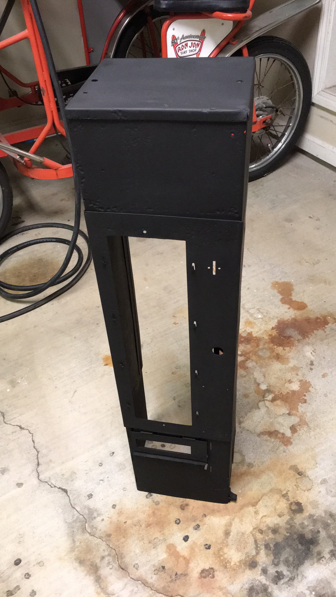

Postby d12bn » Sat Oct 15, 2016 5:33 am
I found metal filler from Bondo in a pint size can for $20. It's drys very hard and makes a good base coat. Then finished with regular bondo and fill n glaze.

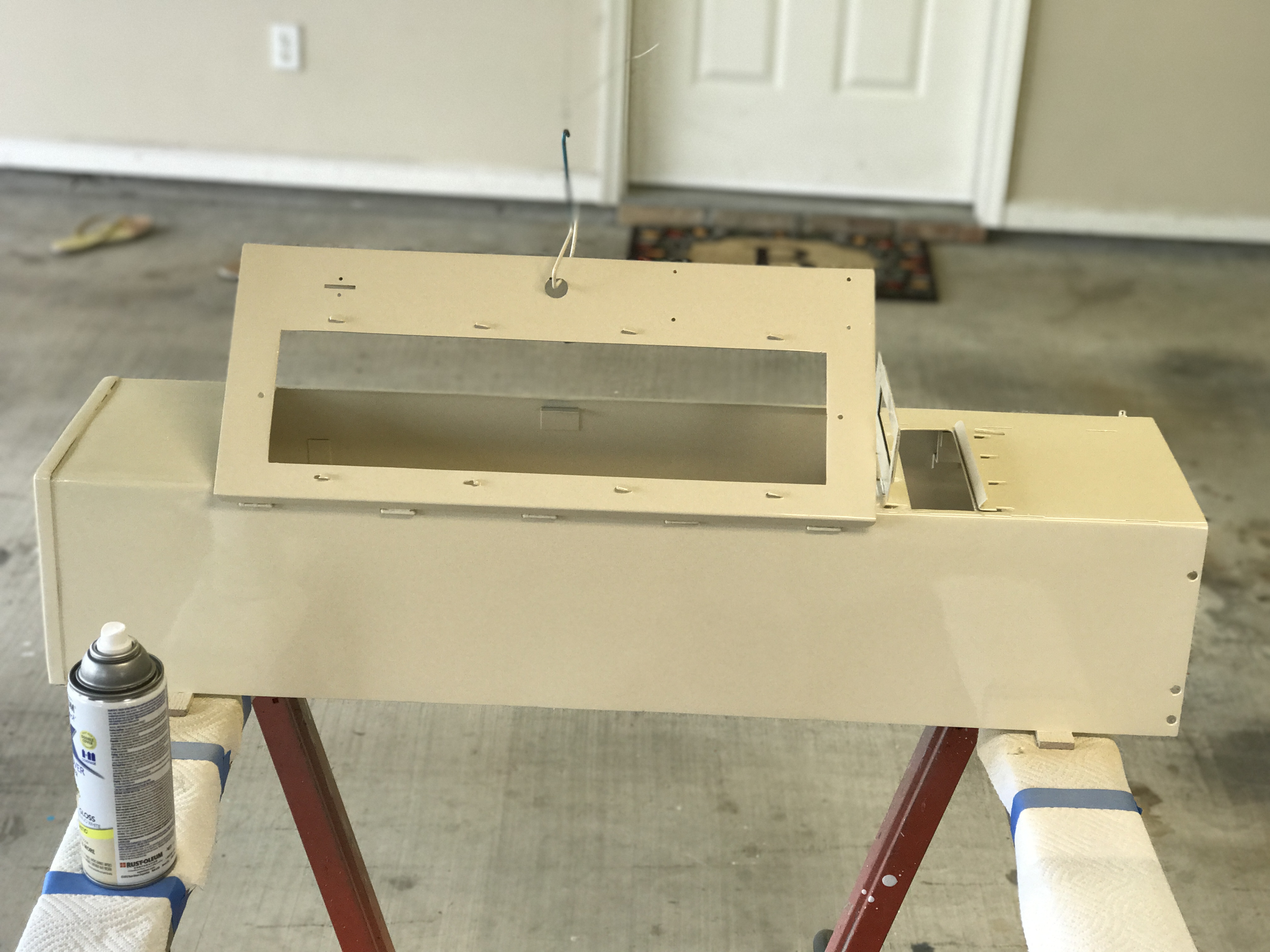

Postby d12bn » Mon Oct 24, 2016 5:20 pm
Got some paint

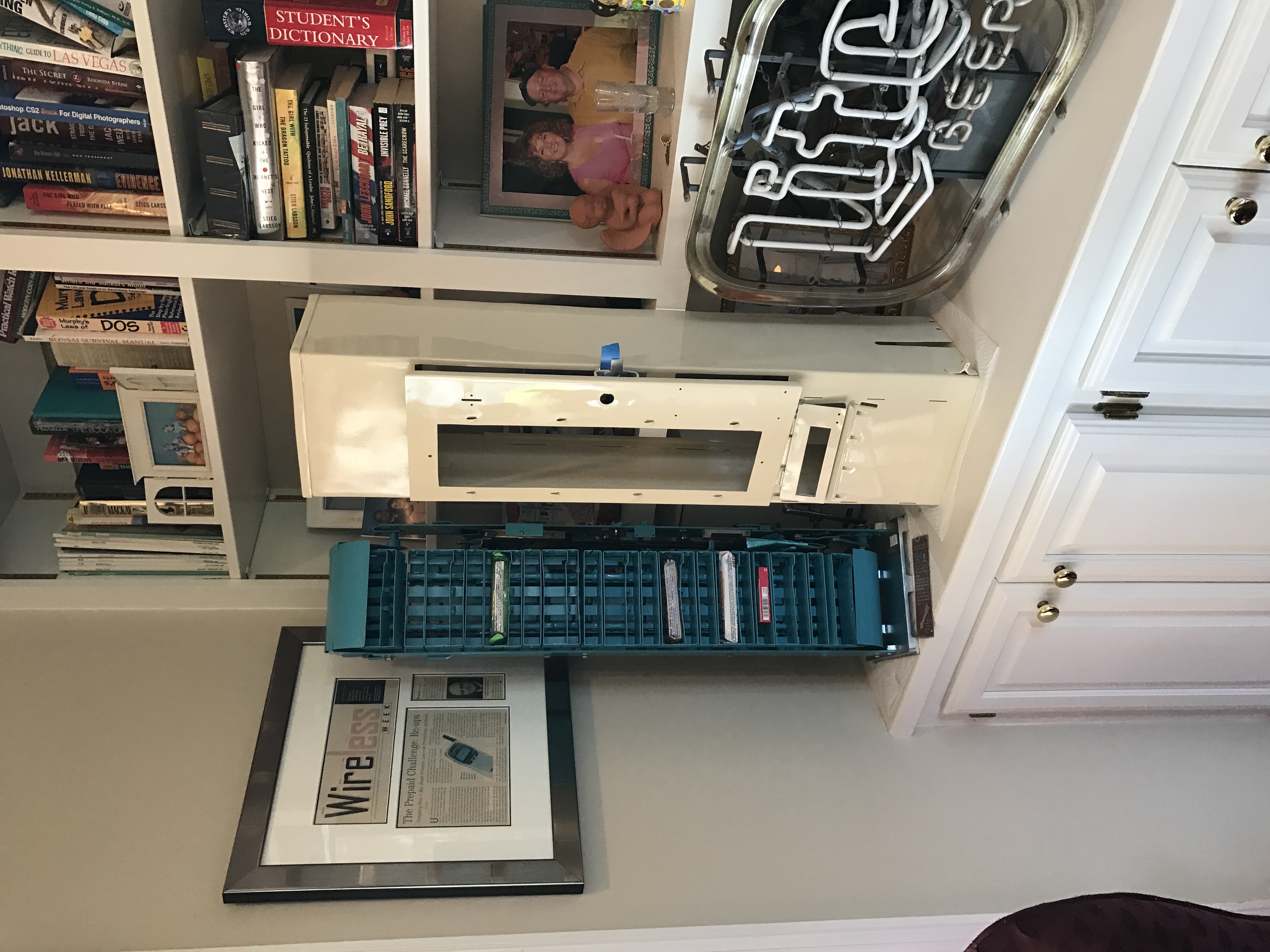

Postby d12bn » Tue Oct 25, 2016 11:04 am
Not perfect but I'm happy

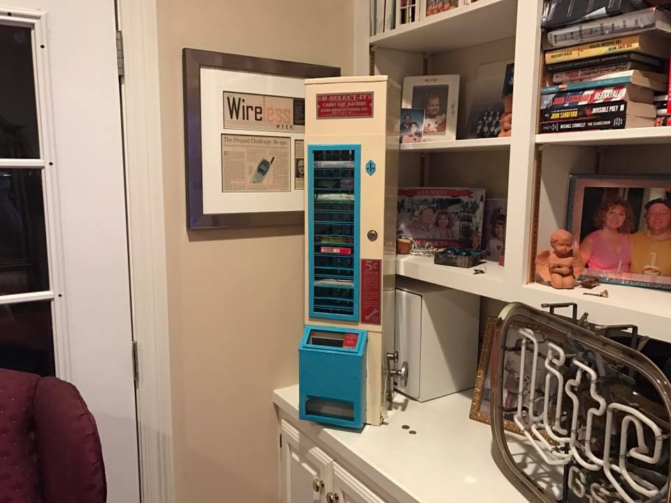

Postby d12bn » Mon Nov 07, 2016 12:54 pm
Its done
