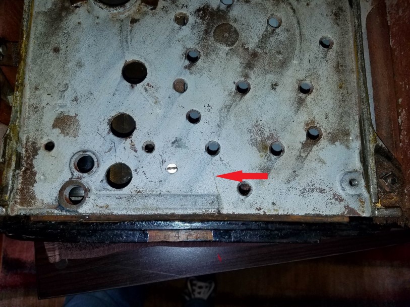

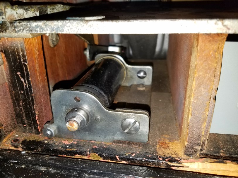

1st- I noticed this hairline crack on the bottom plate- is this an issue? is the plate steel or cast iron? I have a nice hobart mig setup to weld aluminum and steel, but not looking to tackle cast iron (I have in the past with stoves and it was a miserable experience)

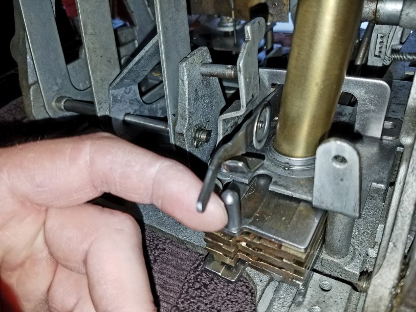

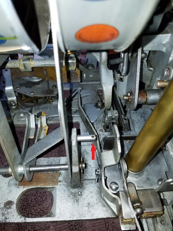

2nd- I saw this lever just sitting on the bottom- is this normal?

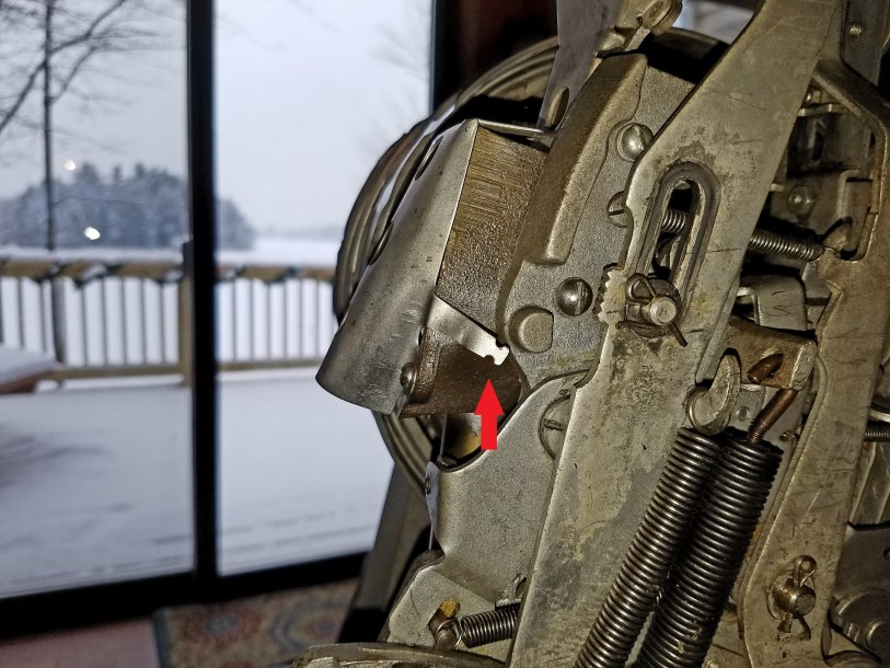

3rd- I notice the handle does not always return to the fully resting position after being pulled- is this the mechanism I would remove and clean / lubricate to fix that issue?

4th- I noticed these two levers- missing a spring or normal?

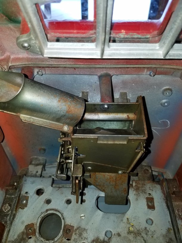

5th- do I just dump in dimes to fill the jackpot? how do I know when enough is enough? can I accidentally over-fill the jackpot?

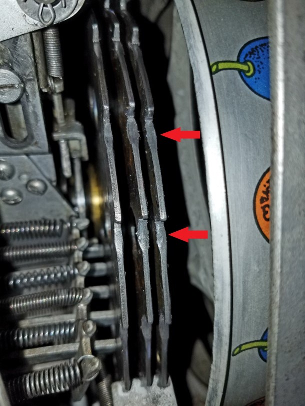

6th- I noticed the "flat spot" on the wheel gear- can (should) I files down the edges or should I leave well enough alone?

Issue #1 - Your base plate will be cast iron. The crack is no real big deal, as it is only a couple inches long, and stops at the first hole. If you do wish to
weld it, v-grove the crack slightly, and use Silver Braze, (aka Silver solder). It is very tedious work, but fill the grove, then heat the opposite
side, and it will draw the braze through the crack.
Issue #2 - Leave that lever be for now. It is for the jackpot operation.
Issue #3 - Work with cleaning & greasing the handle bushing first. if that doesn't help, you may be pulling the pump apart for a re-lube.
Issue #4 - No springs get attached to the lever or the pin-hole. Leave them be.
Issue #5 - The jackpot will fill on its own, (unless you want to hurry the process). The overflow will then be fed to the coin box.
Issue #6 - The flat spots on the code-disk stops, are no big deal. but if you want to pretty them up, a file is not going to do it quickly, as the discs are
hardened steel. Use a Dremel with a small grinder tip.

As far as Bills post .... you can take it to the bank as far as I an concerned. I agree fully with his comments, especially the Lubriplate. All I can add is about the JPot fill is to go ahead and Dump some in it so you have some in the JP window. As you play, other coins will fall into it and then will also be filling a reserve pocket that is located above the JP. That will empty into the JP the next pull after the JP is won. That was done so the next pull after the JP is hit, another player wont see an empty JP. Back in the days, a full JP gets played a whole bunch more than an empty one.
