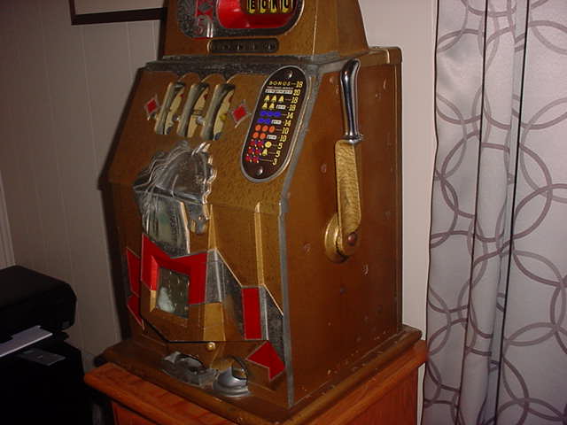

Trying to find the best hammertone finish with new paint. The paint I have seen for sale looks nothing like the 30's and 40's paints. Anyone know where to get these? Thanks. I am restoring a Mills Bonus horsehead with gold hammertone.

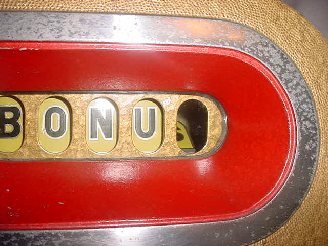

Not to make matters worse on the restoration of the Horsehead Bonus...I have an original unrestored 5-cent bonus and it looks like Mills even used a hammer finish on the red area around the bonus feature and the lower casting details. Deep gold hammer on the cabinet, back door, back bonnet, handle bottom, and on the top and bottom castings!
