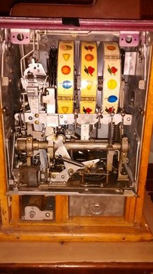

I recently purchased a '38 Mills Melon Bell slot machine.
The reel strips appeared to be pieced together, so I ordered a set from Rick Frink.
When I disassembled the machine, I found out that the reel disks are not original to the mech.
The #1 reel disk has a gold award notch. and several symbols have been pieced onto the reel strip.
The #2 reel disk appears to be correct.
The #3 reel disk is not correct, and has a Melon glued over a gold award symbol.
My question is are the Melon reel disks common to any other Mills machine or are they special made for the Melon Bell?
Would anyone have a set of original reel disks that would be available to correct this otherwise factory machine with original paint?
Any help would be greatly appreciated.
Thanks!
Bob

Postby JHSS-1944 » Sat Jan 07, 2017 2:30 am
I'm not for sure which type of discs typically went with that machine. might be basic , might not.
When someone comes up with the answer, I'll go through my boxes of parts, I have 4 or 5 sets of discs. most look used but,1 set never used. not sure how much of a pain in the butt it is to switch the 3 discs out.
can you read the codes on the discs you have now ? Actually the disc codes & the codes on the reel strips should match up also , any clue what's on the ones coming to you ??

Re: '38 Mills Melon Bell Reel Disks
Postby bkrsdoz » Sun Jan 08, 2017 9:08 am
Dave,
This one has a slotted disk on #1. Nothing matches, I'll have to piece it together.

#2 is the correct CC-424 Melon Bell disk.
#3 original marked CC-424-3A 6-41 (is a CC-209 with a Melon instead of a Gold award about 1/2 way down Bernie Berton Catalogue)
I am looking for a set of replacement strips.

Postby JHSS-1944 » Sun Jan 08, 2017 8:51 pm
Bob; So the plan is to piece together a set of reel strips & no need for new discs.... correct ?

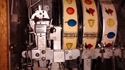

Postby oldslotman » Sun Jan 08, 2017 9:13 pm
Has the reel disc been modified in any way, likes some plugs on it? Some times the reel disc have been plugged to change the payout to a lower percentage.
Postby JHSS-1944 » Sun Jan 08, 2017 9:34 pm
Holes plugged & other holes added is possible too. Specially if it was used at Diamond Jims in down town L.V.

Postby bkrsdoz » Mon Jan 09, 2017 5:35 am
I have decided to look for an original set of '38 Melon Bell reels/disks as a bundle.
It would have the CC-424 strip set on it.
That way it would correct as it left the factory.
If anyone knows of an original configuration set, please let me know.
Thanks,
Bob
