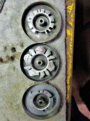

Here are the reels from my five cent machine with one at the bottom and three at the top. You can see that the 1 and 3 reels are different from the 1 and 3 on my one cent machine in the post below. The fact that daval made a few different reel configurations for these machines can make it difficult to line up the strips, especially if you don't have a good machine or example to look off of.

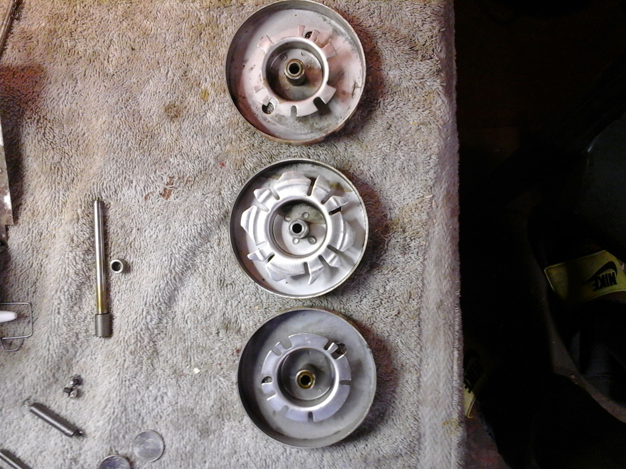

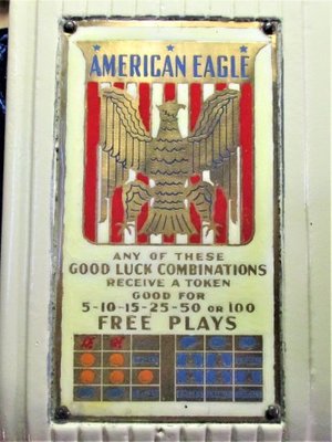

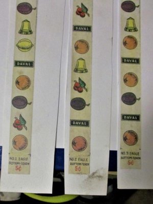

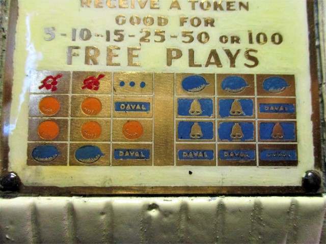

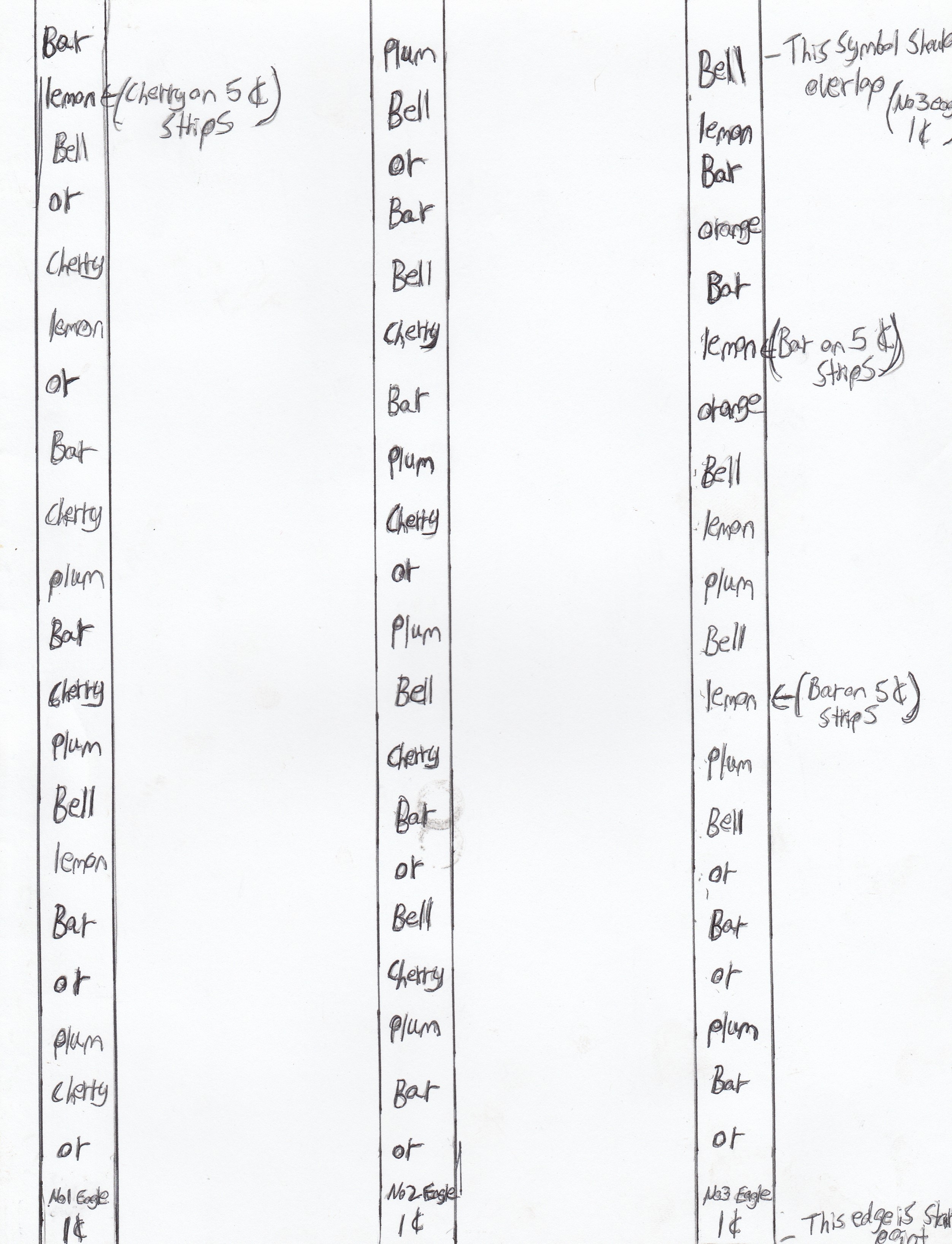

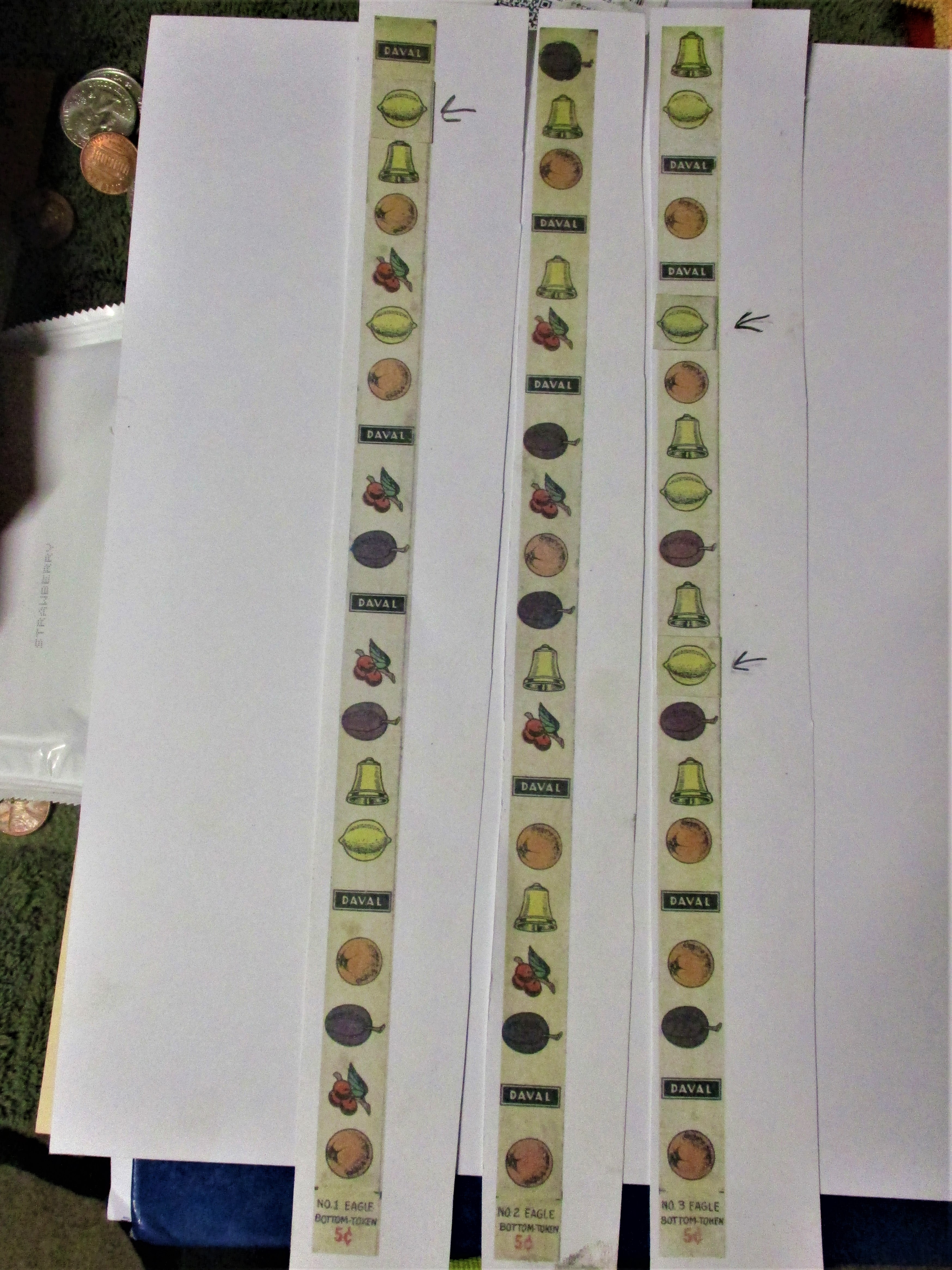

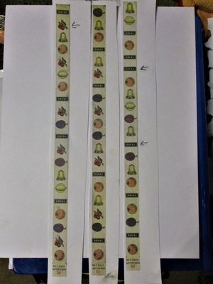

Here are the photos of the reels out of my 1 cent american eagle. The main difference between the one cent and five cent strips is that the one cent strips have three additional lemons. Unfortunately, Slot Dynasty (The main supplier of high quality repro reel strips copied from originals) only has the strips for the five cent model, so I ordered those and made several photocopies on appropriate paper, then cut out three lemon patches and glued them on over the symbols to make the strips work for my one cent machine. In the photos, I show the photo copies I made with and without the lemons placed over them. I also included pics. of the award card on my machine as you will have to verify that it matches the one on your machine, as I have been told there were a few different variations. I also scanned a handwritten document which shows the proper symbol layout for most one cent machines.

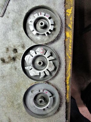

As for the photos of the reels, one is at the bottom and three is at the top in the photos, I used a red sharpie to indicate where the strips start on the reels and a small arrow to indicate the orientation. I hope this information assists you in getting your machine back in action!

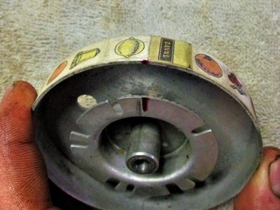

Postby goodolddays » Sat Feb 17, 2018 10:59 pm
Here is another pic of the number 1 reel to show how my marks line up with where the strip starts and how the strip overlaps about 1/2'" when installed. You can see one of my lemon patches in the photo, (between the bar and bell symbols) and if done right they are hardly noticeable as on this reel.
I also want to warn you to remove the payout finger assembly carefully before attempting to remove the reel bundle as that part can easily be bent on these machine and it can be difficult to get back into adjustment. So, I always remove it first and install it last. You just pull the small retainer, remove the pin, and gently separate the reels with your fingers until the finger assembly can be maneuvered in or out of the reel bundle.
