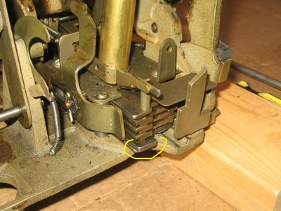

(2) See foto. The payout slides move forward and back as they should as the machine
cycles, but the bottom slide sticks out more than the others:
. . . any ideas?

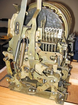

Postby edgeCity » Sat Apr 08, 2017 3:35 am
nhsodaman wrote:Take a picture from the other side with the fingers
. . . two fotos from the back side:

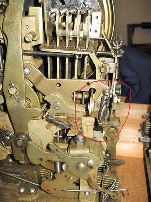

Postby oldslotman » Sat Apr 08, 2017 8:42 am
Move this lever so it points to the back. It is holding back the payout fingers and must be moved.

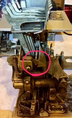

Postby edgeCity » Sat Apr 08, 2017 10:24 am
oldslotman wrote:Move this lever so it points to the back. It is holding back the payout fingers and must be moved.
Is this the lever you're referring to? Moved it back, still no payouts.
To convince myself that there are no coin jams in the payslides themselves, I 'cocked' the mech, manually held back the lowest payslide, and cycled. Two coins dropped (i.e., single cherry)! Then repeated with the lowest two slides, five coins dropped (double cherries). Lowest three slides, ten coins (oranges). Etc. So the payslides aren't jammed, and they are delivering coins.
. . . and thanks, Beads -- it is in great condition! See my post "10c Black Cherry" in Fantastic Finds for details.

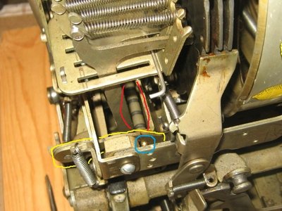

Postby edgeCity » Sat Apr 08, 2017 1:06 pm
Beads wrote:
The attachment FullSizeRender.jpg is no longer available
Yes that is the correct lever, but it has to go back further. The hook maybe locked onto the roller of of the payout push back lever bar.
. . . indeed it (yellow) is -- locked onto the roller tip (blue) with a death grip, I might add! It won't budge.
I have two other (functioning) Mills machines. On one, this level floats freely, never
really making contact with the roller (red). On the other, this level has been removed
entirely!

Re: payout problems
Postby Beads » Sat Apr 08, 2017 4:59 pm
I don't know why by the picture it has a death grip. But if you want your machine to pay it has to be released. Maybe pull back the roller to take some pressure off. If all else fails you can remove it for now like one of your other machines. It is just there to detect a check(coin with a hole in the centre) so the machine does not payout.
As I said before I am totally new to this. Or you could wind the mech up and stop the clock while the 5click lever is holding back the master slide this also should take some pressure off that lever. Time for a real mechanic to step in.
