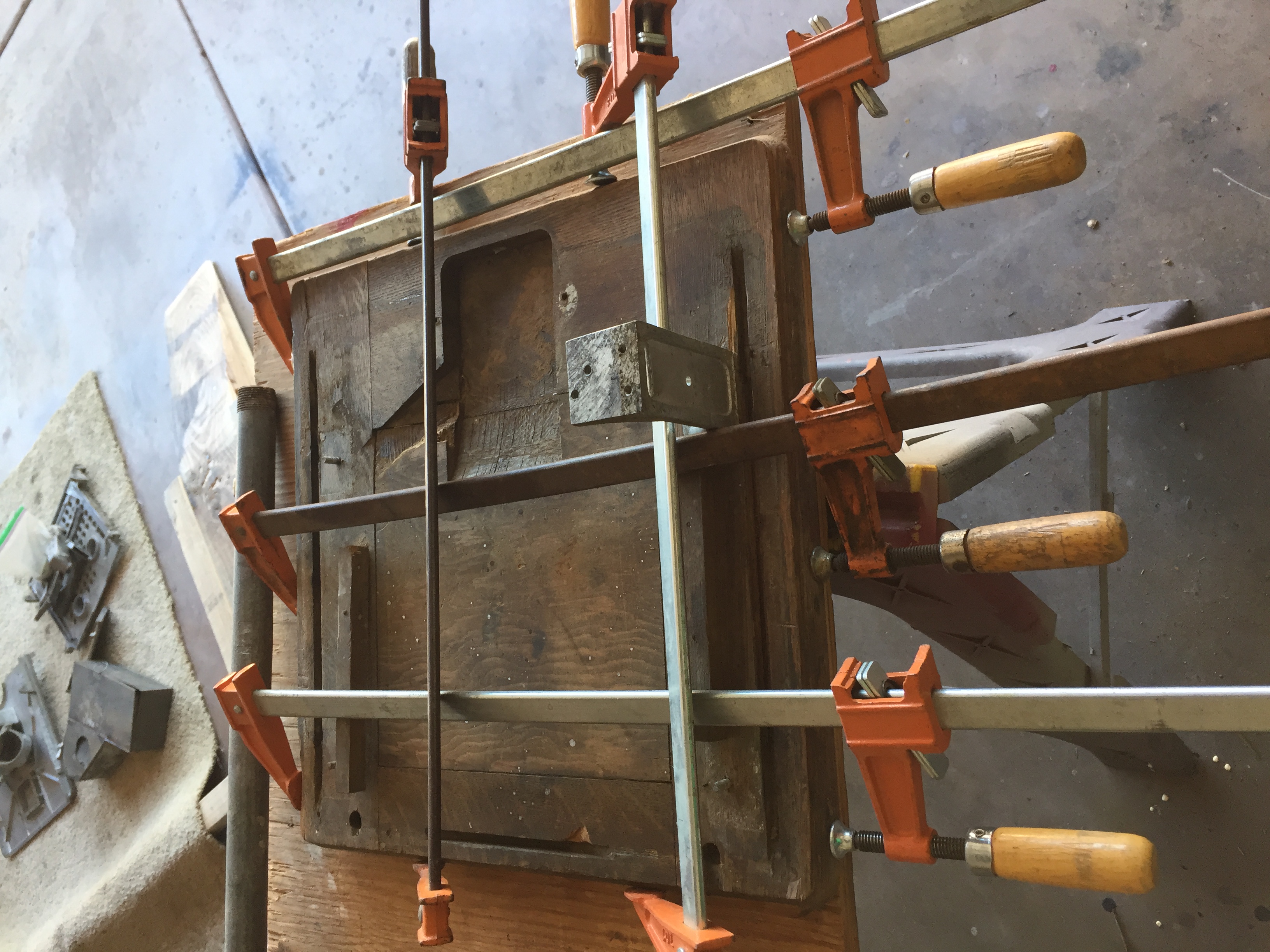

Several months ago I bought a Jennings Peacock and fed ex managed to destroy it and sour me on slots for a while and I focused my energy and funds into a 1965 GTO project and collection. Well I finally found some room in the shop and pulled out the Peacock and tore into it. Every piece of wood had to be taken apart cleaned and re glued.

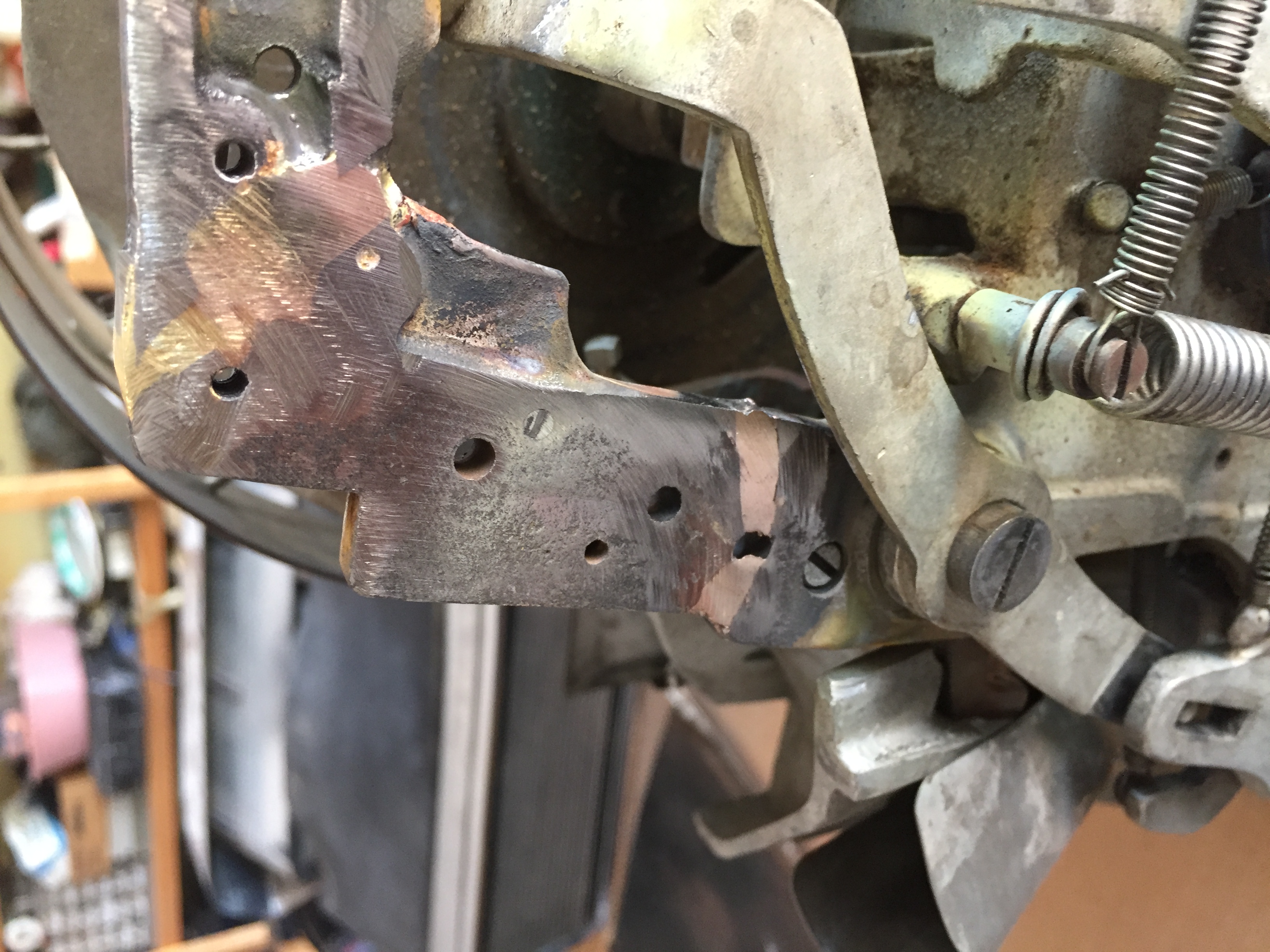

Then the busted frame needed repair, nothing my little Harbor Freight oxy acetelyn torch and some grinding and brazing rods could not handle. Yes I see where I need to drill and put another spring pin in lol.
[attachment=2]IMG_5366.JPG[/attachment]

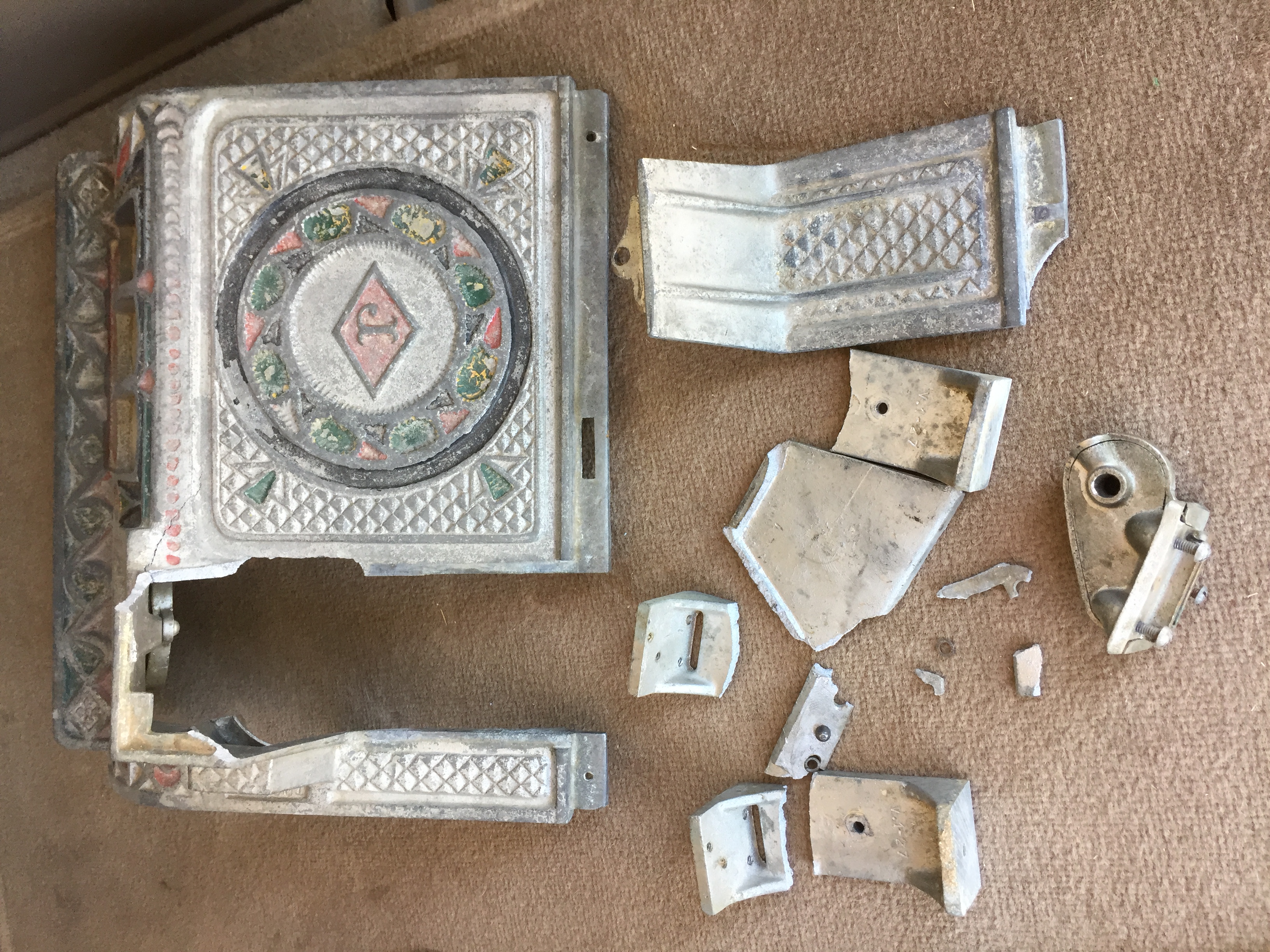

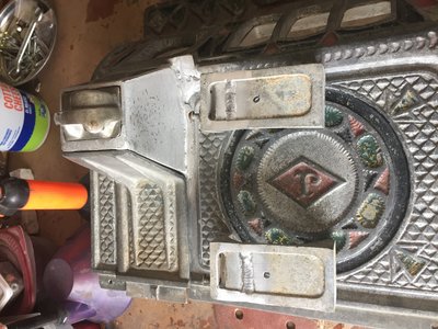

This weekend maybe working on this puzzle and trying to weld aluminum for the first time.
[attachment=0]IMG_5517.JPG[/attachment]

Postby Richard13 » Sun May 07, 2017 2:47 pm
Learned how to TIG weld last night practicing on broken lawnmower parts and pots and pans. After an shout or so of instruction got to work on my busted castings. Needs some more grinding and filing and buffing but not too bad for an old guy learning a new trick.

Postby mechanic » Sun May 07, 2017 7:29 pm
For future reference, when you clamp wood always put a piece of wood between the piece your repairing and the two sides of the clamp. This prevents marring of the surface of the work piece. It looks bad having round circles on the base and sides of the cabinet. Use 1/2" thick blocks about 4" square or whatever you are more comfortable with.
