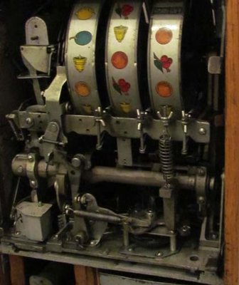

I am new to this forum and thought I had figured out the problem I was having with my mechanism. The reels were not spinning and stopping as designed. I figured out when I cycle the mechanism, and have the fan / governor blocked, if I immediately push up on the operating fork and simultaneously unblock the fan / governor, the reels spin and stop normally.
Also some photos I have come across show a big spring between the operating fork and the area where the wing nuts are between the far right and middle reel (viewed from the back). I do not have any such spring on my machine, although it looks like there is a place for one.
I am attaching photos of the back of my machine (slot1,slot2, slot3) as well as photos of machines with these springs in place.
However, I have now received information stating, "Your slot doesn't need that spring because it has a late model kicker and spring which
replaces the back back spring."

I have seen a few high top machines that do use that spring but not many. The kicker spring on most high tops is located by the springs for the payout slides. It is connected to the same spot as the top spring for the payout slides. It depends on the type of kicker you have in the mech. I do have that spring setup but it will only work if you have the older style kicker. You can see the kicker spring on the newer style kicker. Hope this helps.

I definitely have the newer style kicker and I can see the longer kicker spring is located by the springs on the payout slides in my mechanism. I am not sure what is preventing my machine reels from cycling properly. If you have any further suggestions on what I might try, I would be grateful.

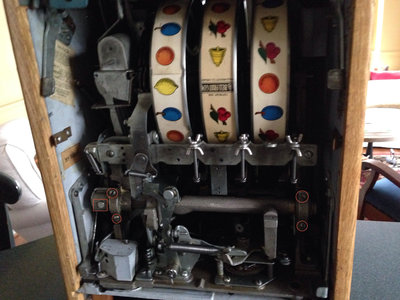

I am attaching a new photo, with the screws circled that I think you are referencing. In addition I put a square around a part which another slot machine enthusiast has suggested making flush with the main operating bar / operating fork to make the reels work properly. Do you have any thoughts about this suggestion?
Also for clarity, the main bar / operating fork does turn when I insert a coin and pull on the handle, the issue arises when the main bar / operating fork does not return to its original position with any ooomph / spring / power. I hope this makes sense.

Yes, those are the four screws that hold the bearing cap. Sound like they are OK.

That other part you have circled could be a problem if the mech is not cycling far enough to engage the kicker. If you move that pin to far the machine will bind up and jam. If you do move that pin do it very little at a time like 1/16 inch.

I added a back shaft spring today and my mechanism is working like a charm :-)
